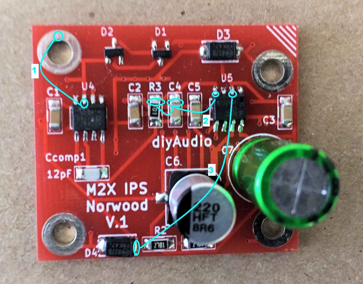

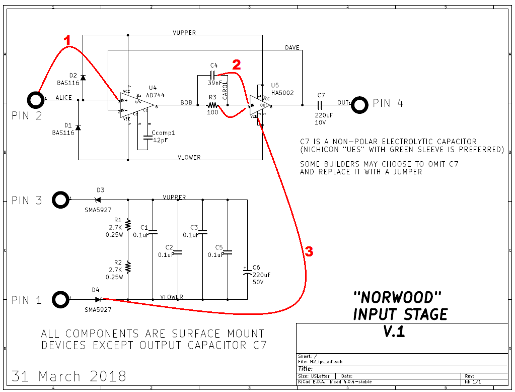

Here are a couple examples of the way I would use a continuity test buzzer to look for open circuits on a surface mount PCB.
1. The schematic says that U4 pin 3 should be connected to the external I/O terminal (bolt hole donut) at top left. So I would touch one buzzer probe to the IC's pin -- NOT the PCB copper trace on the board -- and the other buzzer probe to the I/O donut. If there's no continuity then I've got an open circuit, probably the IC pin is not soldered correctly.
2. The schematic says that C4 , R3 , and U5 pin 4 should be connected together. So I would touch one buzzer probe to the top of C4 itself --- NOT the PCB copper trace on the board --- and the other buzzer probe to the top of R3 itself. If there's no continuity then I've got an open circuit. Then I'd move the second probe to the component lead of U5 pin 4 --- NOT the PCB copper trace on the board --- and check for continuity.
3. The schematic says that U5 pin 2 should be connected to the VLOWER signal trace. The schematic also says that D4 cathode should be connected to the VLOWER signal trace. Thus there should be continuity between U5 pin 2 and D4 cathode. I would touch one buzzer probe to the component lead of U5 pin 2 --- NOT the PCB copper trace on the board --- and the other buzzer probe to the cathode of D4. If there is not continuity then I've got an open circuit.

Thanks for this verbal and images information. In the last couple of days I began examining the schematic to find useful test points for continuity. I have tried to get closeup photo's with my old i5 phone, and they are not good. I am experimenting with soldering smd's and I think I am going to have to reflow some of the resistor's. Will know after continuity checking. All is good, and I will post photo's later. The good thing is, if the smd's do not work out, I can always revert to thru hole components.
