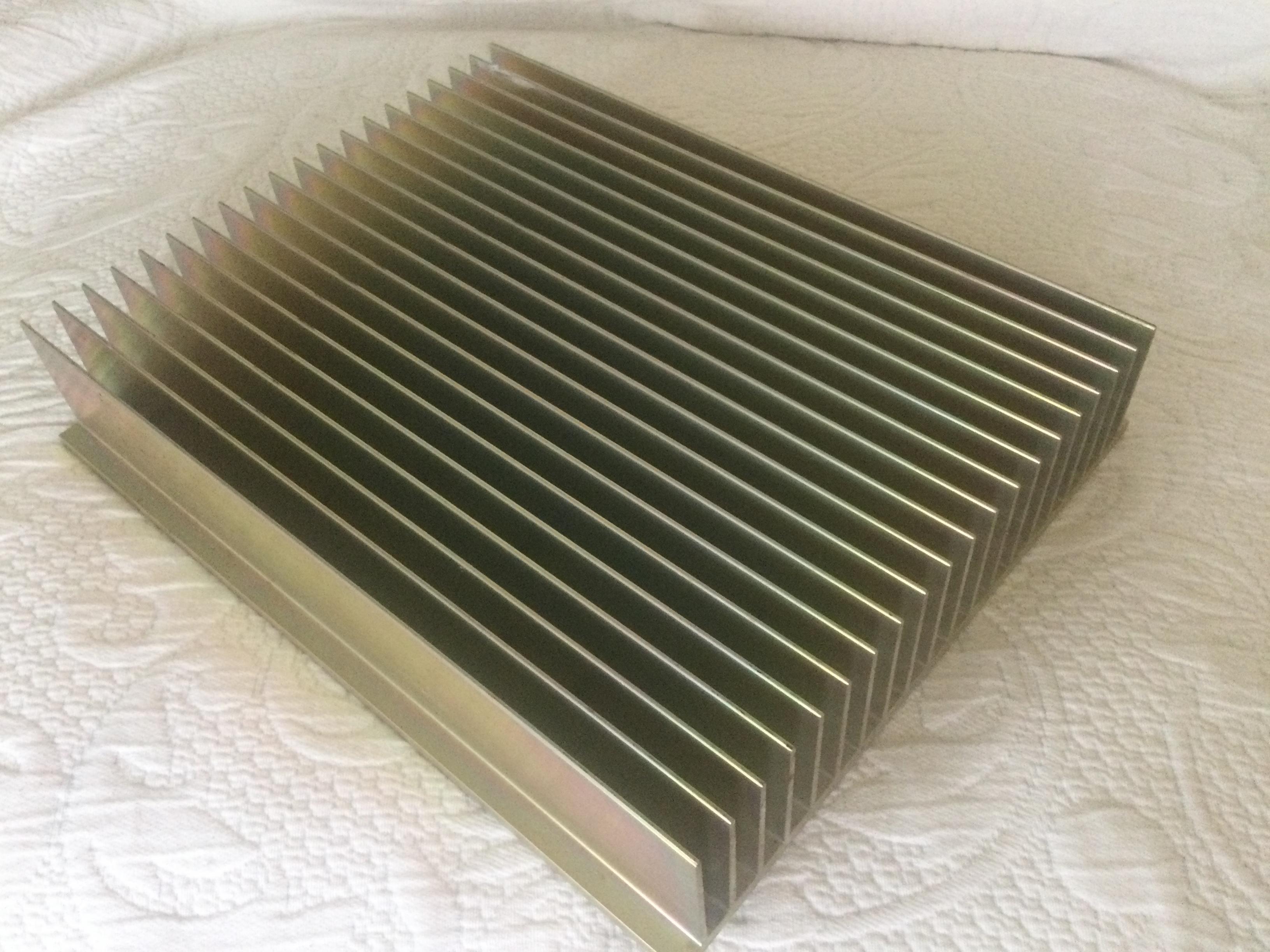

Zman01,
Thanks for your comments and encouragement. I think I do have my chassis sorted out! My Alpha Nirvana will have 12x12 inch heatsinks for sides (I bought these hunks years ago) and finished hardwood front & back (width to suite and with any additional heatsinks and connections). Top would be perforated stainless steel with Noctua fan sucking down (when necessary, controlled by temp) from the bottom. It would be a cube-like stereo amp, probably close to 12x12x12 inches. Sounds OK
FH9 is easier, but similar 12” height heatsink (6” wide) sides and hardwood rest to suite.
Francois G,
Cube like chassis sounds good, and 12" x 12" heatsink should be (more than) adequate for the Alpha Nirvana, even without the fan.
Looks like you are ready for the builds! 🙂
That’s a nice hunk of heatsink! Should be fine, especially with a fan to help out when needed.
