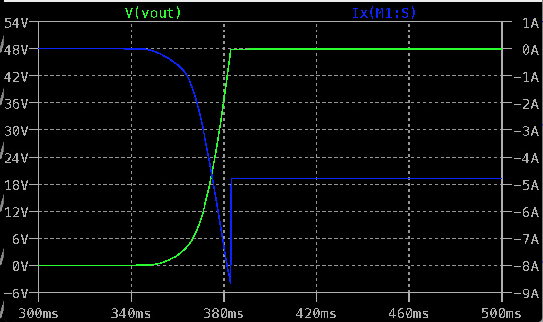

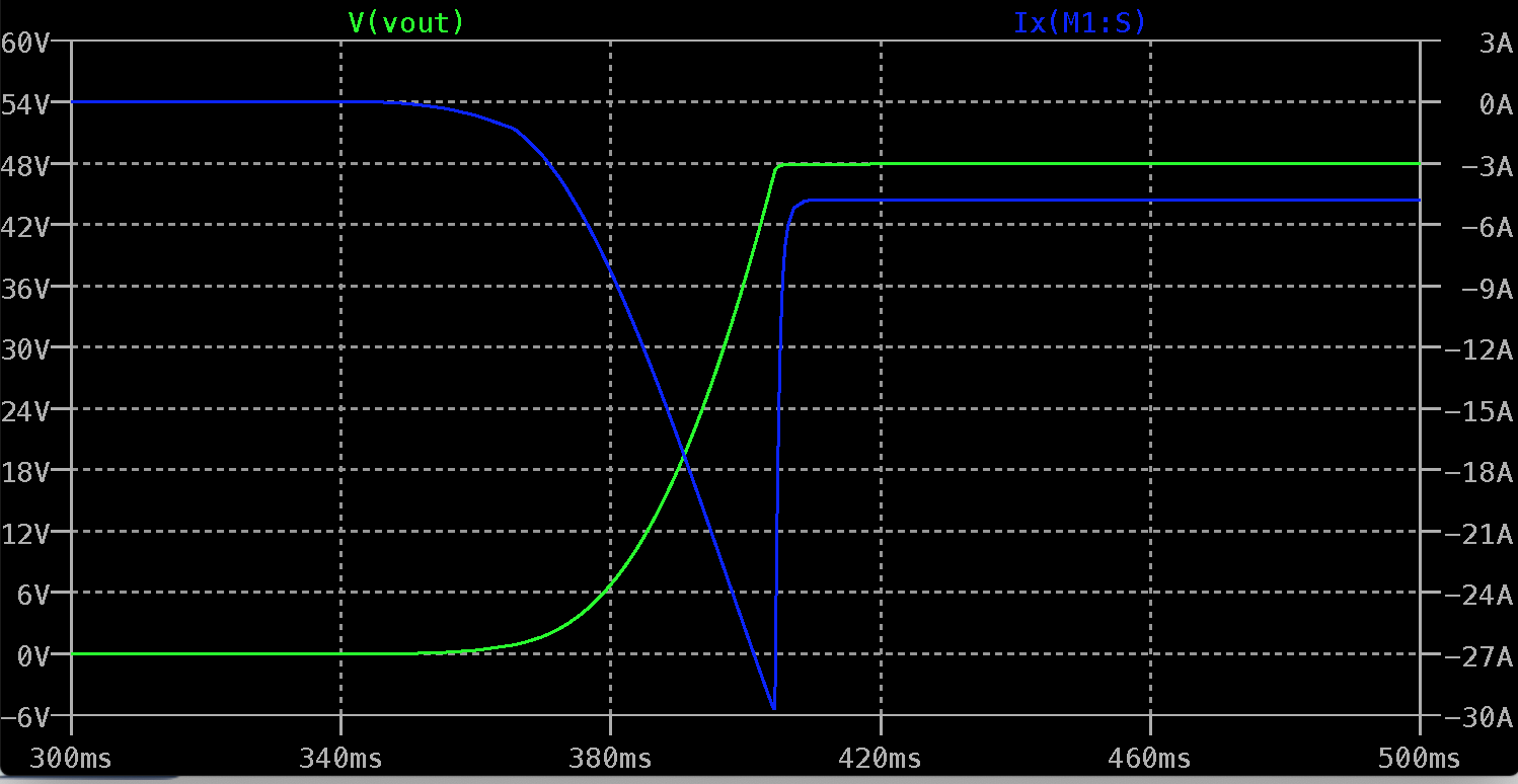

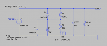

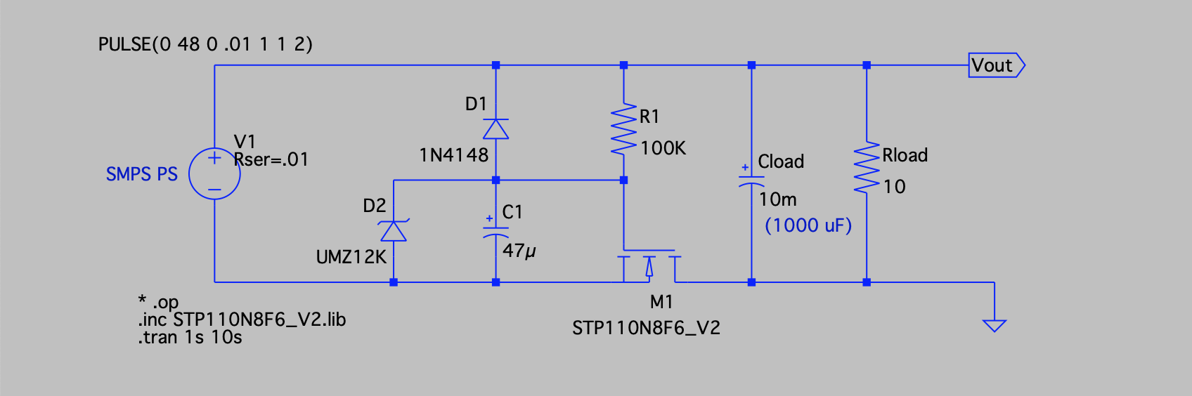

I found a Spice model for the STP110N8F6 and re-ran the simulation. Because of the lower Vgs threshold than my initial MOSFET choice, the time constant has to be longer to keep the inrush to a reasonable level. I am still modeling with a 1,000 uF load capacitance, but changed the supply voltage to 48 V.
Here is a simulation with a 47 uF cap across the gate. The time constant is around 70 mS. The peak current through the MOSFET is 30 Amps under these conditions. Since you mentioned 800 Watt SMPSs, that should not be a problem for them.
Suggest you bench test this and try to capture the transient on a scope to validate the circuit. A current probe would be ideal, or a small resistor (<.1 Ohm) in series with the ground to measure the current.

It is noted that 10mF is 10000uF, not 1000uF. You may also want to incorporate a gate stopper resistor.
Oops - my bad - I changed the annotation but not the value.
Thanks for catching that!
In that case, changing the load cap to actually be 1,000 uF (1m) reduces the MOSFET current to a measly 7 Amps peak. But the simulation still holds up with the larger capacitor value (10,000 uF), so there is plenty of margin for larger decoupling caps.
I was thinking about a gate stopper, but since the gate is connected to the source with a 47 uf cap, is this really needed? I suppose there is a small chance of oscillation in the linear region, but that is a transient condition. In any case, it would not hurt.

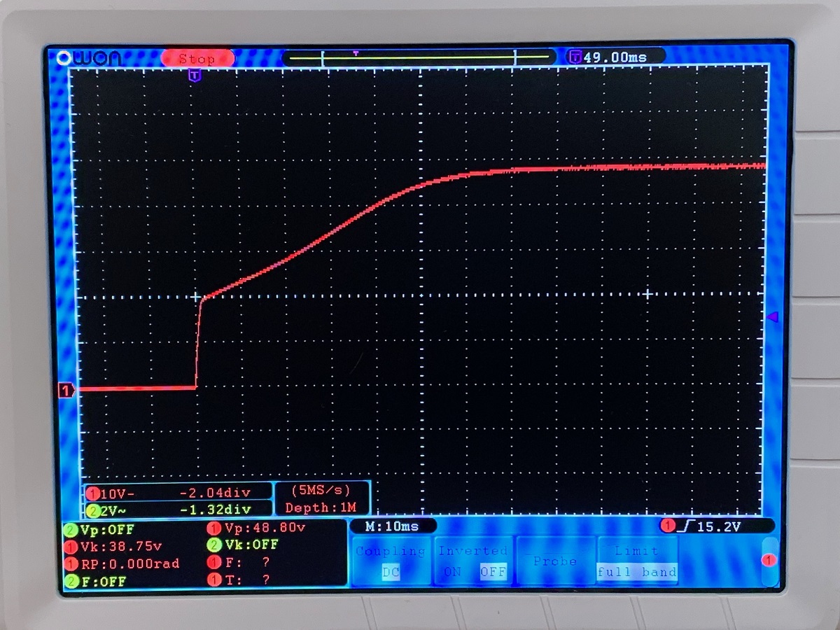

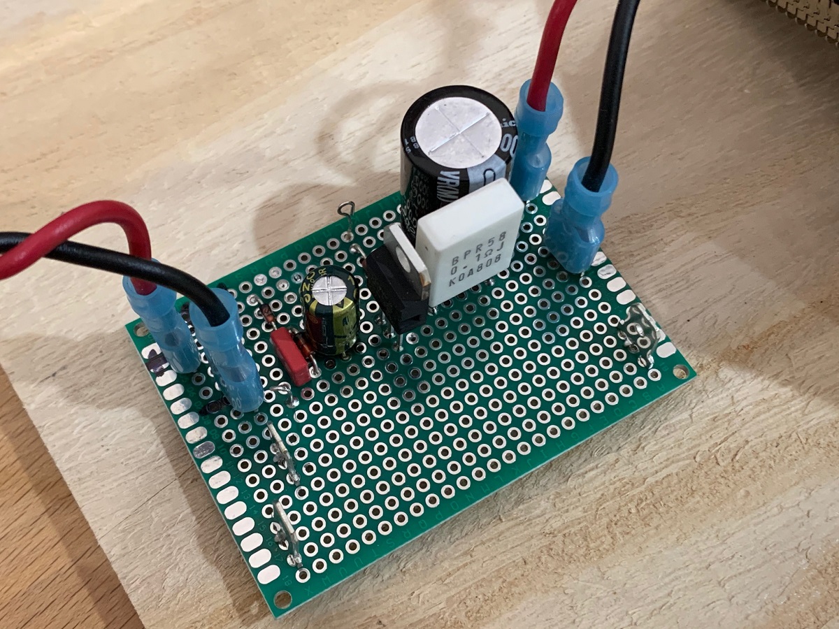

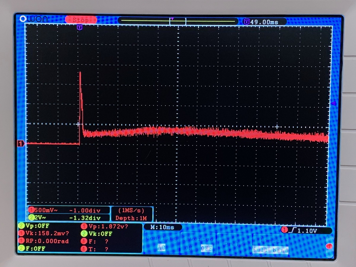

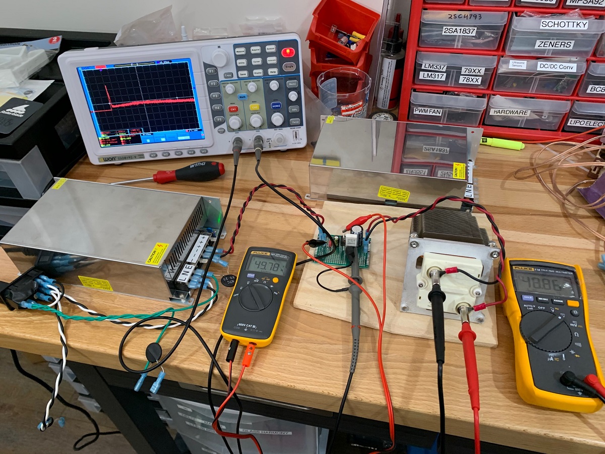

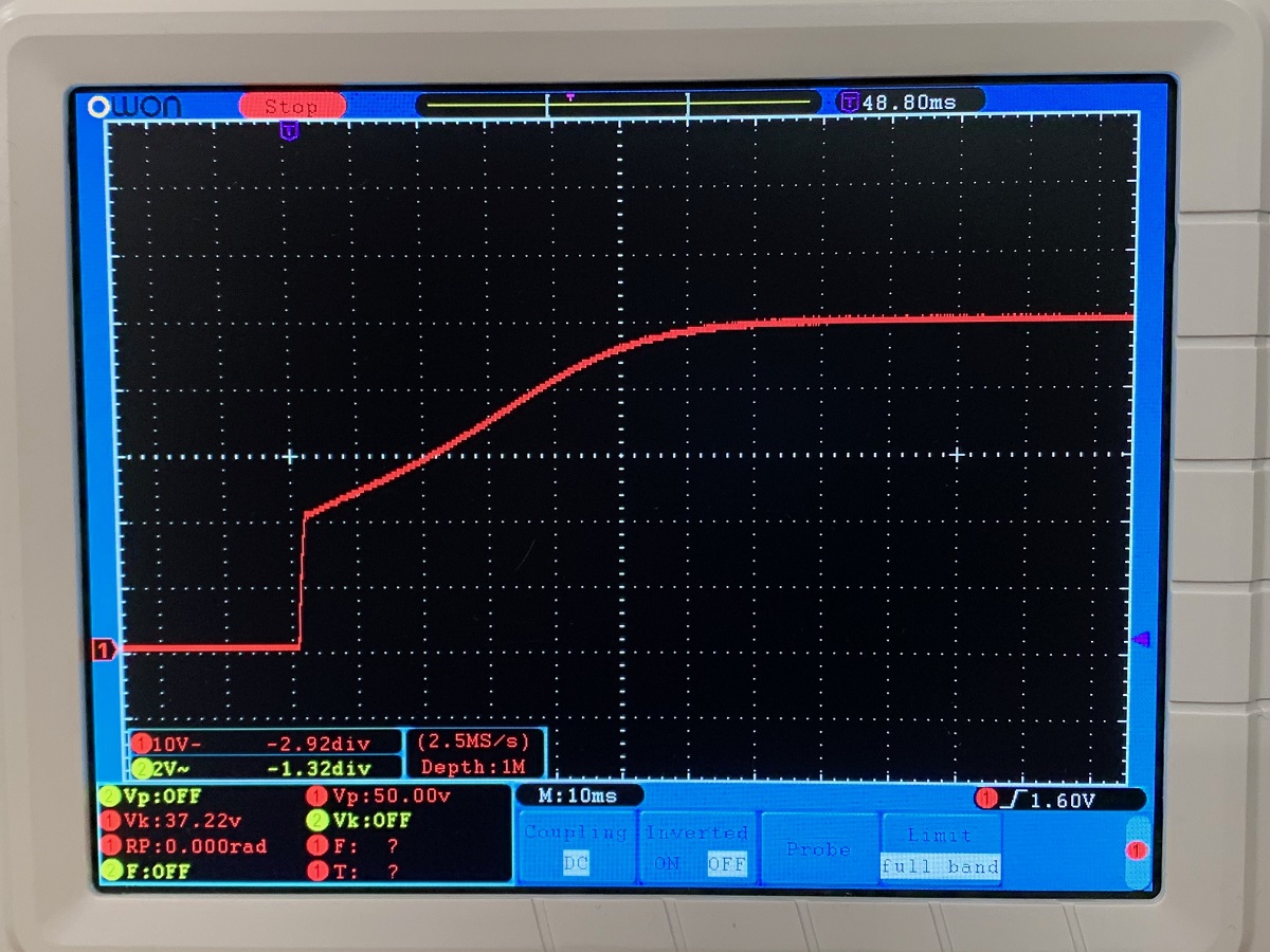

Here are the results of a test of the circuit proposed by Wtnh above. I used a 100uF cap instead of 47uF to give myself an even slower ramp up, I also added a 100nF 100v MKS bypass cap across the 100uF cap on the gate. I put a 0.1ohm 5w KOA BPR current sense resistor between the MOSFET drain and output 1000uF cap (Nichicon 63v). I used an EGB 300w 10ohm resistor with heatsink and the 800w SMPS was set at 49v output. There was 0.32v drop across the MOSFET at steady state (or about 1.5w dissipation - probably can use a small local heatsink). The transient pulses captured on the O-scope shows an initial in-rush spike of 18A and then it settles to the steady state value of 4.8A within 70ms. The voltage trace shows an initial sharp cliff of 20v followed by a gradual rise to the 48.8v steady state value in a little over 70ms. I then tested the SMPS directly connected to the 10ohm load and measured an almost identical voltage rise profile. So I am not sure if this soft start is doing anything to delay the ramp up any more than what the SMPS is already doing by itself?
Setup:
Circuit closeup:
If you noticed, I placed it on half of a veroboard that is all ready for a second rail to be added for a dual rail soft start.
Current (AC coupled voltage across 0.1ohm series R):
Would doubling the 47uF cap to 100uF cause the peak current to be 18A vs 9A as predicted?
Voltage output at load (DC coupled):
10ohm load connected directly to SMPS (no soft start circuit):
So I am not sure what to make of this. Maybe try adding a bigger capacitive load to see if it prevents the SMPS from going into hiccup mode?

Looks like the SMPS already has a soft-start function built-in? If so, then the MOSFET circuit would be somewhat redundant. Is the supply going into stutter mode? Adding load capacitance should make it worse, not better.
