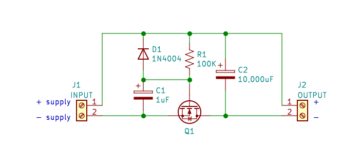

Anyway, I was thinking of something dirt-simple like the attached. The R and C values create a short time constant allowing the MOSFET to gradually ramp down to its lowest Rdson value, thus giving the SMPS time to start up. The MOSFET needs to be a device with very low Rdson, like ~ 1mOhm. The diode discharges the gate cap when the supply is shut down. Probably need a Zener across the gate cap as well to limit the gate voltage.

Looking at the circuit I don't see any current limiting component. So I chose to put the circuit into LTSpice choosing some typical numbers. I chose a supply voltage of 32 volts and a load resistance of 10 ohms. The FET chosen was one of the available devices already in LTSpice, a BSB014N04LX3.
The simulation confirmed my expectations. There's no current flowing from the supply for about 10 milliseconds until Vgs across the FET reaches its threshold value. Then it turns on and sinks current from the load and 10000uF cap and in the span of 2 milliseconds charges the cap to full voltage with a peak current approaching 300A. A typical SMPS won't support peak currents like that. And if you make a first order approximation of (32V/2*(300A/2) power in 2 milliseconds for the energy that must be absorbed by the FET it isn't obvious to me that it would survive.
You would be better off with using a current limiting device such as an NTC or resistor to limit the current and short across it after a suitable time delay. I also would not use a 10000uF cap on the load side of an SMPS.
correction to my post. Peak current in the simulation is a bit over 200A. My conclusions and recommendations stand.
Jhofland, try your #488 suggestion in LTSPICE. When the shortie-outie device (relay contacts) shorts out the resistor/ICL, kaboom! Current drawn from the SMPS goes through the roof: hundreds of amperes again. Even if the cap has been charged up to within 500mV of its final value, dV/dt is big when dt is small (as it is when a relay closes). Thus I = C*dV/dt is enormous. The small dV isn't enough to make the problem go away.
One (expensive) way around the problem is to use MOSFETs with not-so-low Rdson as the shortie-outie devices. You may want two of them in parallel, with different Rdson ratings, switched at different times.
If you switch them when Vds < (SMPS_max_rated_current * Rdson), the SMPS won't go into current limiting or Hiccup mode.

@wtnh:
OK - I did not simulate the circuit and I can see your point - what if the time constant were increased significantly so that the MOSFET was in its linear region for a sufficient length of time to allow the load cap to not incur a huge inrush (low enough not to kill the MOSFET or cause the SMPS to hiccup)?

@wtnh,
rerunning the simulation with 10x time constant does reduce the peak current to around 40A. What helps even more is to reduce the load capacitance by a factor of 10.

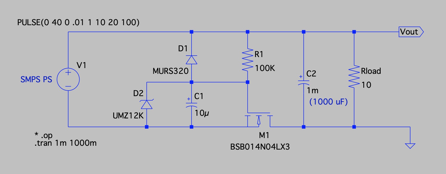

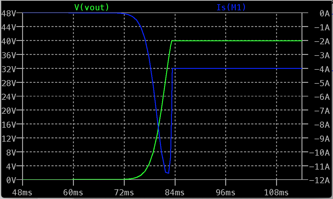

Following @jhofland's lead, I ran an LTspice simulation using the MOSFET he picked, the BSB014N04LX3.
I assumed a 40 Volt SMPS input with a 10ms rise time, a 1000 uf load cap, and a 10 Ohm resistive load.
The output voltage increases smoothly over a period of about 8 ms. The current through the MOSFET increases smoothly over the same period to a peak of about 11.5 Amps and then settles quickly to a steady-state load current of 4 Amps.
So I think this simple circuit has value for the use case we have been discussing and I may make up a circuit board for a SMPS-powered FH9HVX amp.
Feel free to play around with the .asc file and the conditions I picked.

Yes - the output capacitor and the load resistor are only there for simulation; they would be omitted in an actual application.
You would need 2 of these, one for each supply if I understand your hookup correctly. I am assuming the supply outputs are floating (which allows you to ground either the + or - lead to the amp ground in your current configuration). Since the MOSFET limiter is essentially floating also (and can be considered a 4 terminal "black box"), it really does not care where the ground reference is. In other words, you could ground the positive output lead (marked Vout) and use the node marked with the ground symbol for the negative supply rail.
So you would create the series and ground connections AFTER the limiters, letting the SMPS outputs float. If that's not clear, I'll try an actual schematic.
Chassis grounds would need to be connected to the IEC safety ground for sure. Also, the usual chassis safety ground to amp power ground lifter would be appropriate.
You will need a beefier N-channel MOSFET than the one I show for your 48 Volt supplies. I believe the one I simulated is only rated to 40 Volts. Let me know what you have laying around and I'll see if there is a model available for it. The main parameters of concern after max Vds are high current capability and very low Rdson.
I don't think the diode is critical - LTspice shows very little current flow through it so a 1N4148 should be fine. It just needs have a peak reverse voltage greater than the supply. Also, the Zener could be any old 12 Volt device. It just clamps the gate to a safe value.
