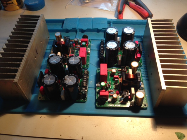

Received replacements mosfets from arrow today (mouser/digikey are all out of stock, heads up people), I have maybe an hour of spare time for the next week so wont be until next weekend until I have something playing. My CNC guy is wrapping up cabinet parts and I can have them built for around next weekend too, so that's exciting.
Progress pics

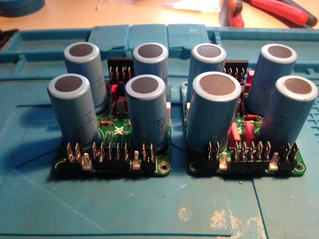

Zman01 et al,
Please see the attached pics of FH9HV & All Cees. I also posted the All Cees to be used with the Xmas amp.
The layout with the FH9 and All Cees diagonal to each other is OK ?.
Transformers will be on one side or possibly on an upper level ( I have an old humidor with 2 levels and plexiglass that I might try). SSR's may be between the two rows of amp & PS.
Waiting on hardware and starting to build various cables. Fun times😀

That looks very neat and tidy, Myles. Nice work!
Diagonal placement is very pleasing to the eye.
