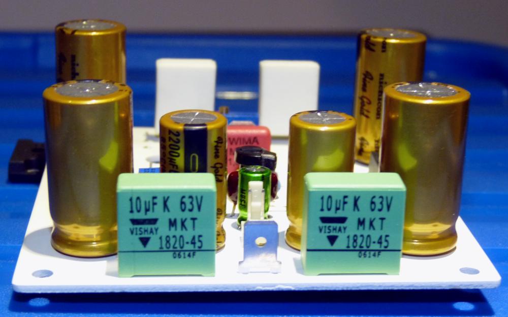

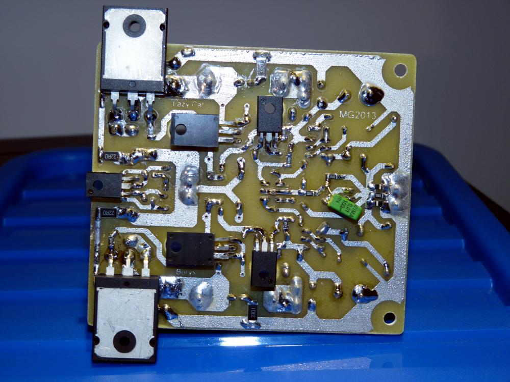

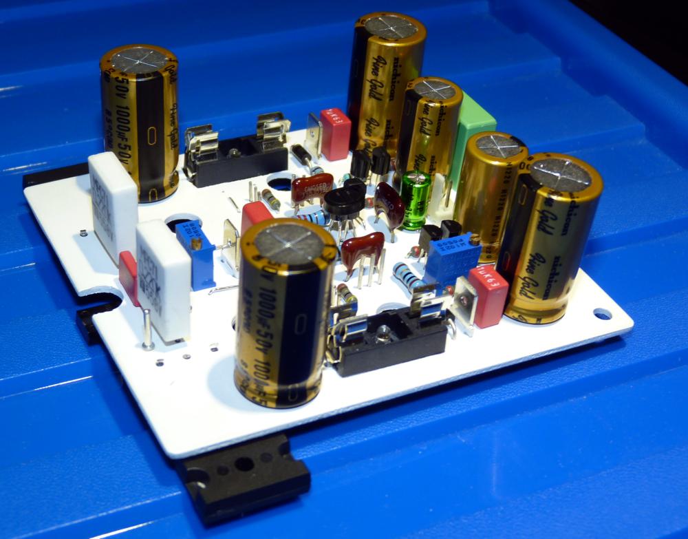

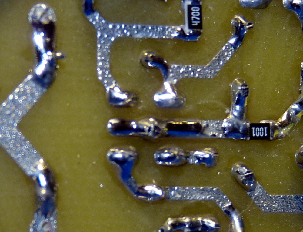

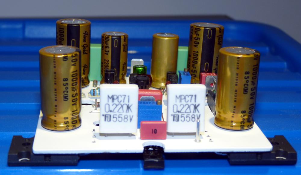

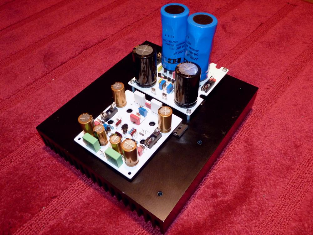

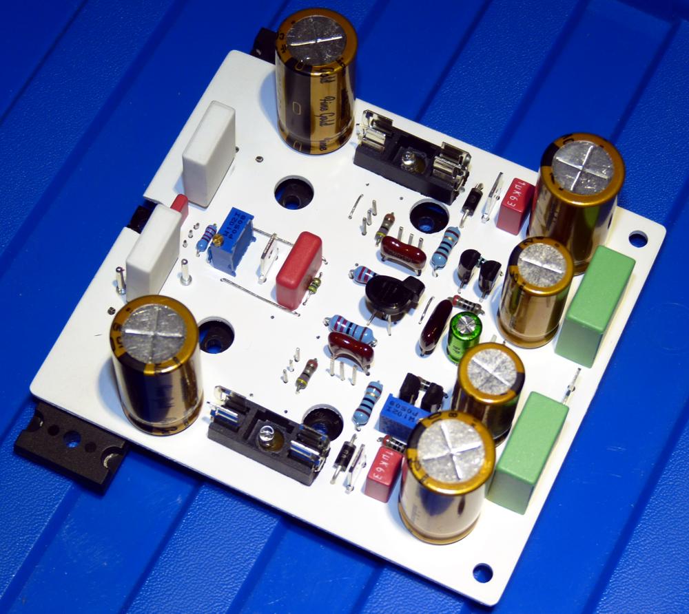

First VERSATIL 50 Board completed...some pictures for whose is interest. The last one is specially for BYRTT : the bases from BC550C/BC560C are soldered together in the same hole so the two transistors are feeded ant same time..😉😉😉
I change the input cap (4.7uf wima MKS2) for a Nichicon Muse BP 10µ/35v with a wima MKP 0.01uF.
Marc

Hi MARC
Great great handwork, and very nice looking, congratulations.
Cool my name gets in there, but i hope and think because you do that little layout trick, that you believe in it too.
Must say in next post 495 the last Picture gets me envious, but you deserve it by your crafts and hard Work.
When you later get to listening trials have in mind your new input capacitors, they are very audible (Maybe try same in your now running BG1-BJT so you know the color of it).
Best regards Ricky
Marc those PC boards design and quality just awesome!🙂 especially known is all hand crafted😀😀
Congrat..

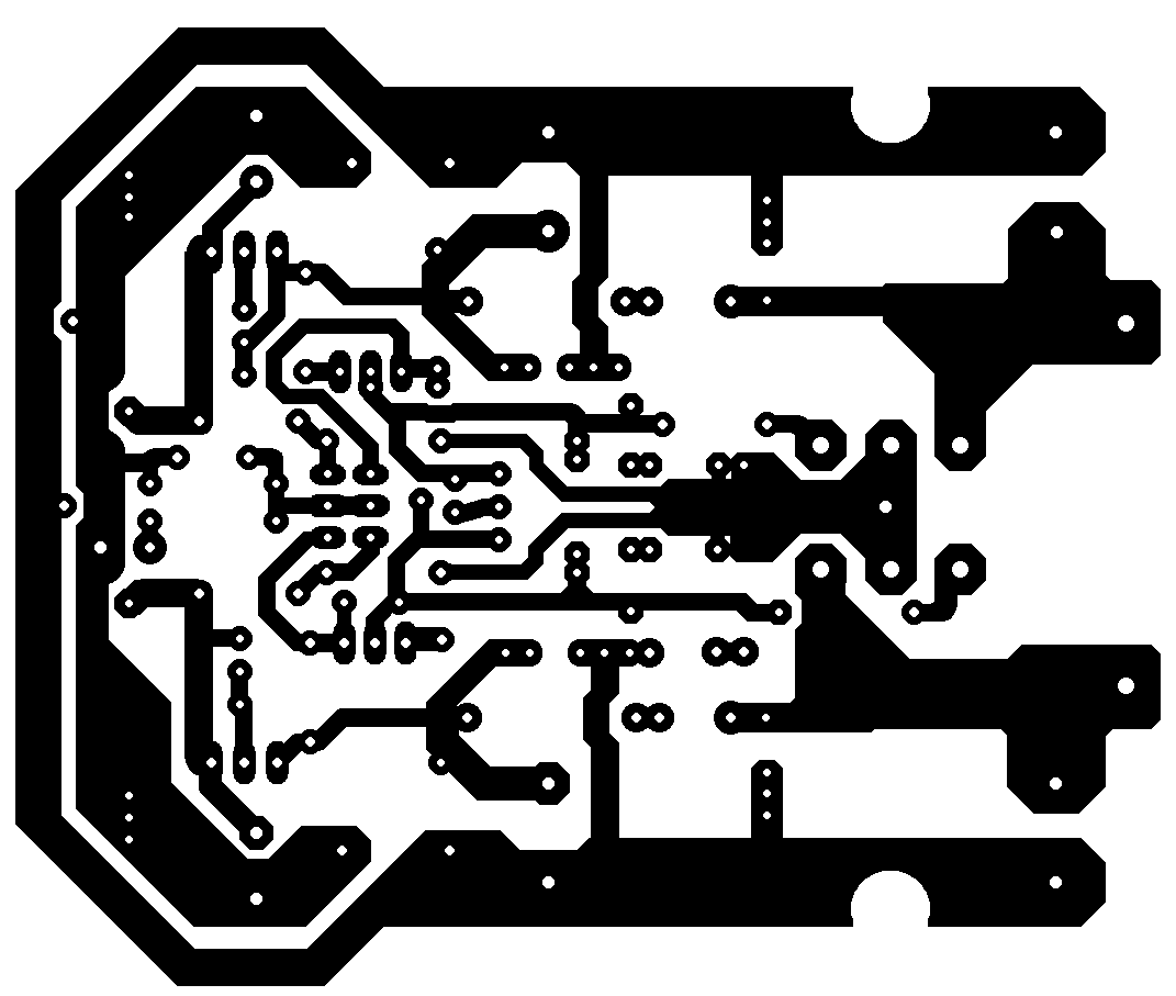

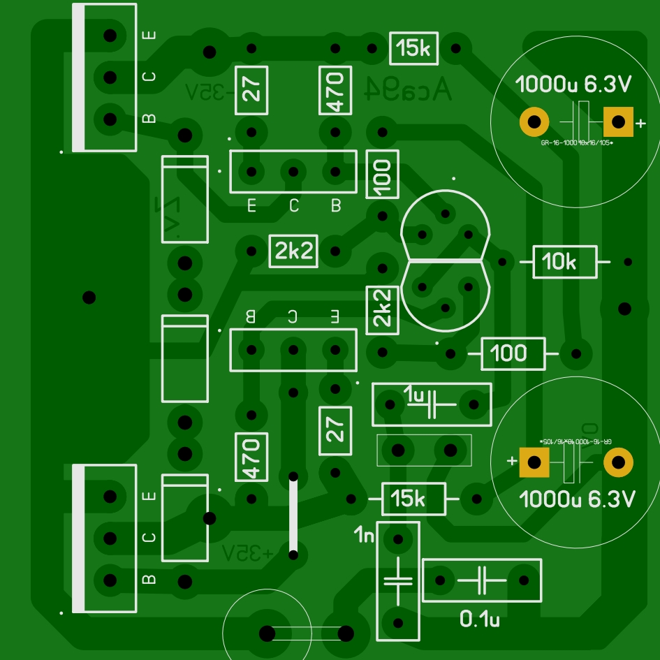

Today I made the layout for the LatFet version, I have some high power dual diy EXICON and Class D mosfets, I would like to test those to.
I do have a 39-0-39V 600VA transformer for that project.
If your Capmu. work with these topology well I will use that to get some voltage drop for the one pair LatFet.
To replace the BC550/560 high Hfe BJT I still need to look around on the market and also the JFet has to be replaced by BJT.
So the lay out still need some adjustment, not 100% ready.
I separated the SGR from the main GR.
I took some of your idea for the layout, it helped alot - thank you!
Soon I'll start to make the PC boards so I can test all 4 VERSION 😱
Power BJT
Toshiba
LatFet
Darlington
Greetings Gabor

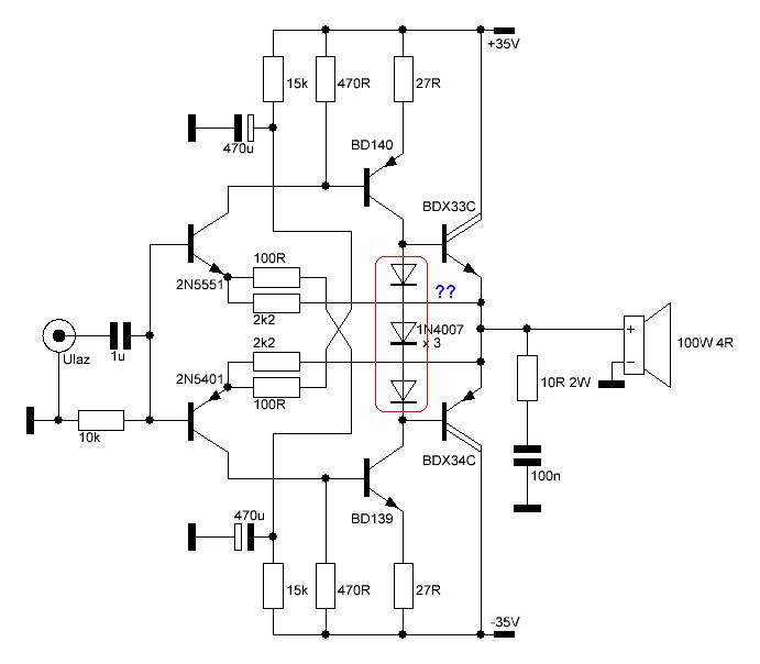

I think you can use them but you have to redisgn Board for TO3 output package.
Marc
Thank you for your reply mr Idefixes!
Hi Acca,
Acca provided can be replaced 3 diodes (1N4007) for bias with the transistor BD139.
What changes to the schematics following? (see schematics)
Thanks for your help!
Acca's circuit is a class B amp. So the output stage is still in cut off mode. Adding a BD139 bias spreader will be required only if you want to run it in class AB mode. Then you will also have to deal with bias stability issues.
Acca's circuit is stripped down to a bare minimum and if that sounds good enough, then it's a great find. Has no adjustments and seems to be stable without additional components. This might be device specific I guess. So better use the circuit with parts as shown.
If you really want the bias spreader you could remove the diode string and put in the attached circuit.
