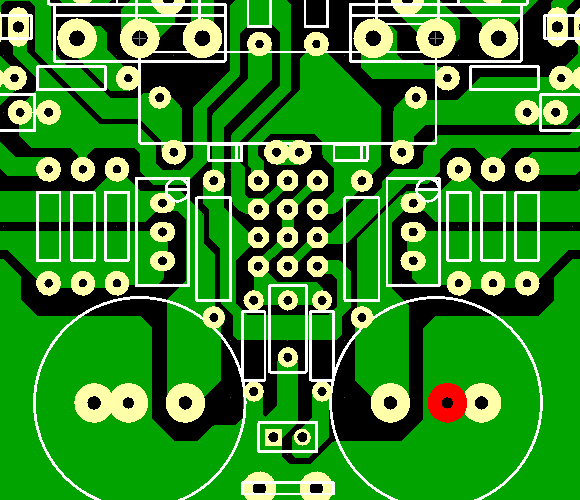

Here VERSATIL 100 : 2 output pair devices and more than +/-45Vdc rail with BC556C/BC546C as input pair. Board size 125x88mm

Here it's. Please check one more time schematic and layout according post#436
Marc
versatile 100
Thanks for instant reply!
Did you mean that is untested pcb?Here it's. Please check one more time schematic and layout according post#436

I build the BG1 version that is the same schematique. I work with eagle when you draw a schematic under eagle you have a consistant layout. As versatil is direct coming from BG1 file by "saving as" there souldn't be an issus but checking again don't hurt and is a good exercise to learn and locate parts/area on PCb board.

I attach layout that can use 2SA/SC also BC550C/560C, one layout for all.
See 12 pads on the center
E C B
C B E
E B C
B C E

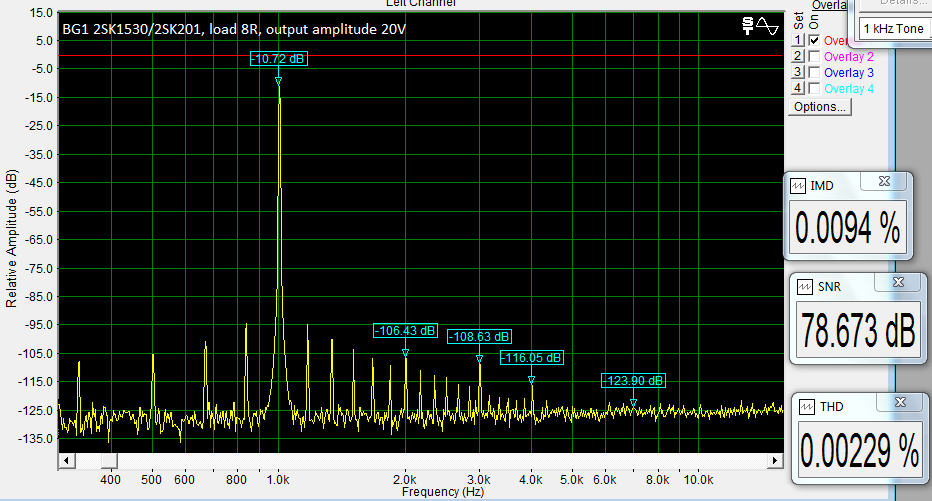

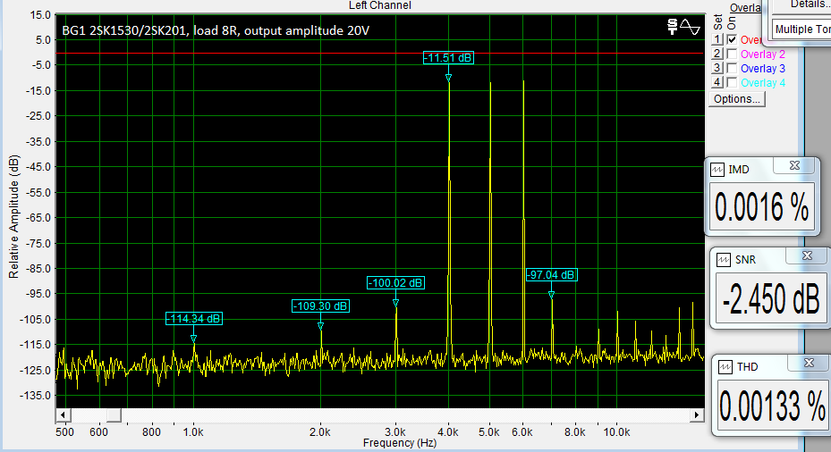

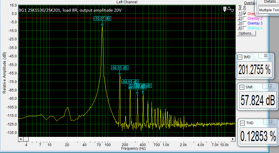

Shaan
I think you are right with that harmonics spectrum. I have just mesured bg1 with toshiba mosfets and in fact the amp sounds more warm to the other amps I have with different harmonics spectrum (the difference is very very small but noticable). The feedback network is 100/2,2k in both rail sides.
BTW I have changed the sound card.
bg1

I am using e-mu 0204 at the moment, but it can be any sound card (integrated in laptop too), have to work in full-duplex mode (99% of them is working ok).
Load is let me say 8R so just put additional 2 resistors to divide voltage going to sound card (or use potentiometer), put the signal back to the line-in. Spectralab is what you looking for. You can use arta, rmaa software too.

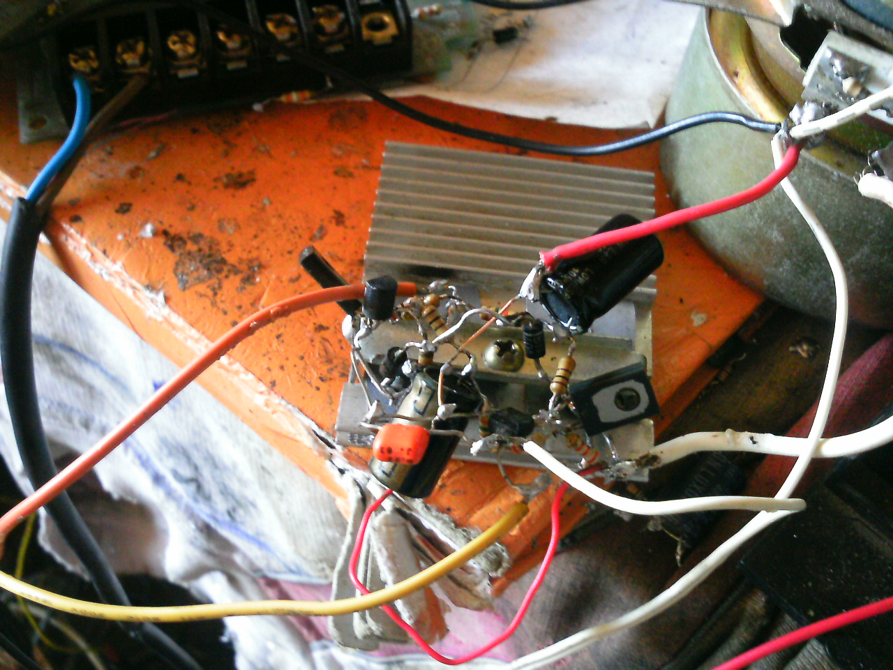

Darlington VSSA
Theres my Darlington VSSA Amp.
This small sh*t push out 100W on 4 ohm (not with this heatsink) 😱
Sound great.Better than voltage feedback amp.I tried it with SMPS and works very good.Even with different output transistors,ofset is small.Amp works from first try 😉
Voltage +/-35V.I listen it all day,I like his sound.Thank you for this simple but powerfull schematic.I make PCB soon.I put one module in car,with smps to😵utput biased in class B but sound great 😱.
Some pictures of my 3D prototype:
