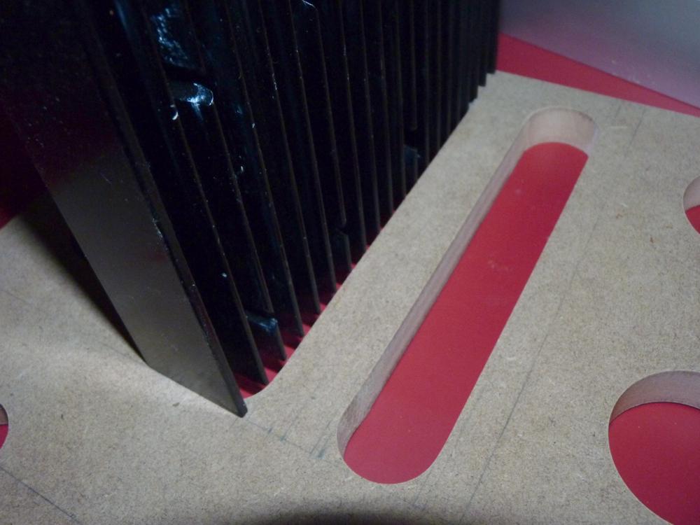

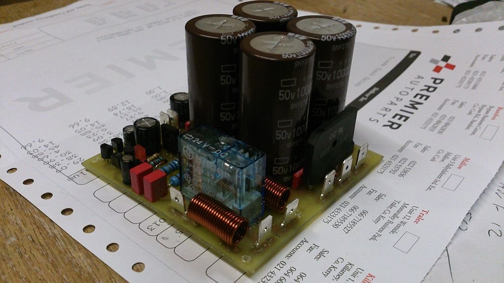

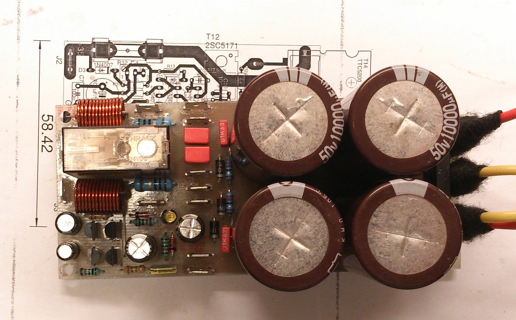

Today, i finished the cutting and routing job except top cover (i need to buy one more MDF pieces) on Versatil enclosure. The front compartiment will hold the 2 trafo and soft-start. I routelarge hole in the bottom plate to have good air circulation on heatsink.
Next step will be some gluing and than two layer epoxy resin and go for glossy black finish.

Why thers no holes between radiators on the bottom? Air must flow through them.

Idefixes
Look better to pictures there hole that cover whole heatsink fines ...

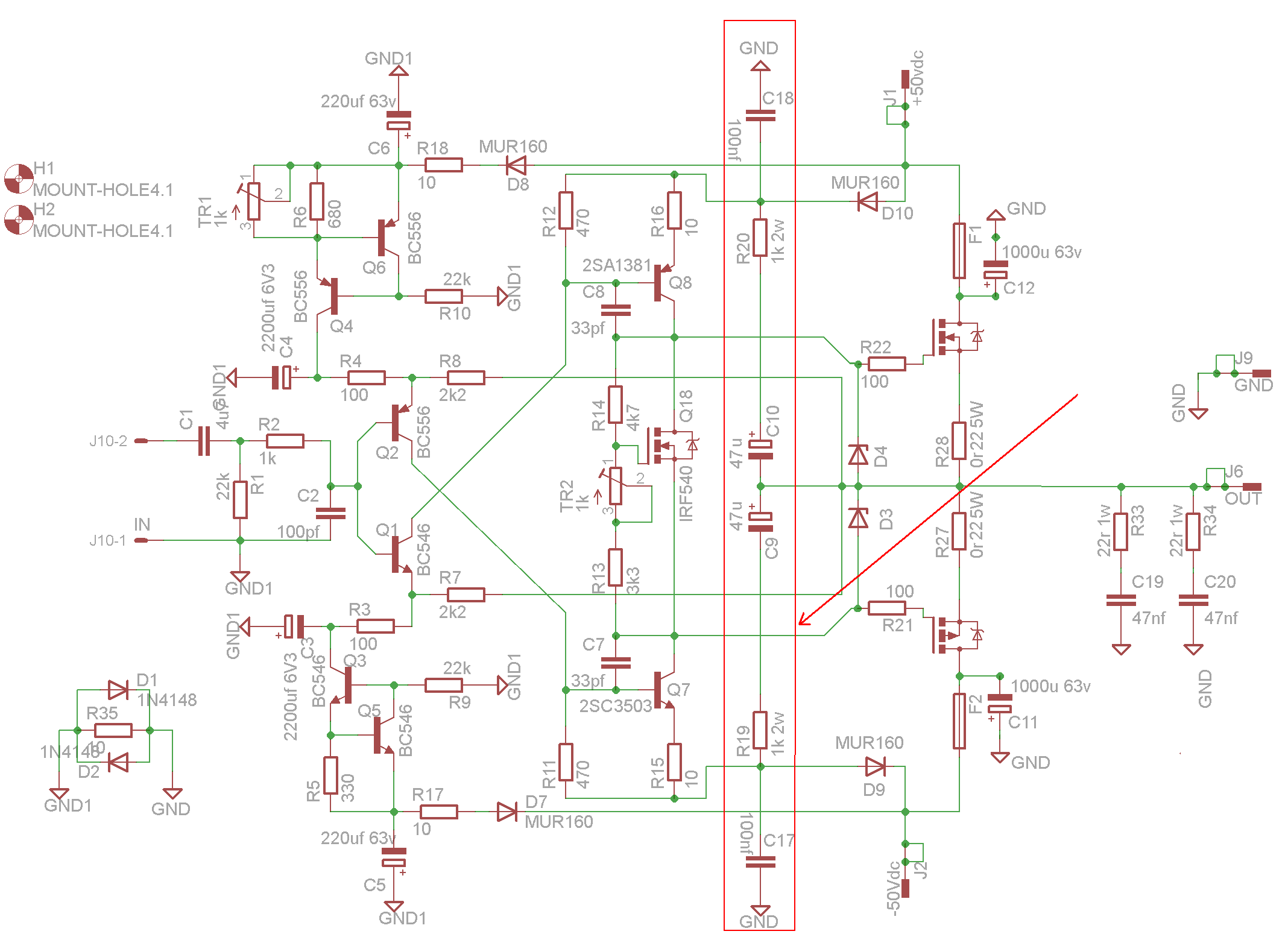

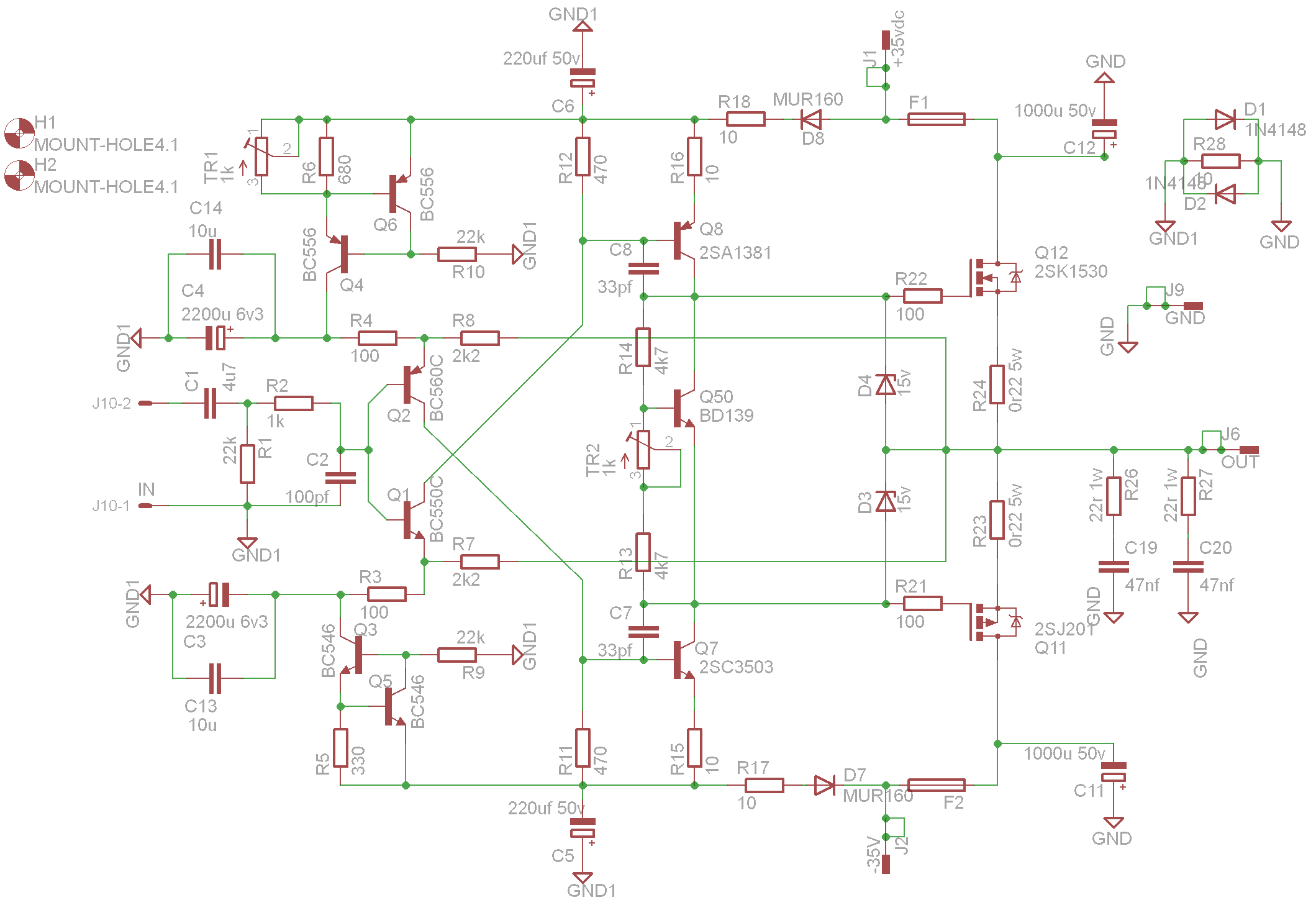

I have one more question to you Borys before I produce my PC boards.
Would you be so kind please take a look at these two circuit and please let me know which one would you use with Toshiba 2SK1531 & 2SJ200 mosfet.
The main difference between the two schematics the parts in the red plus one has BJT heat sensor the other mosfet.
Actually I could use the mosfet with both circuit all do I do not have on hand IRF540, but that is not a problem.
I remember you wrote for power mosfet you would use mosfet sensor.
My main question the parts marked with red, I do not understand 100% their function.😱
One more time if you could take a look please and let me know which one would be better or which one would you pick for the power Toshiba so I can go on and produce my PC boards.
Thank you very much🙂
Greetings Gabor
The parts marked with red square is boostrap for vas stage - take a look at this topic at the 1-2 pages there are scope diagrams how it works.
With boostrap output swings nearly rail to rail, with no boostrap output is loosing around 7V each supply rail!
Better of to use first schematic with bjt as temperature sensor, the 2sj/2sk toshiba mosfets would be over compensated around 30% in this case.
So You will have to set the bias at 130mA and after 20min you should get around 100mA. Toshiba mosfets and hexfets have different temperature characteristics.
If you do not need super efficient amp do not have to mount boostrap, get transformer with 2x30V ac and you will have around 80W@8R.

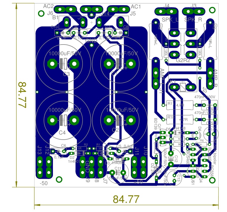

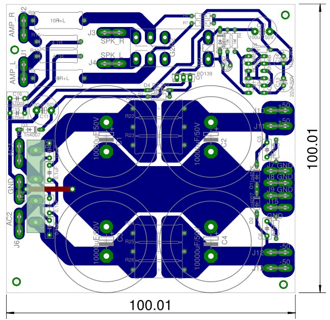

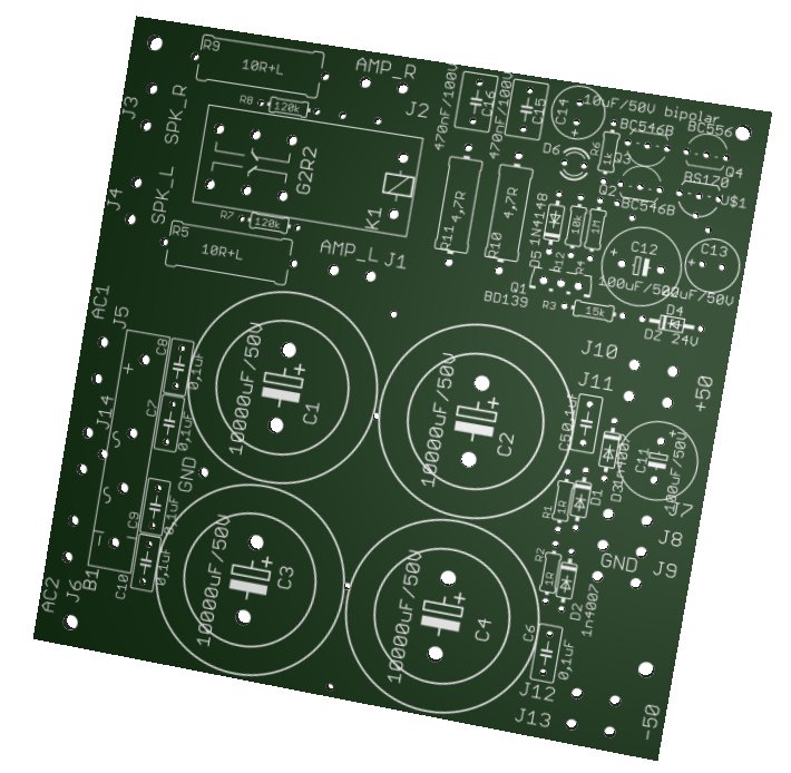

I am using simple psu with: DC protect, speaker ON delay, fast speaker OFF function. If someone will need I will post rest of the files.
There is movie how it works:

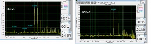

1. Set bias around 10mA per o/p transistor
2. Do listening session - 3-5 songs that you know very well
3. Increase bias up to 100mA per o/p transistor
4. Do listening session - the same 3-5 songs
I found amps with high performance on the ''paper'' very clear, like sound is just going threw them without any modyfication, but character of te charmonics is adding small bit to the output (even if THD measurement is low). I do not know how to explain so I will give an example.
Bellow is BG3 amp with 3 modulated signals, products of the signals are visible on the left and on the right of them.
I just have changed one resistor pair for reducing bias in input diamond stage, resul can be measured and can be heared! (yes I know that it sounds supid cause thd 0.1 - 0.001% doesnt make any difference).
I think no level of distortion but characteristisc of them is creating the amp 'sounding'.
The amp on the left: very soft base, I think is going deeper than it really is, top end very delicate and bitt hidden.
The amp on the right: bass is less deep but bit improved dynamics, there is more top end or looks like the high's are more acurate.
I do not know if it will make any sense but I was listening amp on the left and on the right for whole week and difference between them are only 2 resistors.
So conclusion is: change the bias setting (haracteristics of harmonics will change a bit) and listen to it to compare.
