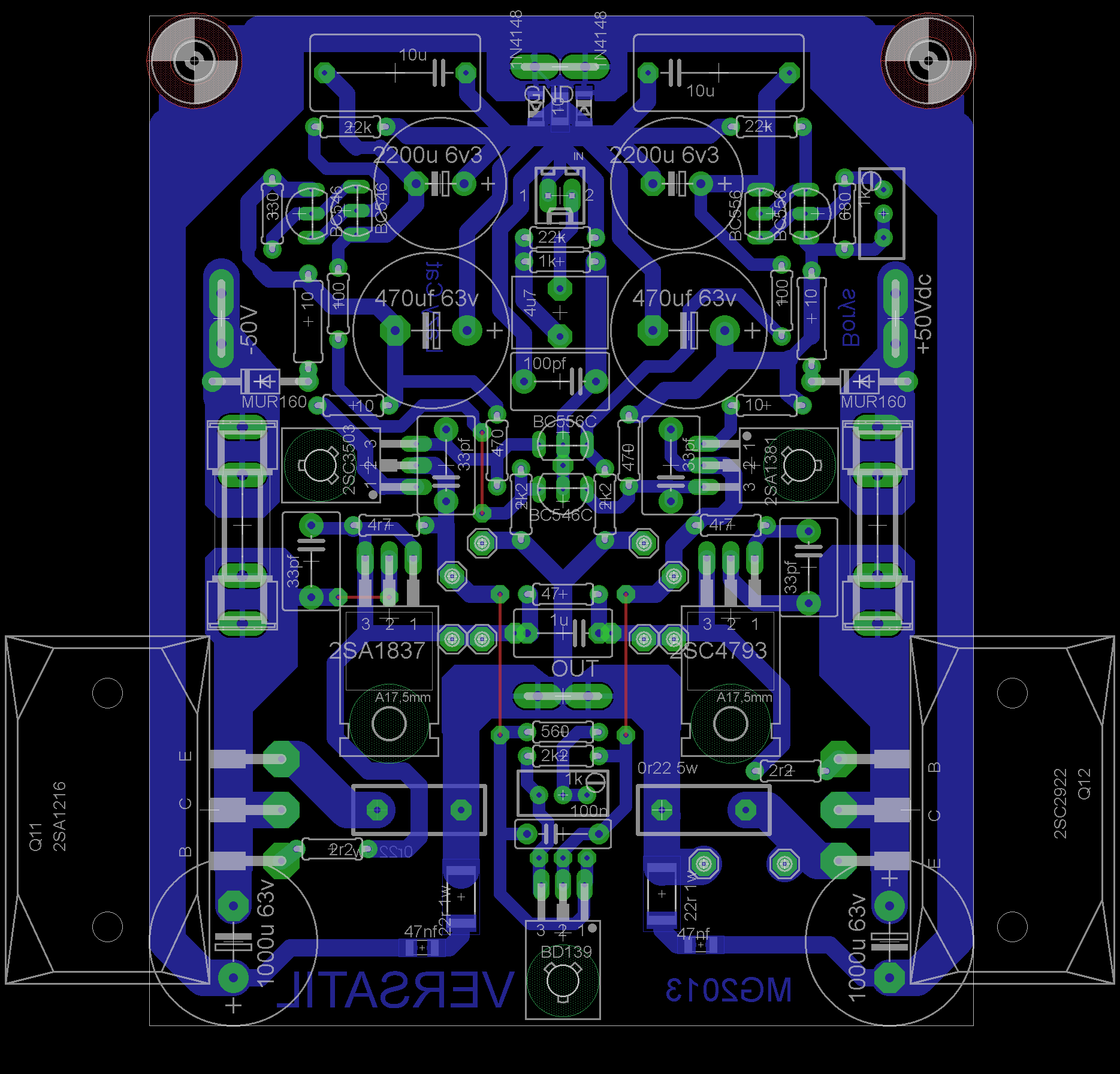

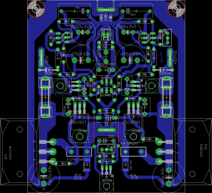

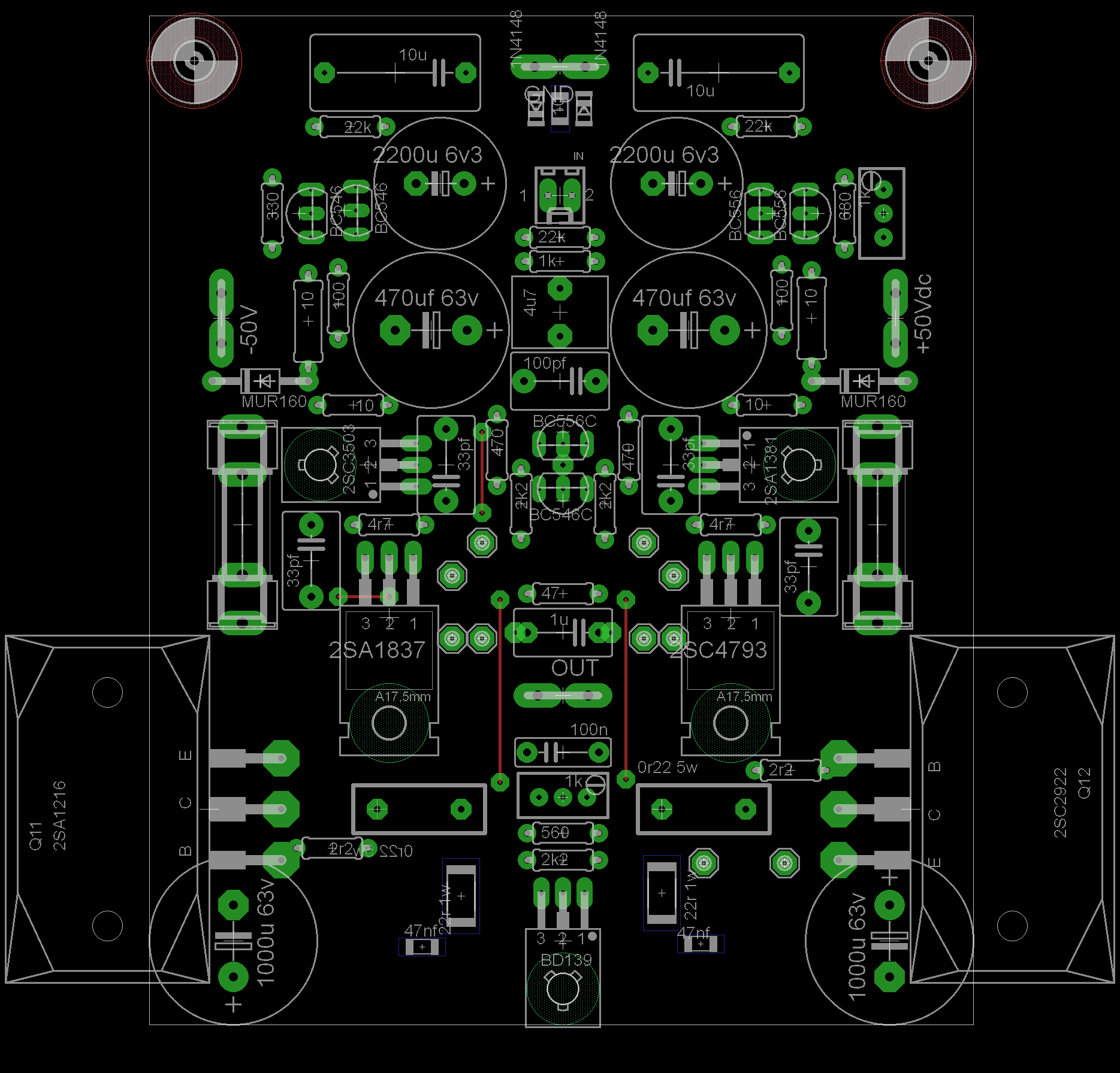

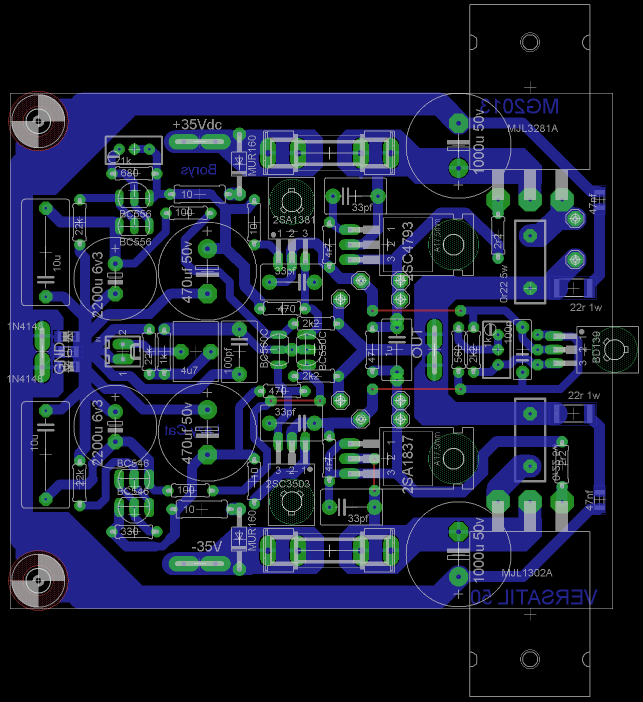

This building is based on a revised BG1 layout. I have some more mod to do so it can be use either with Bjt (To264/TO3P) either with mosfet (To247/To264) with or witout driver stage for mosfet=> a kind of universal BG1 pcb
NOTE to BYRTT : i don't forget your advices on BC i will place a via in the middle of the track between 550/5560, but with this pin config we must tight them together befor soldering on board=> no possibility to bent after.

I would do the pcb for BJT version + add some space for 2 zeners.
It would be universal for toshiba mosfets and BJT's. Two driver stage can be fitted in (my example) or one of them can be bypassed with jumpers.
For bias servo (with Toshiba mosfets) you can use bjt transistor - has similar tempco as 2sj201/2sk1530 (i have putted some pic before in this topic).
IRFP output version should have irf transistor as bias servo.

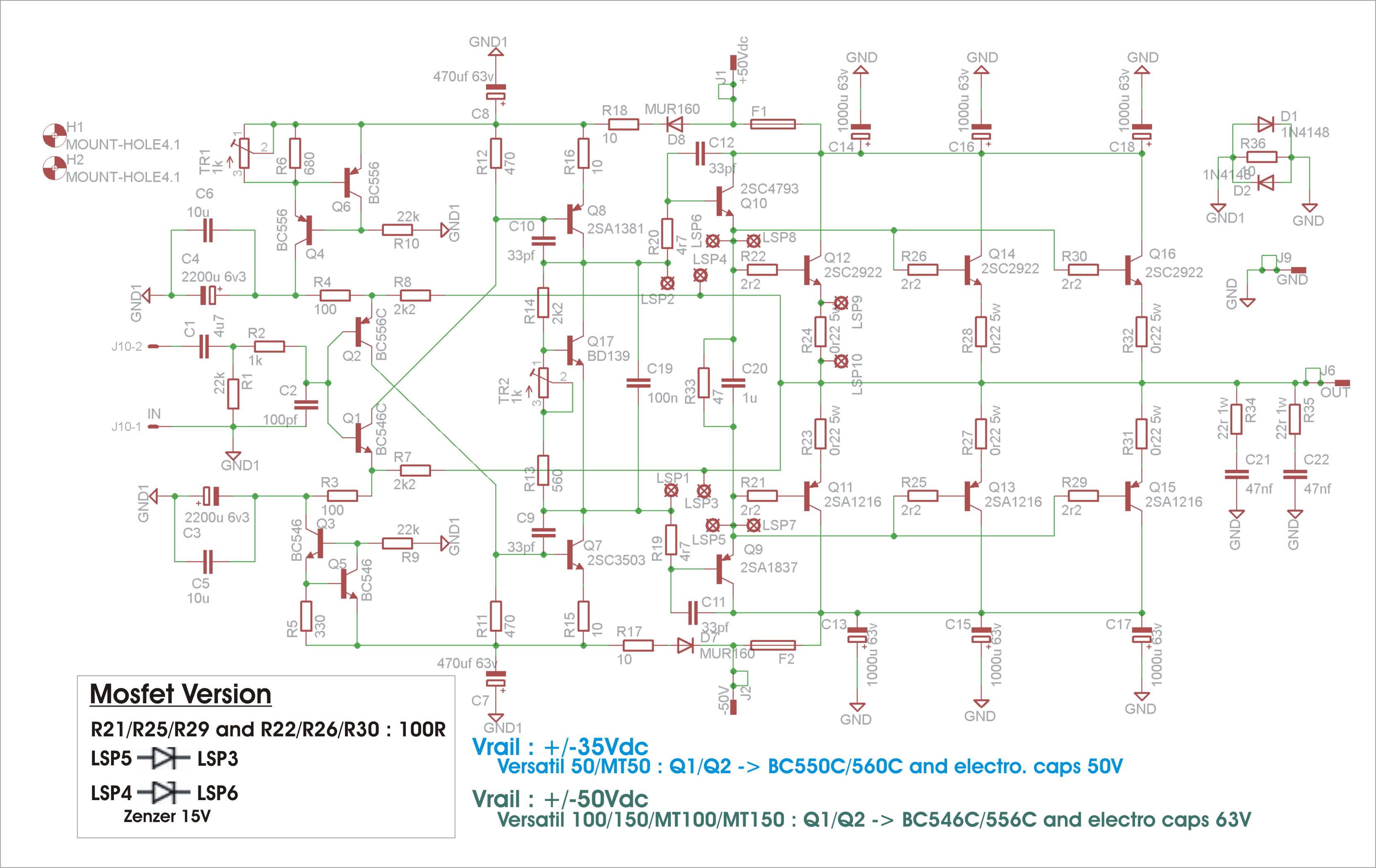

borys, Idefixes and others DIY-rs please take a look at these circuit if these correct how it drawn.
I want to compare with my old Darlington circuit which does not have CSS only a zener diode.
I do like the front end of these circuit.
So these will use power darlingtons and instead BD139 I will use darlington device there to.
The reason I want to test these topology with darlington
Way back 2 decade ago I built up the discrete darlington I used some Motorola power device (like MJL) with BD2## driver.
The result was very upsetting compare to the cheap BDW83C/84C darlington.
Also we tested with LATfet and the darlington much better in bass area
Probably the Sanken and better driver better in the circuit now but we only know if we test it.
Gabor

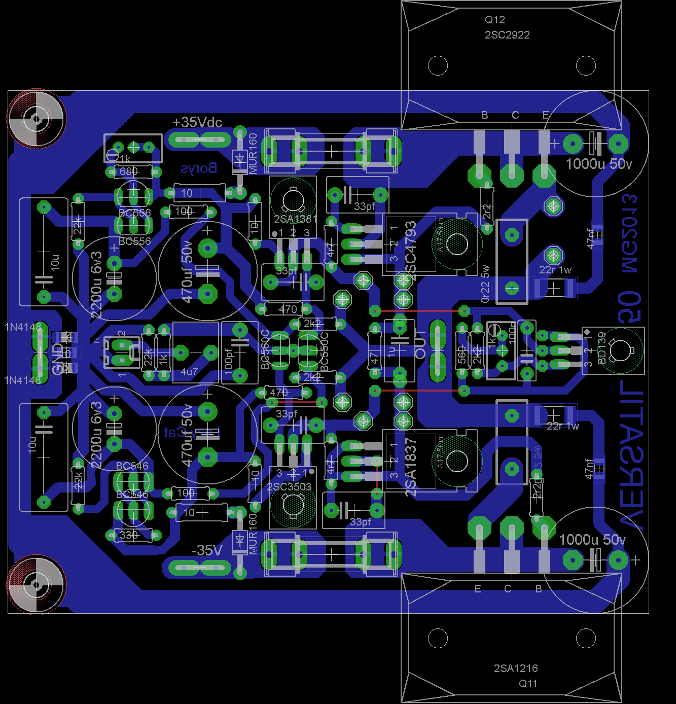

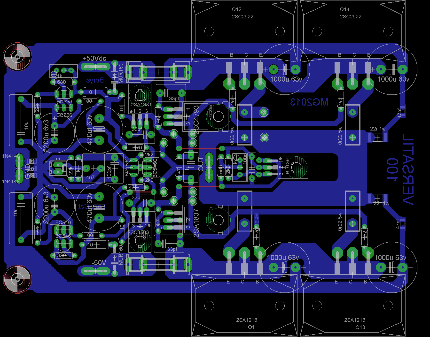

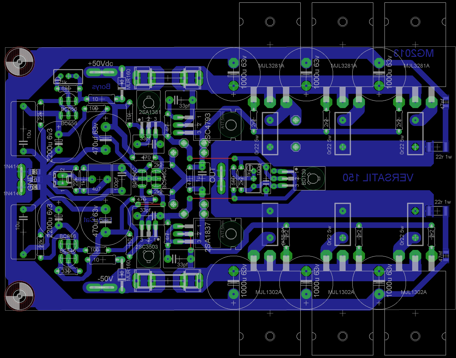

VERSATIL Family : TO3P/TO247/TO264 devices can be used
Either BJT or mosfet according modifications on schematic (place are on PCB)
-VERSATIL 50 : 1 pair OD +/-35Vdc rail 88x102mm
-VERSATIL 100 : 2 pair OD +/-50Vdc rail 88x123mm
-VERSATIL 150 : 3 pair OD +/-50Vdc rail 88x150mm
Marc
Marc

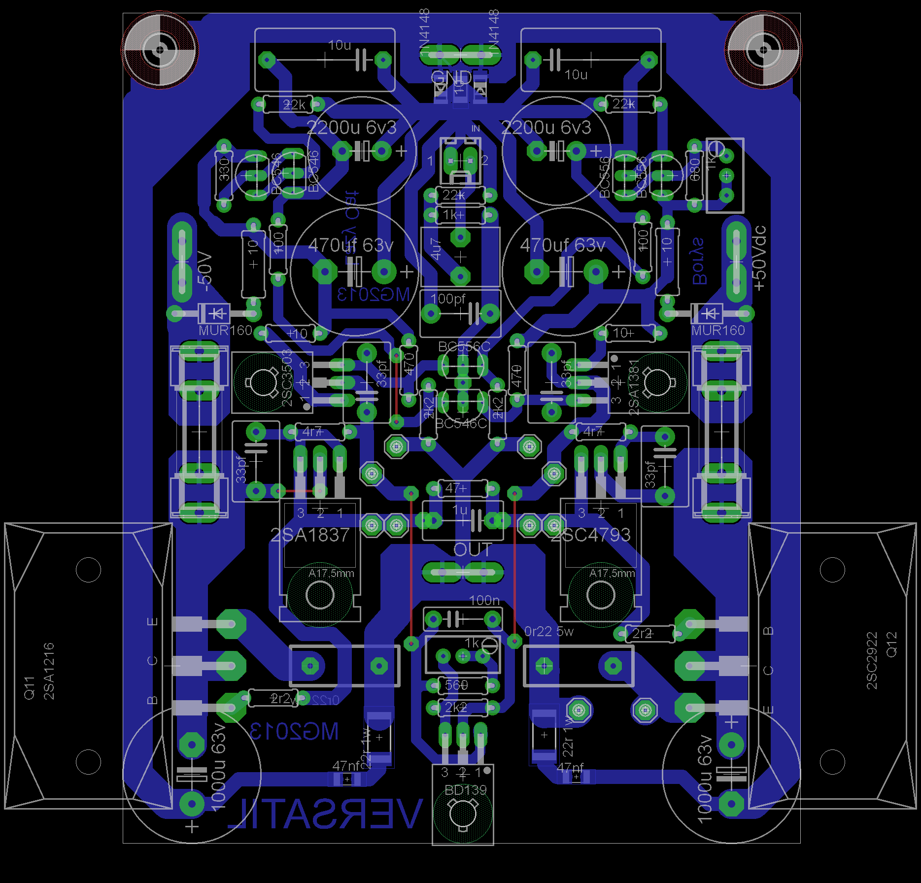

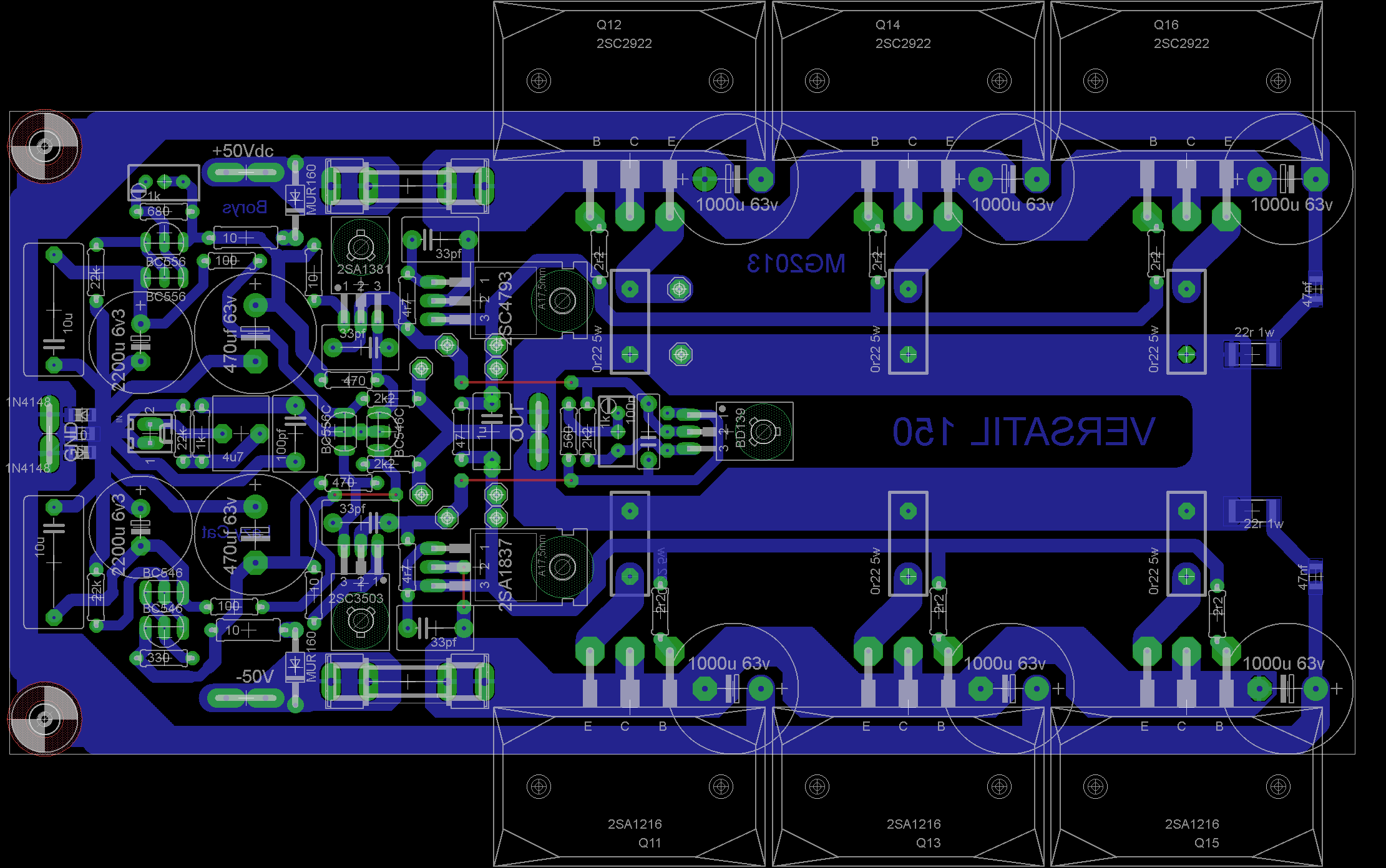

Versatil MT Family :
Same schematic and profile only with MT200 case device for Sanken
-VERSATIL MT50 : 88x107mm
-VERSATIL MT100 : 88x145mm
-VERSATIL MT150 : 88x183mm
Marc
Marc

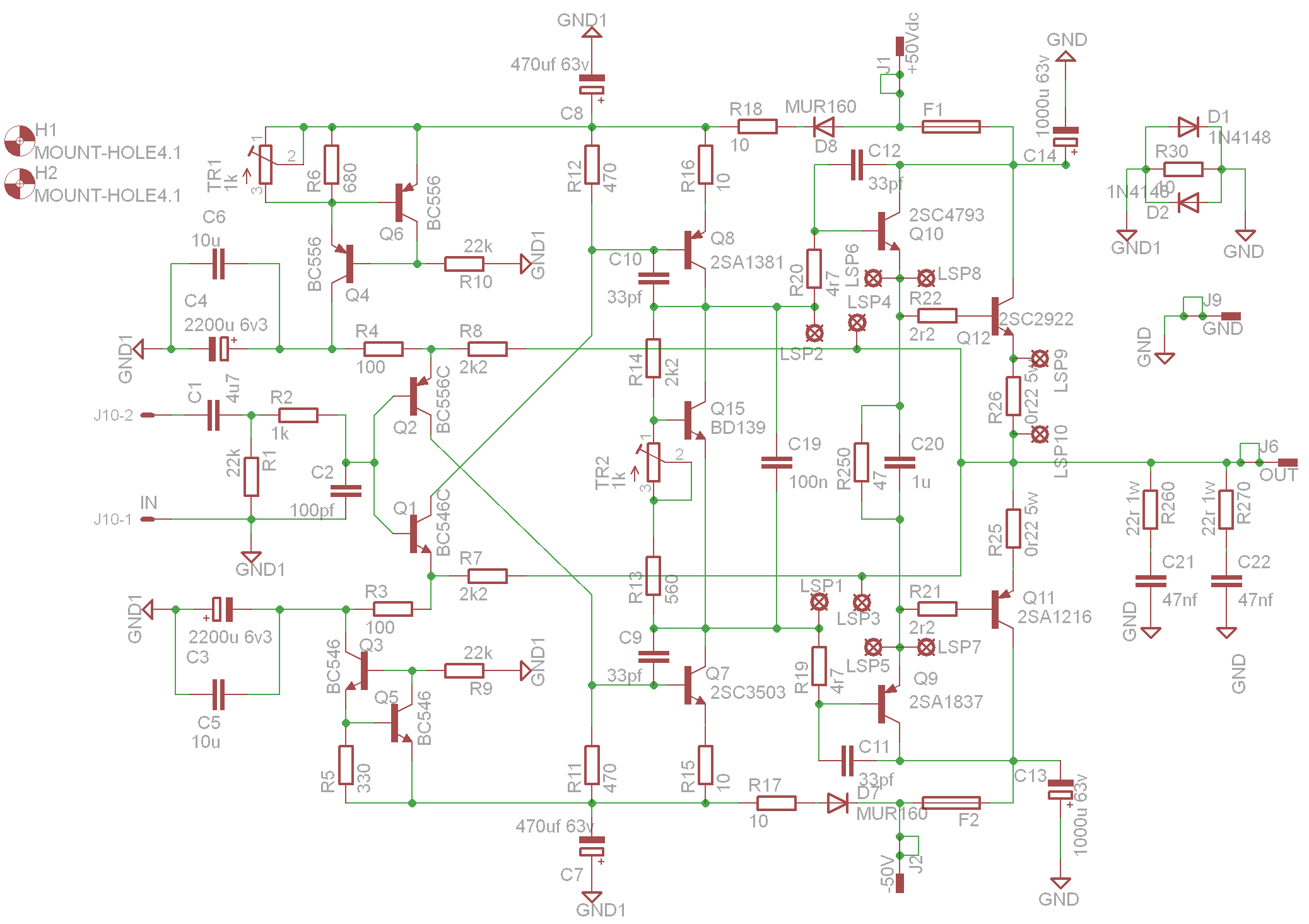

Thanks Idefixes for sharing your versatil pcbs 😎
Have you considered connecting C7/C8 return to GND instead of GND1 ? This could be the cherry on the cake?
Fab
Fab
Could you explain me the advantage to do this. When i look at schematic C7/C8 are after R18/D8 and R17/D7 so for me direct in first input stage PSU area that's why i connected them to GND1.
In practice connecting C7/C8 to GND is quite difficult to do without redesigning completely the whole input area.
Marc
Edit : in TSSA layout the same area is connected to GND to and not GND1...will take a look but explain me why...
