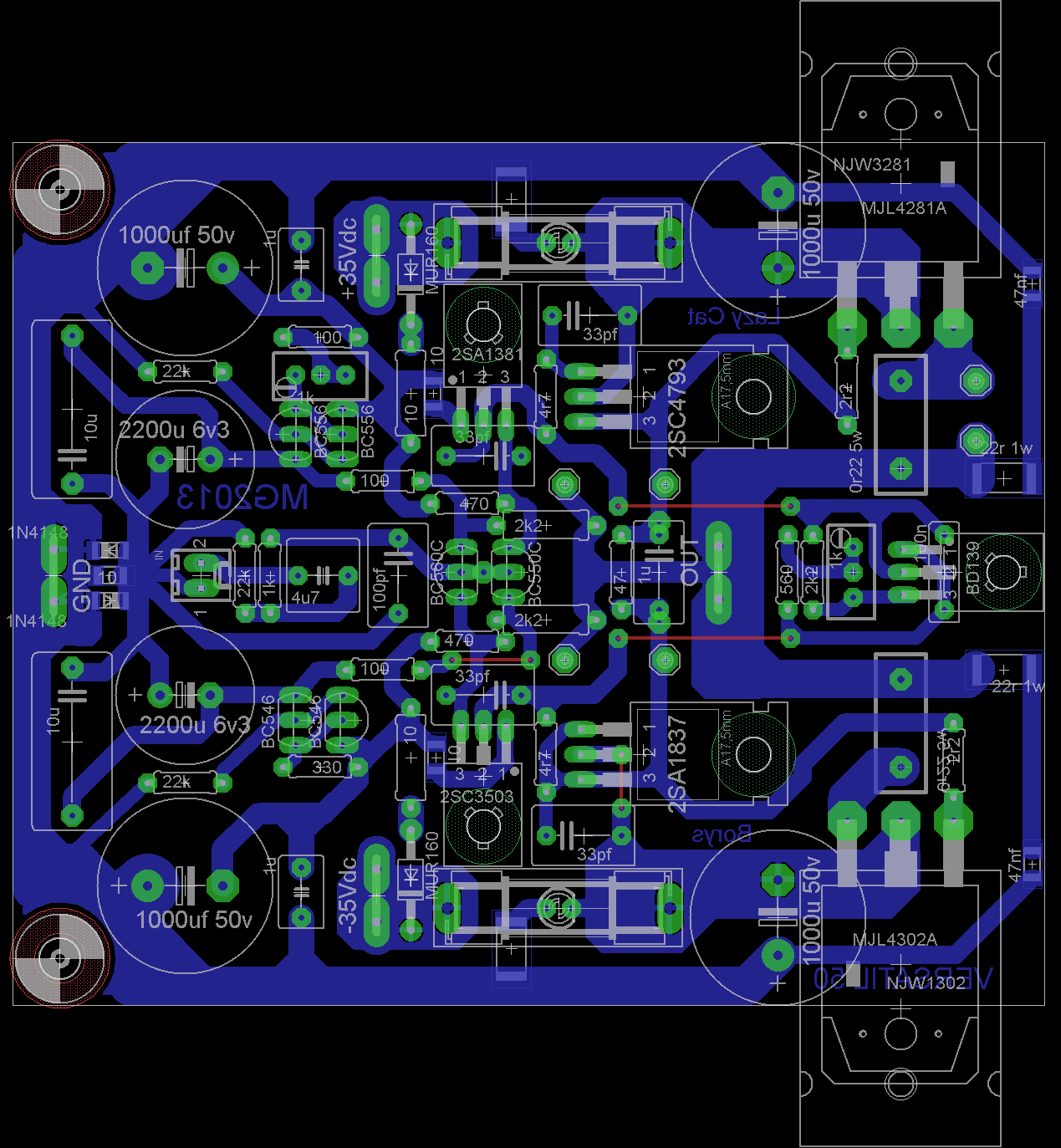

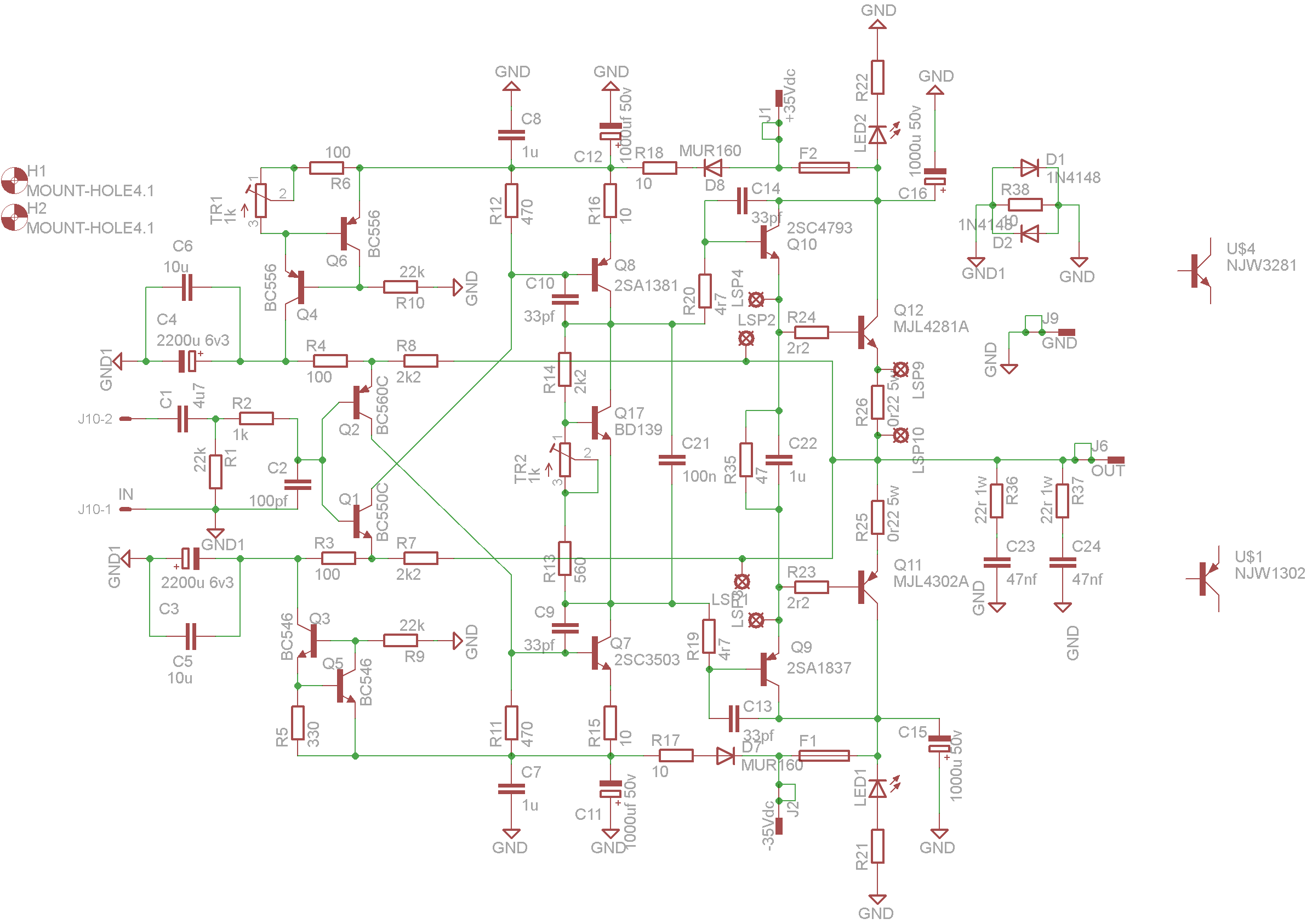

FET-hex explendit amplifier

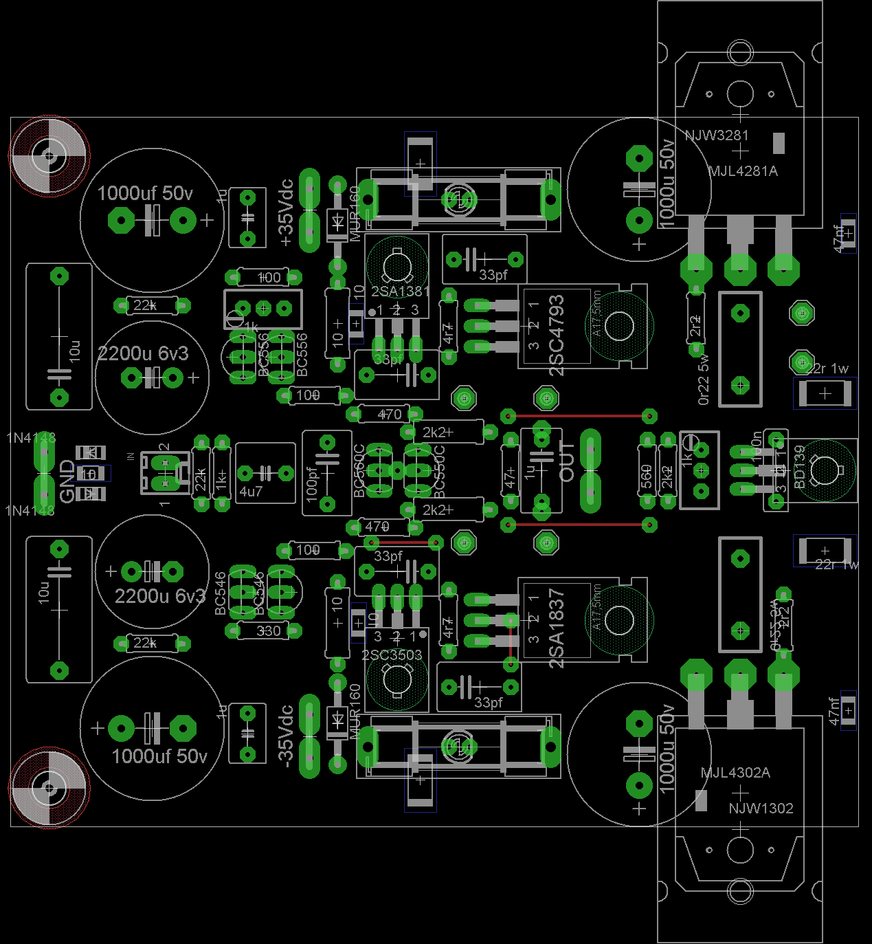

The parts marked with red square is boostrap for vas stage - take a look at this topic at the 1-2 pages there are scope diagrams how it works.
With boostrap output swings nearly rail to rail, with no boostrap output is loosing around 7V each supply rail!
Better of to use first schematic with bjt as temperature sensor, the 2sj/2sk toshiba mosfets would be over compensated around 30% in this case.
So You will have to set the bias at 130mA and after 20min you should get around 100mA. Toshiba mosfets and hexfets have different temperature characteristics.
If you do not need super efficient amp do not have to mount boostrap, get transformer with 2x30V ac and you will have around 80W@8R.

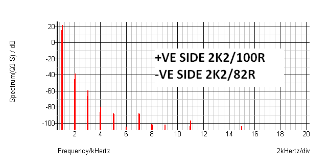

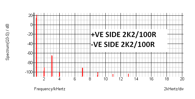

In case anyone is interested, more 'warmth' can be obtained by lowering one of the two 100R feedback resistors to say 82R with very little effect on bias and offset.
For illustration, some quick simulation furriers...

Hi Shaan !
Thanks for you suggestion and graphs !
Your 100R/82R graph results very close to so called `waterfall`THD sprectrum , where many people sense that sound same as you say as `warm` , less fatiguing for listening and preferable , regardless for increased THD % .
Best Regards !

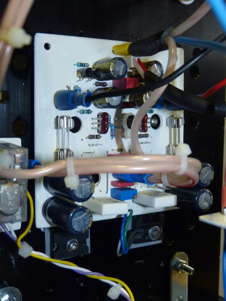

I am using simple psu with: DC protect, speaker ON delay, fast speaker OFF function. If someone will need I will post rest of the files.

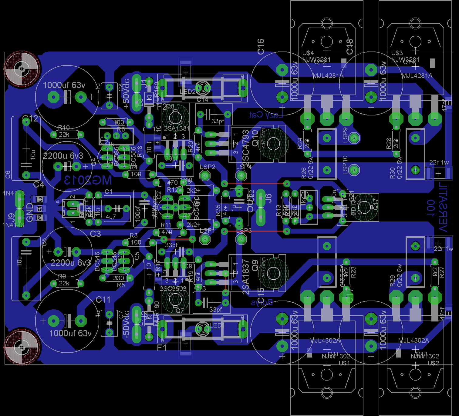

I continue to play with MJL4281/4302 bias alternating with listening session => first 50mA, than 30mA, after return to 50mA.
-50mA was little to Dark for me
-30mA was little "metal bow sounded" with singer center but...wide back of the stage
Than i test 40mA (8.8mV over 0R22 emitter resistor), and that it, the right sweet spot that out perform Sanken configuration : more clean sound, more equilibrate sound stage (wide versus deep), more define and deep bottom end and greater impact in this area too...so for me i can clam Onsemi MJL4281/4302 as winner in BG1-BJT...next step is to test NJW3281/1302 and MJL3281/1302...

Bellow you have both supply boards for caps diameter 25mm and 35mm.
In both versions You can put power resistors under the board. I have used 1W 1R smd resistors.

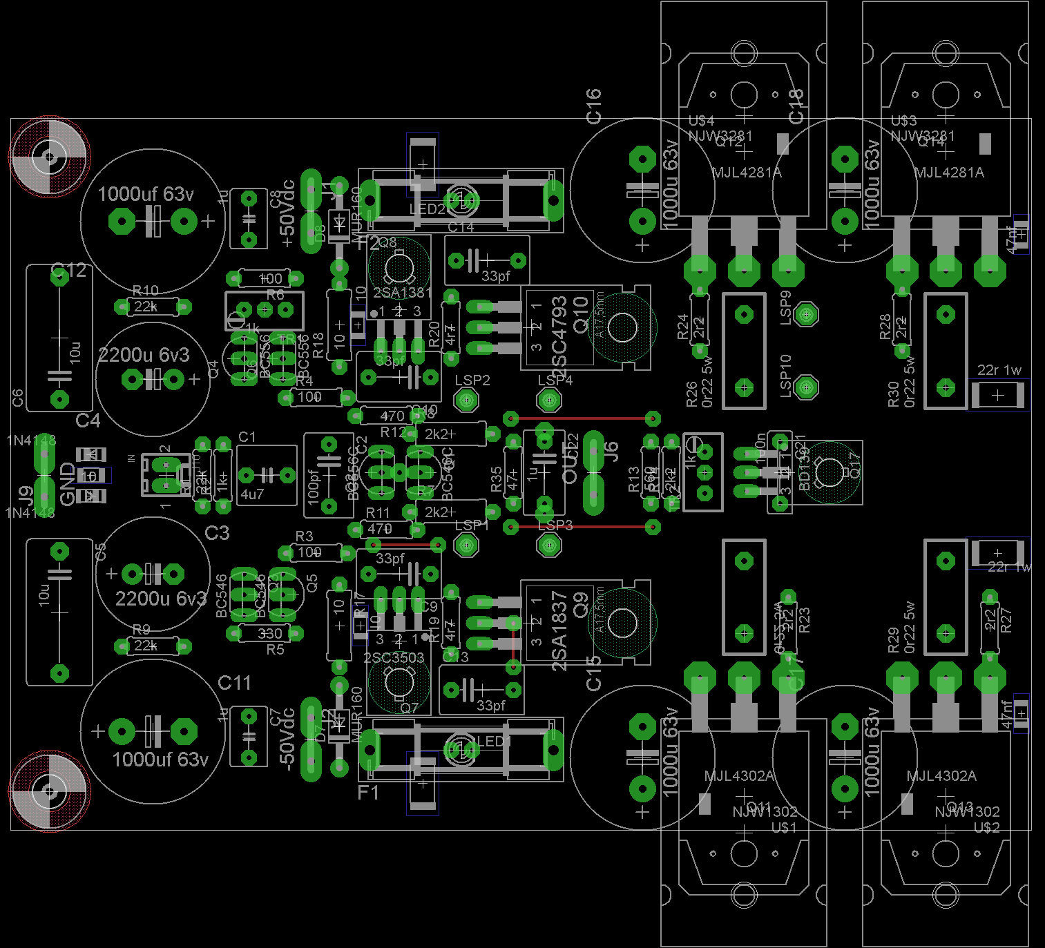

Hi Marc,
so the MT200 version is not so good compared to TO264/TO3P version?
I have a lot of MT200 like you use, they are very rugged 🙂
John for my MT200 the decision is clear, but yet are mine original or fake. If some one wants/need MT200 layout it is on my HD plate, but due to listening results and output devices availability and relaybility the better things to do is going for TO264/TO3P configuration.
