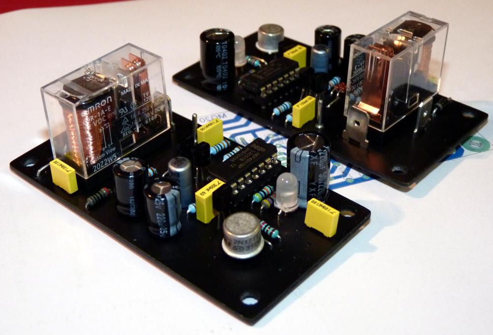

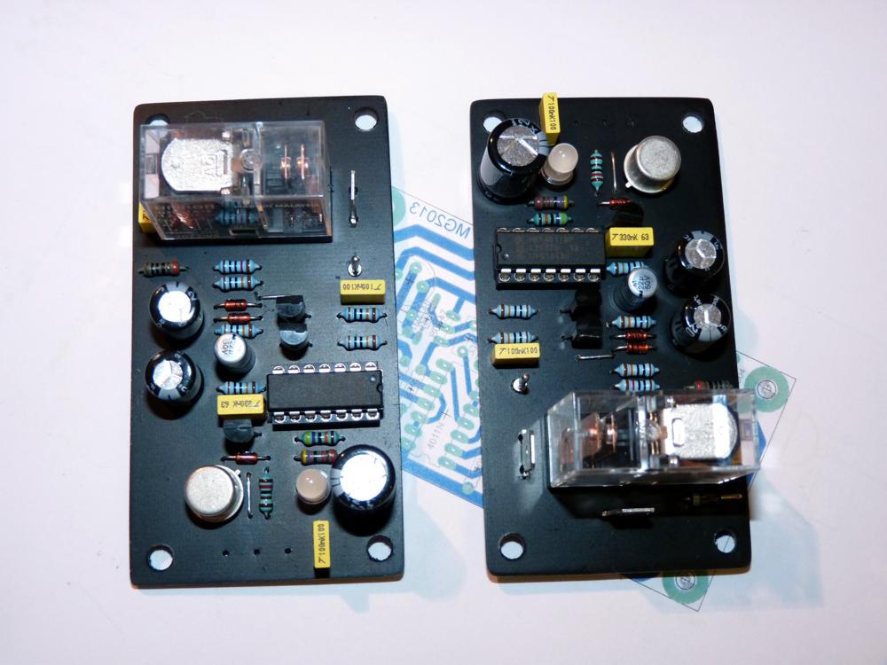

Little progress in versatil 50 building process : speaker delay and dc protection board. This must be feed by 0/+12Vdc PSU.
I re-etch new versatil 50 board as i gave an evolution to the board by reduce the whole size. I am waitjing some SMD resistors to populate them.
Nice work. But there is very simple way to add very small psu circuit. Only few resistors, one npn tranistor with zener diode and there is no need separate transformer for protection board. Speaker protect can be supplied directly from amp psu voltage.
Hi Borys,
The 12V PSU exist all ready in soft start board so no issue with that.
Marc
