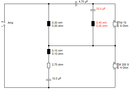

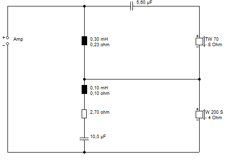

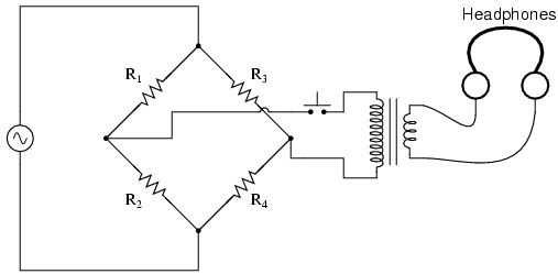

I prefer null or bridge techniques when doing lab work. The experiment really should be designed to expose the effect we are looking for. Bridge techniques expose the DIFFERENCES!
The tweeter coil in a series filter is traditionally a very critical component. I really don't know if I'll find time to do this, but the idea is that replacing the 0.3mH tweeter aircoil with a ferrite ought to produce some white noise, aka Barkhausen effect because the entire audio spectrum and power is passing through that coil, when a 1.4kHz test tone is applied to the filter. The test tone is suppressed 40db at least. Enough, I think. And doable.
You'd replace the bass with a 4 ohm resistor, and I add a notch at 1.4kHz to take out most of the test tone from the tweeter. Then you should simply hear the noise from the ferrite coming out of the tweeter. Cool eh? And it applies to a real speaker. 😎

Applying some common sense (doesn't seem to be all that common)...
What would be the point in replacing 0.3mH air core with ferrite or iron cored inductor?
If lowering DCR is the aim, its not difficult to merely increase wire gauge of the air cored coil.
I know in my experience (remaining modest, in keeping with my experience), I would only consider a cored coil for inductances greater than 2 mH or so.
There seems very little point in doing otherwise.
