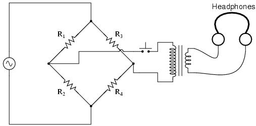

I don't know what to make of that. Your technique includes DAC and amplifier noise. How do you assess audibility?
I still think that only a bridge or null technique is useful here. Easy enough to add a series resistor to one of the two coils being compared to match DCR.
See, the common noise cancels out! The headphones below could be a tweeter, maybe with a series capacitor to protect it. The resistors could be 16R, and the coils anything you have of the same mH value.
By listening to the above recordings that I posted 😕 The majority of noise is from mains ripple on the amplifiers supply rails. You can't expect too much when running an amplifier at half it's rated power continuously. The noise from the DAC/amp/ADC is exactly the same on every recording, disregarding the fact that it's passed through a lowpass filter by the inductor under test. If you listen to the amp and inductor residuals the IMD is obvious.
Lets be realistic here, I use exactly the same equipment to listen to music, so if it can't be audible under a worst case scenario, what chance does it have of being audible under normal listening conditions?
Problem with that is all the components need to be very well matched (<0.1%) to get decent common mode rejection. Otherwise you're back to square one trying to extract meaningful information out of a noise floor.

I'm perplexed as well by System7's insistence on using a technique that will be much more difficult to use in practice, and apparent refusal to study the data presented for what it is...and how to use it in context with the rest of a loudspeaker system. Just wanted to let you know I definitely appreciate the obvious work you've put into this.

The basic idea is pretty sound, implementation is difficult. What it needs to be implemented practically is a high power variable resistor and high power variable inductor. The variable inductor would need to be air core obviously. Then you'd adjust the variable components until you get adequate common mode rejection. Then you have the issue of accurately amplifying/measuring the differential signal that results.
