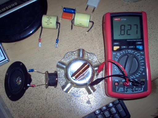

THAT is what a cored coil sounds like. I don't care whether there was hum pickup or whatever due to high impedance load.
Now take it or leave it. I certainly don't want to set up a science laboratory to investigate the effect. Though I'm not averse to simple experiments on coil interaction myself. I satisfied myself that coils (here 1mH ferrite core) DO interact with each other audibly and with nearby earth planes. But I might think a couple of bucks extra spent on an aircoil worthwhile. Which is what the original poster was asking.
