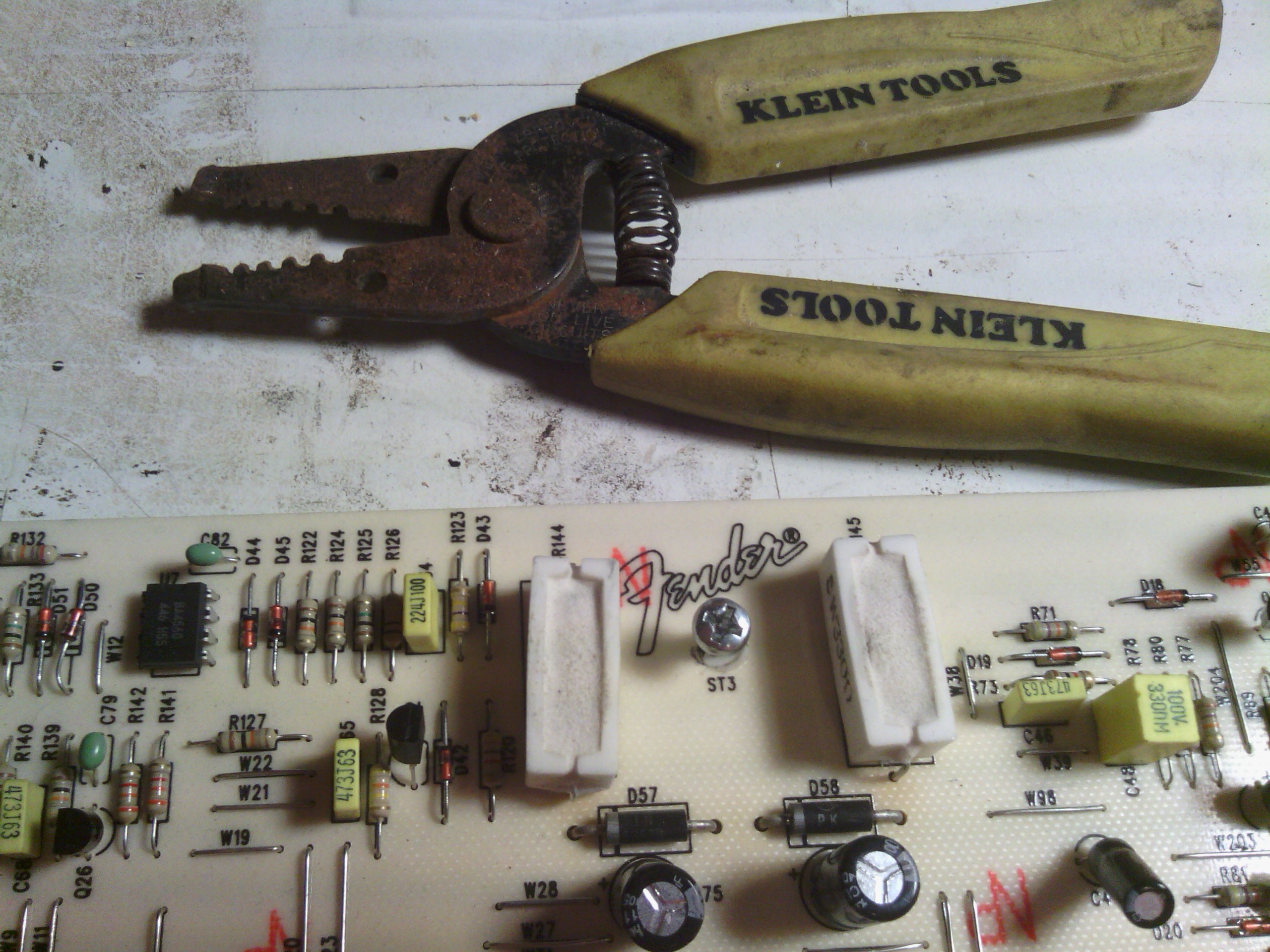

As a side note, when I touched the test lead to to R144 (left) its loose. The metal leads seem to be ok but the body moves easily. I checked the ohm (amp unplugged) of R144 (top side) and get 340 ohms. When I flip the PCB over and test the terminals at the solder joints, I get an open. R145 show 340 on top and bottom.
I haven't done anything yet and won't until I get instructions from you. I think the joints need to be desoldered and resoldered.
I await your instructions.

Power Rails
I've been reading about amplifier circuits and studying my schematic. I am learning about power rails and the common or GNDA.
R144 is on the + rail and shows 30VDC before and 15 VDC after
R145 is on the - rail and shows basically the same readings.
Both of these resistors show 340 ohms (connected to the circuit) The schematic shows these to be 200 ohms with 10% tolerance. 200 + 10% is 240 ohms so at first glance, these are way too high. Of course they are hooked to the circuit so something else may be influencing the reading.
I need to correct the results I gave yesterday for p3 and p4. There is actually 26 volts AC on each. I was under the impression these points are DC but these are the connections where the AC has been stepped down but before the diodes where one side of the AC wave is filtered out (or blocked) to provide a half ripple and then through the 4700uf caps which charge and "slowly" discharge (at a slower rate than the rectified half ripples) which gives us a smooth or "clean" DC supply of power.
I gotta tell you I was thinking the transformer had taken a crap. What was throwing me off was that I had dc power down stream of the caps. But anyway...
So... So far I have (I believe) the correct or close to correct voltage where its supposed to be. So I am at a loss as to why the amp isn't producing sound when I plug the guitar in.
More reading and studying...

A whole circuit dead
I've been comparing the schematic and voltages that should be present.
If you look on the schematic in the lower right hand corner you should find D38 and D39. On the banded end of each diode I have line voltage. D38 is + 30v and D39 is -30v But the two connections between them, the top one leads to the positive speaker terminal, is all dead. From there all the way across the page (going left) the whole circuit is dead. R77 and 78 have no power. I cannot seem to locate R79. I can find everything else but that one is hidden apparently. This whole area ties into U6-A and B I can't seem to figure out the common denominator here but this is where the problem obviously lies.
So far everything else seems to have proper values.
Any suggestions?

Those two diodes are between the output bus and the two main power suppy voltages. They are wired in reverse bias, meaning that under normal circumstances they do not conduct. If one were shorted, there would be that power supply voltage on the output. If you removed them completely, the amp would still run, it would then simply lack the protective function they represent.
Your output bus is supposed to sit at about zero volts DC. SO anything connected to that output bus would normally have zero volts DC as well. Follow the line from the output speaker + connection and it leads directly to R77 and R78, through R79. SO we WANT them to have zero DC on them. I have no idea where R79 is on the board, you could follow the copper traces from the speaker + to see where it leads. But if you have R77 and R78 in sight, just measure resistance from them to the speaker+ point and see if you get the 27k.

I finally found R79. Its out of area from the other resistors in that numeric range. Each of them are showing correct resistance per the schematic.
I don't have the the 2.05 VAC at the + speaker terminal. In fact I don't have anything there. And the new transistors are running hot (in my inexperienced opinion)
Shouldn't I be getting something at the speaker terminal? When I plug in the guitar and the speaker I don't get any sound.
I have a long ways before I understand electronics but I am reading and learning all I can. Just not sure where to go from here because everything I test seems to be in range, except of course for the value at the speaker terminal.
