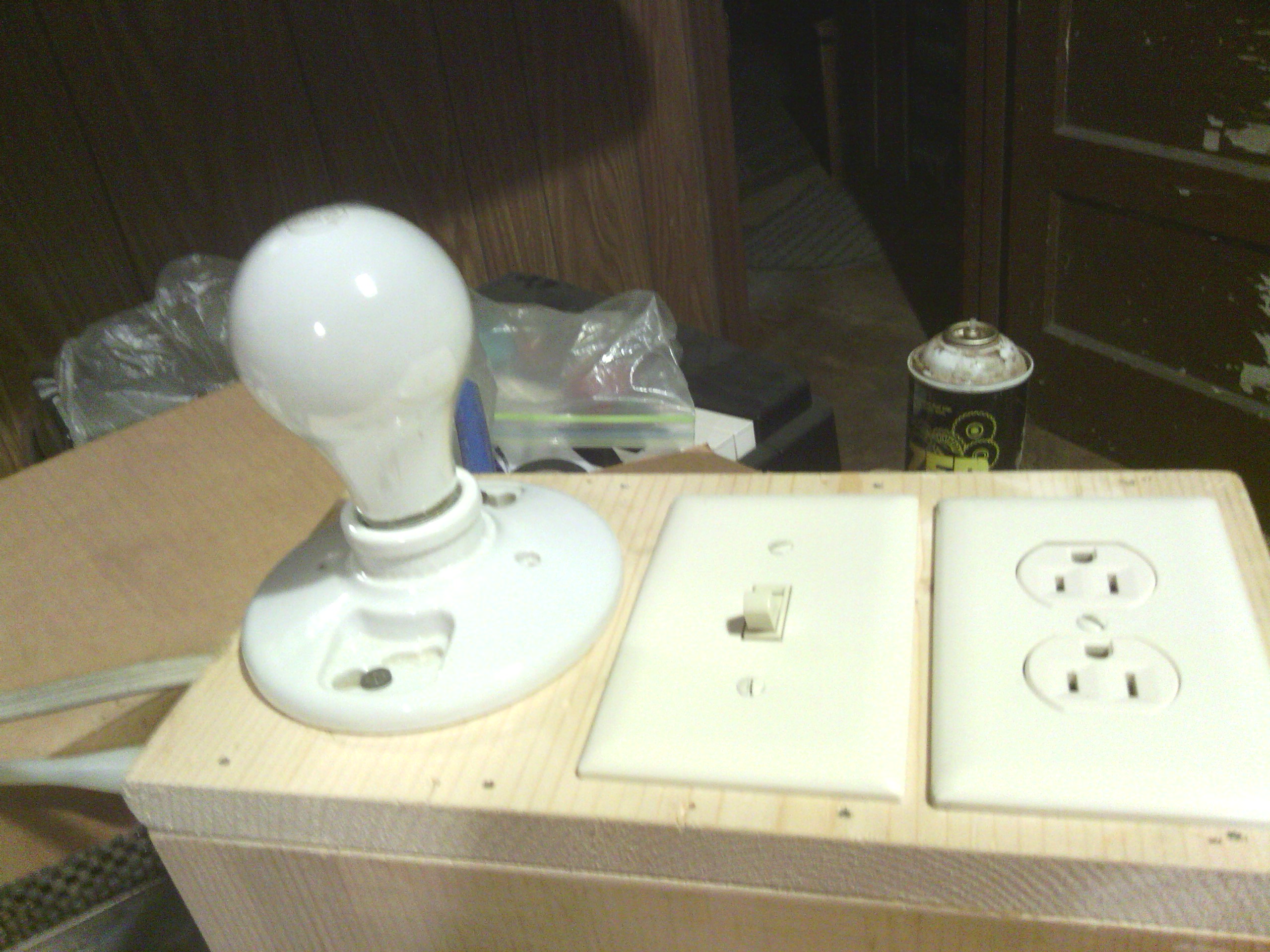

JMFahey I built the current limiter. Picture is attached.
I understand what's its supposed to do but I am not sure how to check the amp (if it will fire up without blowing the fuse)

The power limiter works, I can turn the amp on and it doesn't blow the fuse.

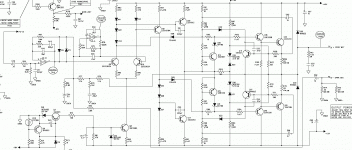

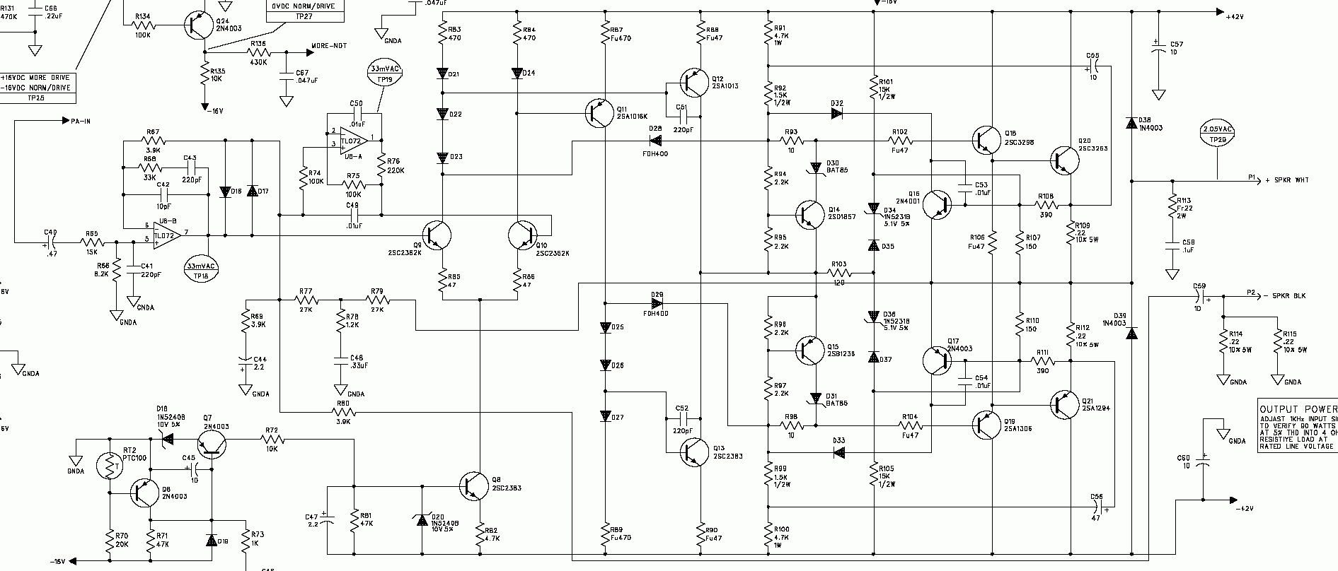

Dear badraven, let's not mix 2 different troubleshooting avenues, or it will become confusing.
1) without load (speaker) connected, turn the amp on plugged into the current limiter, whether it blinks or stays brightly lit already is an indication, and the do some *voltage* measurements.
The first 3 are voltage at the +V and -V rails (+42V , -42V) and the DC voltage at the speaker output one (P1 spkr wht).
Post your results.
2) now with amp off, even better unplugged, you will take some resistance readings.
To be more precise, we will use the "Diode test" setting, which applies a couple mA to the probes and shows the voltage reading between them.
We will measure the big suspects, the output and driver transistors.
We *expect* to find around 0.65V (650mV) across BE and BC junctions, one way; open or much higher (over 2V) the other way, and also open CE, both ways.
If any reading in a transistor is close to "0", it's an immediate suspect.
Carefully remove it and remeasure "outside".
You must measure: Q18/19/20/21 ; also check (in the regular 200 ohms scale) that R109/112 are not open.
Your multimeter will probably show a higher value, say 1/2 or 1 ohm, but that's fine, regular multimeters also add their own internal resistance (wiring/cpnnectors/switches/probes) which never is "0", what we don't expect there is "open" or a *large* value , sy 10 ohms or more.
Post results.
PS: just as an extra test, measure resistance to ground from Q20/21 collectors.
We don't want to find them shorted to ground.

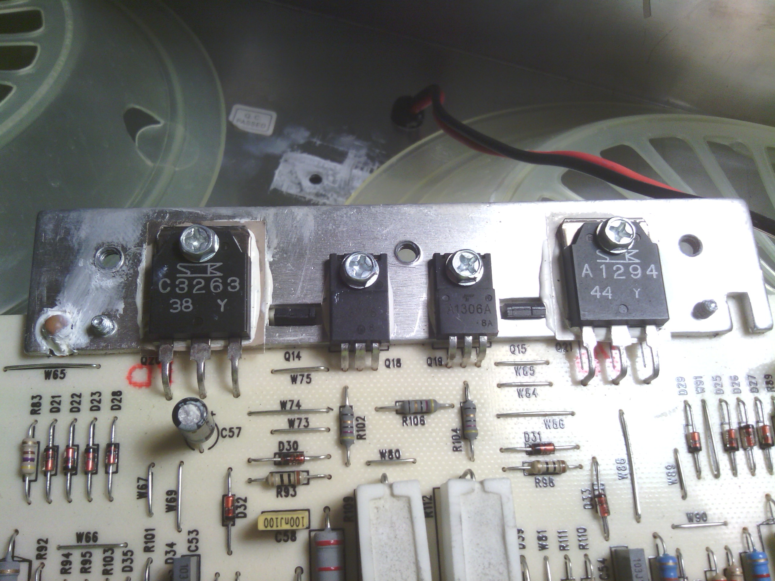

Transistor ohms Check
The 4 transistors on the heat sink are from left to right:
Pin convention all four: (L - R) A B C
Q20 (chip marking C3263) A - B = 28.5 ohms, B - C = 0, A - C = 28.3
Q18 (C3298) A - B = 4.46, B - C = 28.5, A - C = 4.49
Q19 (A1306A) A - B = 4.46, B - C = 0.1, A - C = 4.46
Q21 (A1294) A - B = 0.1, B - C = 0, A - C = bounces 0.1 - 0.2

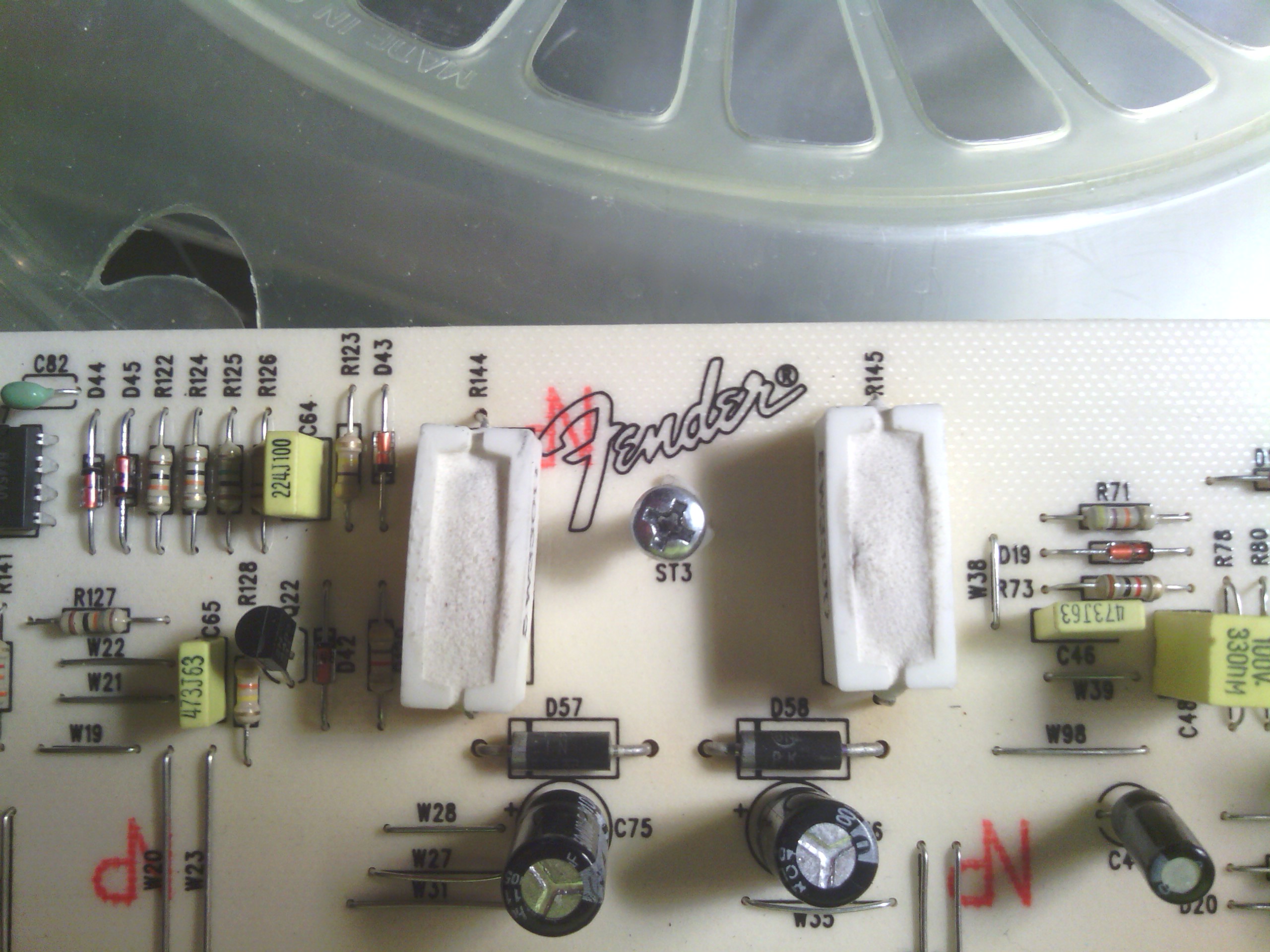

In the second pic there are two resistors R144 and R145
R145 has a deformation on top. It isn't burnt or discolored but it is deformed on top. It may be a casting flaw or something like that but I am bringing it to your attention just in case its something to worry about.
R145 = 328 ohms
R144 = 341 ohms

Well, Q20/21 are definitely shorted (it's what was expected anyway 🙁 ), must be replaced.
Q19 is also shorted and Q18, although it might be alive, should be replaced anyway because it probably overheated anyway.
No problem but next time let's call transistor pins B-C-E (as shown, left to right) to avoid a possible extra source of confusion. 🙂
Please check R109/112 are not open.
R144/145 are not shown on the cropped schematic I posted, but I think they are the voltage droppers to get +/-15V rails .
The measured value is consistent with the ¿470 ohms? original value, so they look fine.
That small imperfection looks like a casting drop, nothing dangerous.
Ok, keep testing and order replacement transistors + micas/grease, whatever you need to mount the new ones.

When I run the amp through the limiter the fuse does not blow. The 75watt light comes on and it fairly bright. I don't think its as bright as normal but its not dim and it does not blink, its on steady.
Post results.
We don't want to find them shorted to ground.[/QUOTE]

If your lamp is coming on then something is talking serious current.
Points to a short somewhere like transformer, smoothing capacitors, output transistors.
