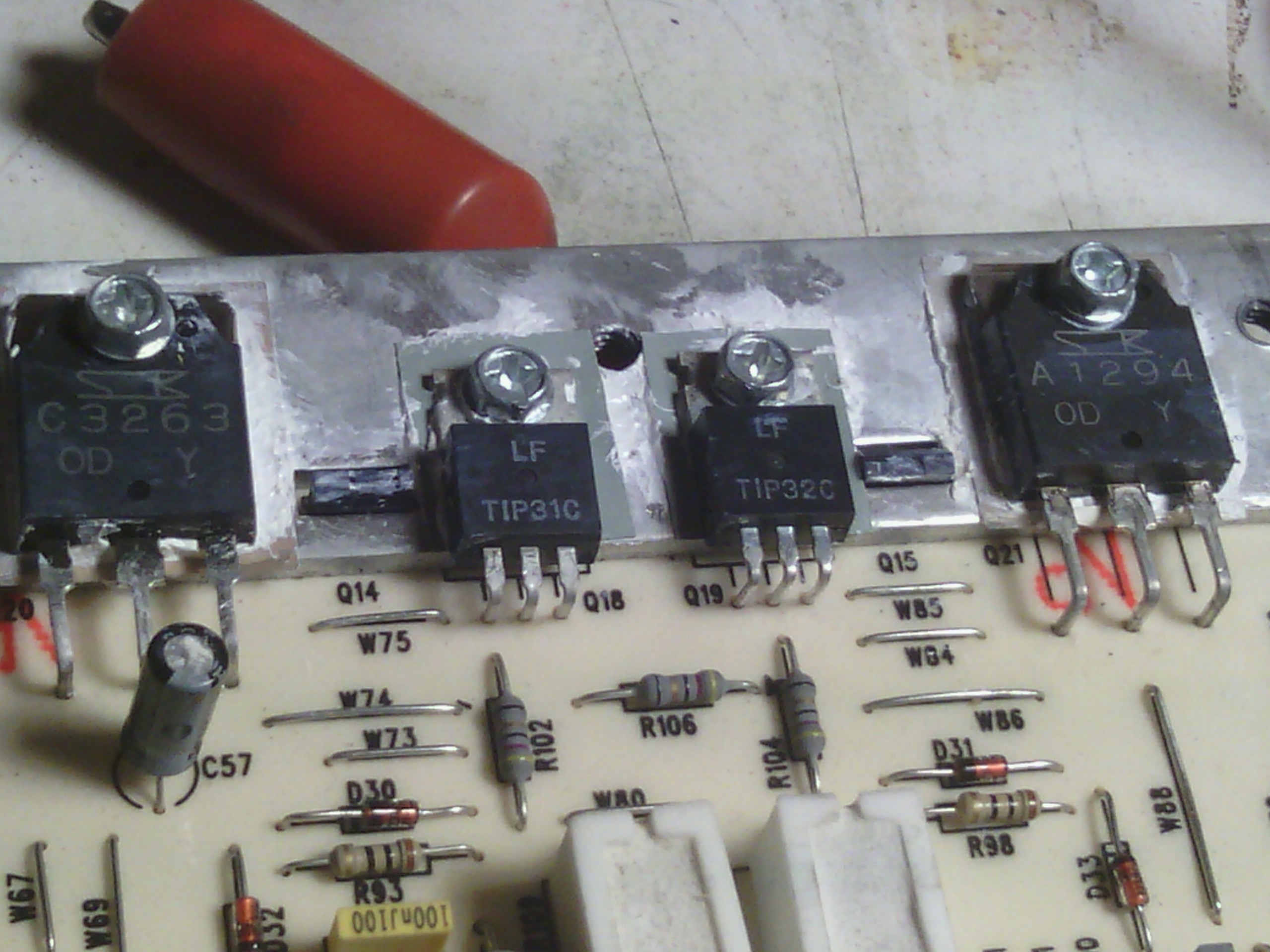

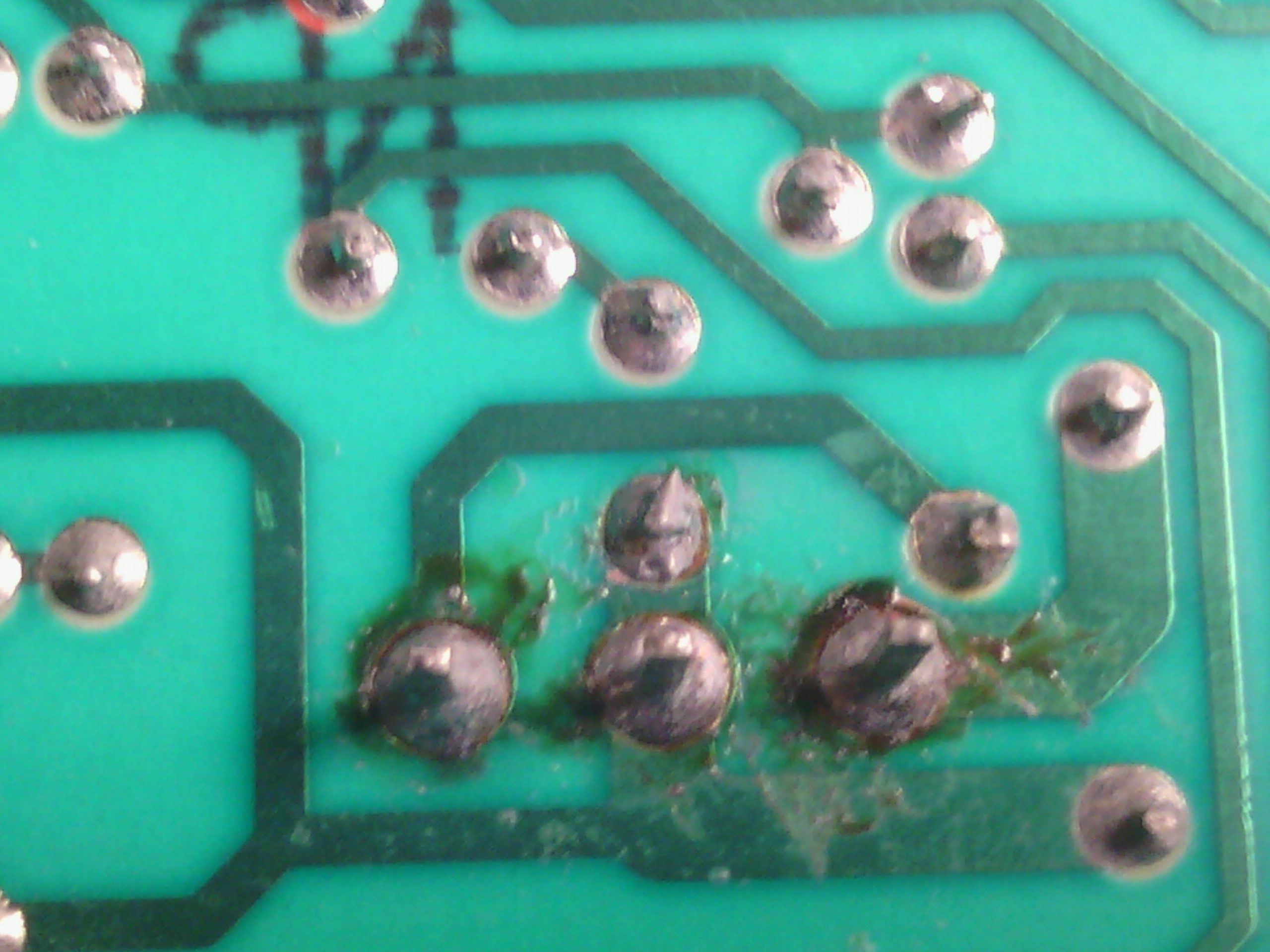

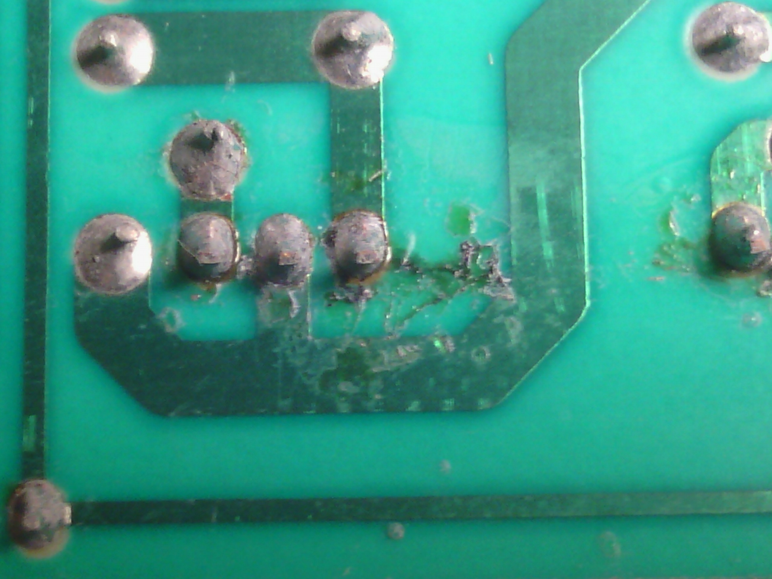

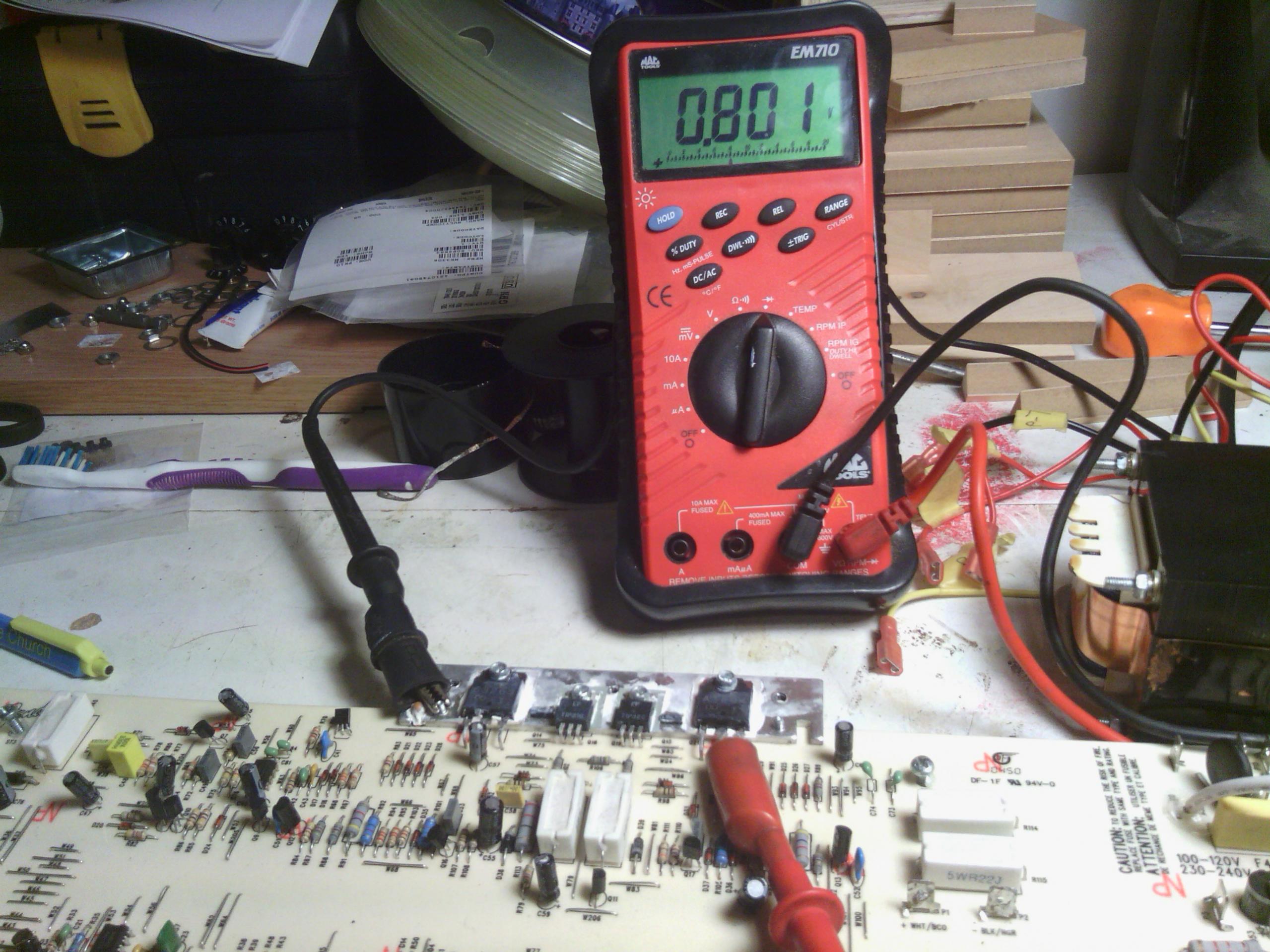

New Resistors
Transistor Collector test, meter set to Diode Test:
Q20 - .002
Q18 - .002
Q19 - .002
Q21 - see pic
Well, I see a nice, solid *short* there.
Two of them in fact.
*My* fault, of course. 🙁
I should have warned you that the original Japanese transistor has a built-in plastic insulated tab and the hole in it, while the TIP has an exposed metal tab and mounting hole.
That's why the Japanese has a 3 mm hole, and the American has a larger 4 mm one, so you can fit an insulated nipple there, which both insulates the hole inside and the screw head:
You need this, which you won't have to order, I'm sure local Radio Shack or equivalent has it:
You needn't solder anything, just pull the screw, push the nipple in the hole and replace screw.
Sorry 🙁
