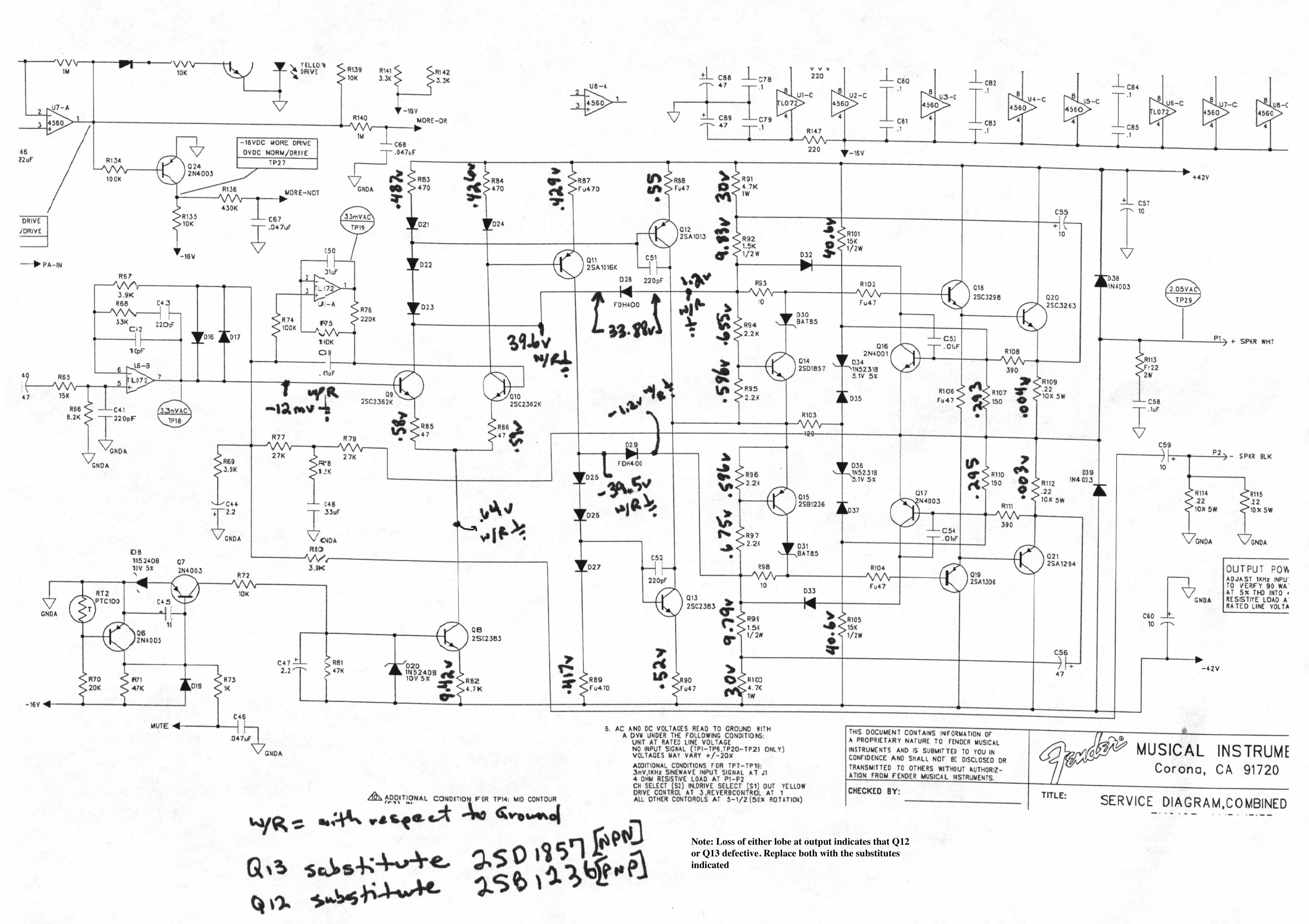

Sorry about that.... I gave wrong schematic. The FM212R does suffer with solder joints. But intermittent distortion problems in recent repairs where finally tracked down to Q12 and Q13. Could be breakdown or internal transistor structure problems.
Replace with indicated substitutes...and this time with the correct schematic!

First, just by looking at the board, I found R84 (470 ohms) completely fried. I replaced it but it made no difference. After reading this thread, I tried some measurements, and found 20+ DC volts on the speakers. Following Enzo's advice, I checked the output transistors (Q18 to 21) and found them shorted.
Any advice before I change the transistors ?
Same problem here. The power amp transistors measured "open" in-circuit because of oxidation. I then switched test probes for stainless steel pinpoint-type, then all transistors measured ok.
Turned out the pre-amp auxiliary +/- 15V supply was noisy/unstable because of cracked solder joints around the zener diode circuit D57/D58 and R144/145. Caused by very high temperature of these components, which operate close to their limits. There was a minor discoloration around these zeners. The solder joints were stressed, aged and broke as a result.
