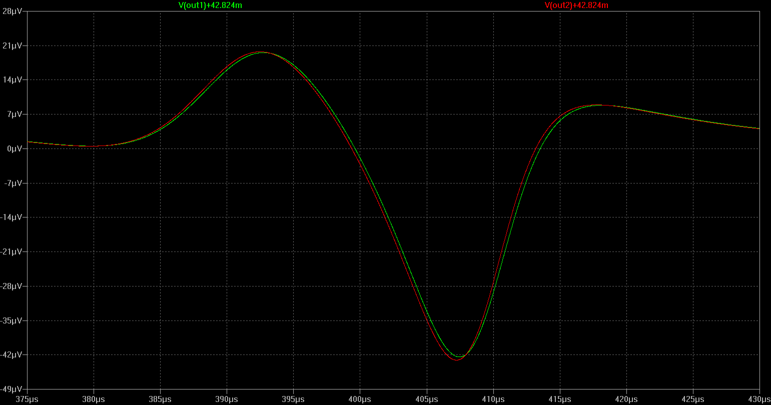

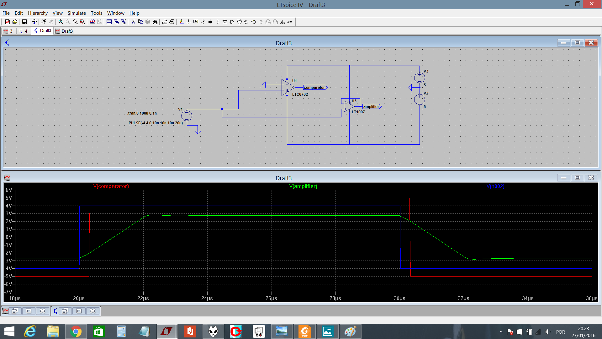

In this photo we have an example of propagation delay, all comparators exhibit propagation delay and as we can also see the opamp starts to react immediately to the input signal it has no propagation delay, and is because of this that the feedback reacts immediately.
Another example that time delay in power amplifiers is not important.

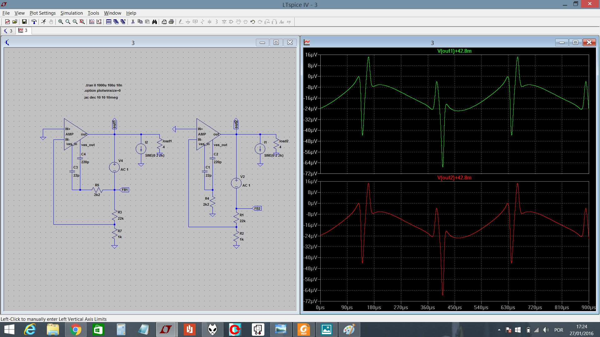

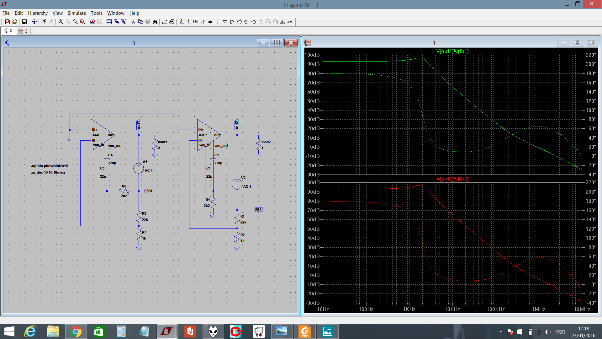

The first photo is the loop gain of the two topology the first is TMC that has a time delay of 266ns and second is TPC that has a time delay of only 0.6nS ( yes less than 1nS ) , the loop gain at 2Khz is the same on the two topologies.
The second image is the output voltage of the two Amplifiers when a current of 4A (p-p) is injected at the output.
As we can see the error is equal in the two amplifiers , although the TMC amplifier have much more delay than the TPC.

This is the Zoom of the crossover spikes at output of the TMC and TPC amplifier, we can see the delay between the output of the 2 amplifiers, but the error is near equal for both.
The crossover distortion is a good example as it is a more complex signal than a pure sin wave.
