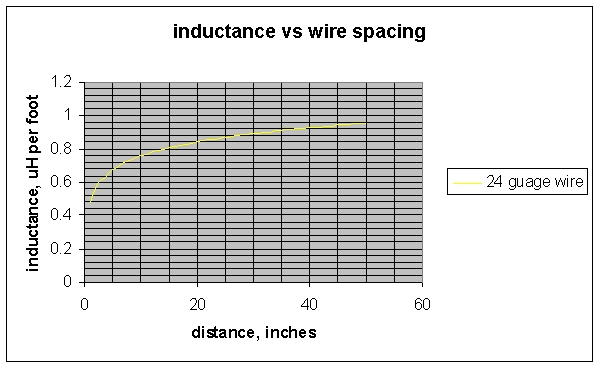

John, I assume distance = conductor length in your graph below, not conductor spacing which I take as 24 AWG.
For my sub nanohenry resistors, I do exactly what you say, but I do so by distributing the current through two arrays of interleaved resistors. While there is still magnetic field, the total stored energy is drastically reduced.
John
Very interesting... Could you explain this in more detail?
X axis is physical distance between the two parallel conductors. It can never be less than the diameter of a 24 awg wire in that graph. My apologies for not labelling the graph very clearly. I had trouble even finding it on my computer, it was from 2006.
If you have one coil and put current in it, you get an inductance. If you have two coils and put half the current in each, you get half the overall stored energy, so the system inductance is half..Very interesting... Could you explain this in more detail?
E = 1/2 L I^2. Half current is quarter stored energy.

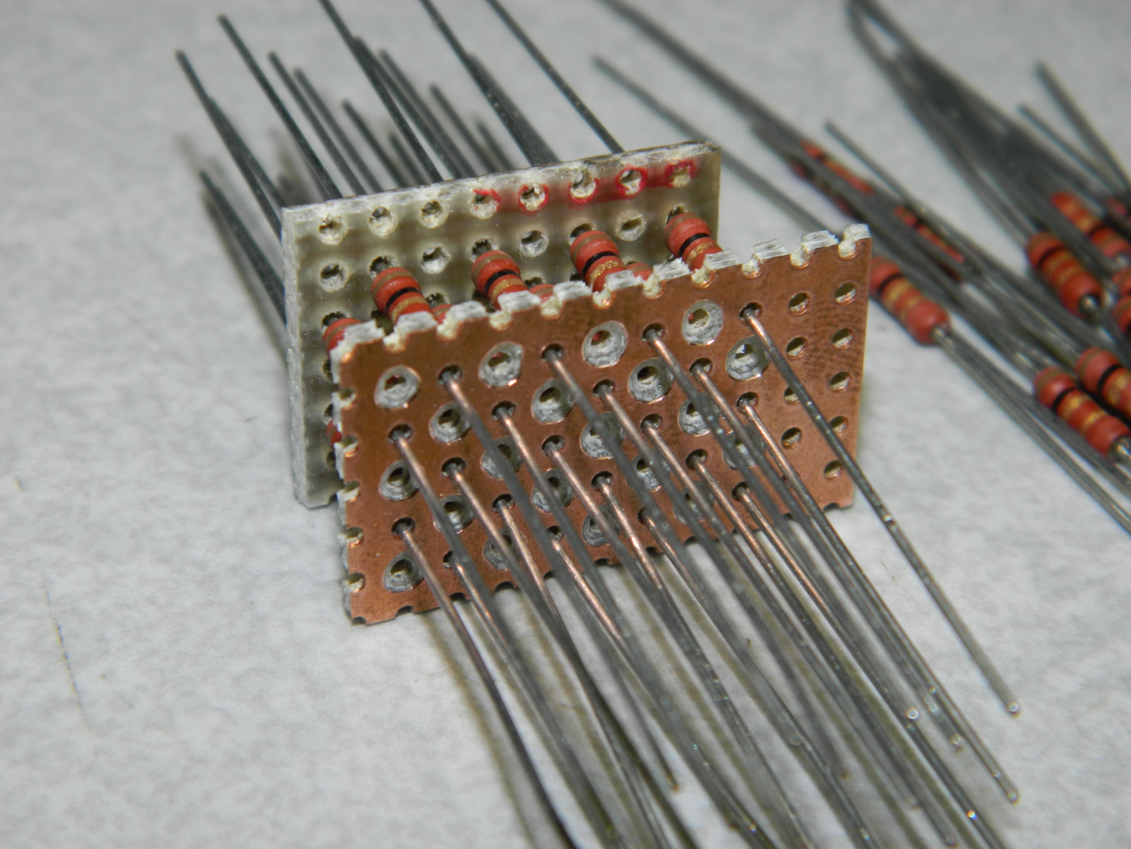

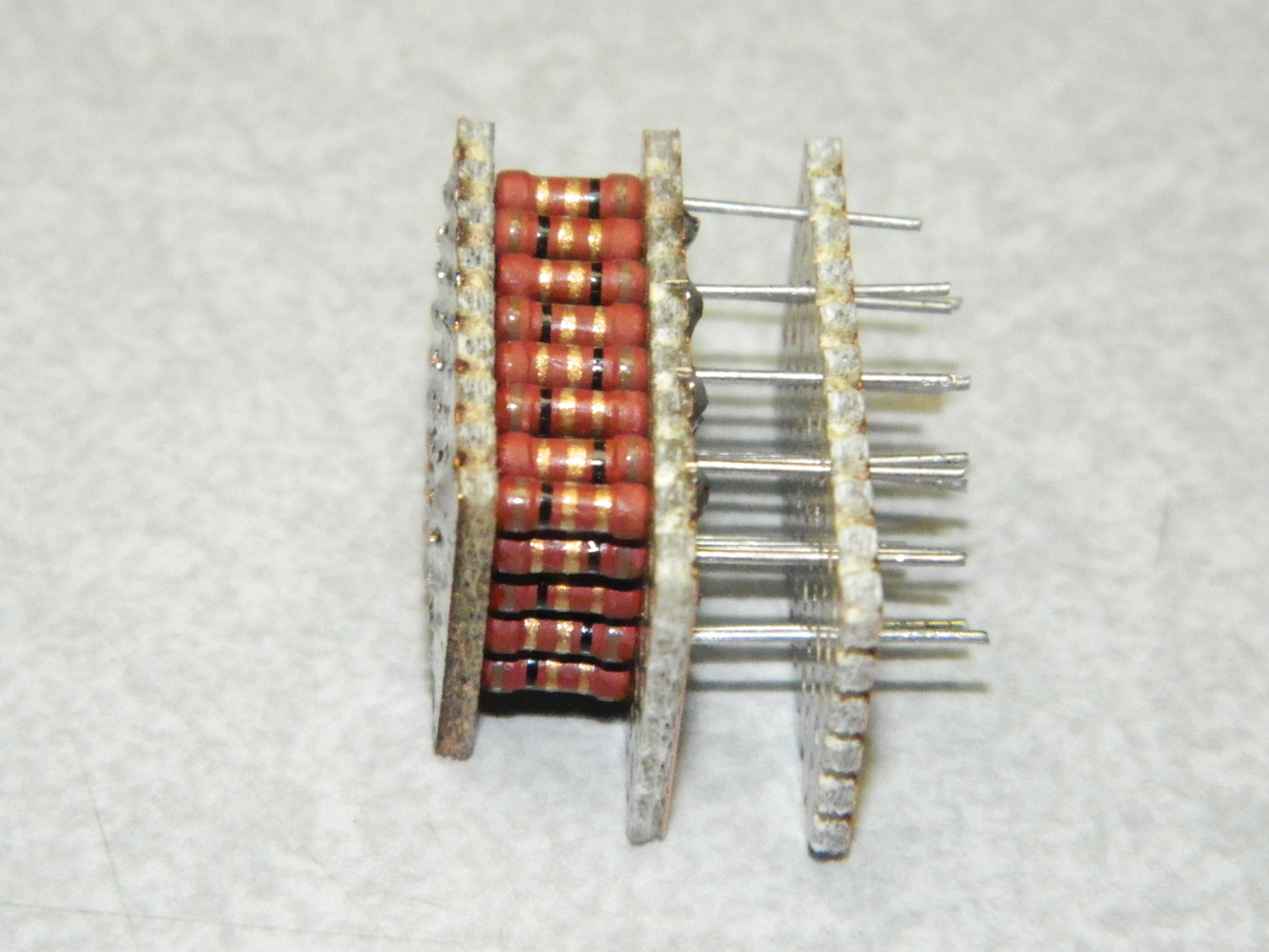

If you take cat5e and measure the inductance of one pair shorted at the end, say ten feet long, you get an inductance. If you parallel a second pair in the cable, the inductance will be half one pair. If you parallel all four, the inductance will be one quarter.
If you could see the currents in the 4 pairs, you would see that overall the current is being cancelled because it's going through itself. The more cables you parallel, the lower the overall inductance becomes.
Now do the same with resistors..Here's a pic of one being assembled. Think of the current directions as per a chessboard, red one direction, black the other. In fact, I oriented the resistor markings to give a better picture of how the resistors connect. The perf on the far right, note that only half the leads go through to there. The center perf is the other connection. edit: oh, forgot. there are 40 resistors there.
The beauty of this is you can use two different values to create a divider, and there will be no mutual coupling across the lower value resistor.
I'm using a varient of this for my EDM pulse generator, the series resistor for the spark current limit being one set, the CVR for the current readback the other. nSec response with no circuit inductance or coupling to jam up the scope pics.
Edit: added the second pic to show how half the resistors will be soldered to the middle plate, they are loaded at this stage. I solder them first, clean the leads, then pull the far plate away and load the other half of the resistors. I then solder to the far plate, add the third plate that is missing in this view, and solder the balance of the leads to it.
