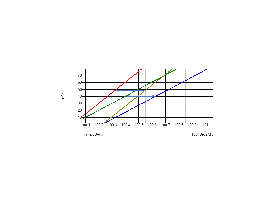

...and here is the simulation of a 50W amp (non-Miller) at 20kHz and 30kHz. The difference between the input and output signal is a time delay. The powerpoint arrow is the same length for both signals and shows 230 nS. I call this a delay, not a phase shift, as a phase shift is usually taken to vary with frequency (as per RC time constant).

Can you show how did you simulate this? I don't believe this is correct.

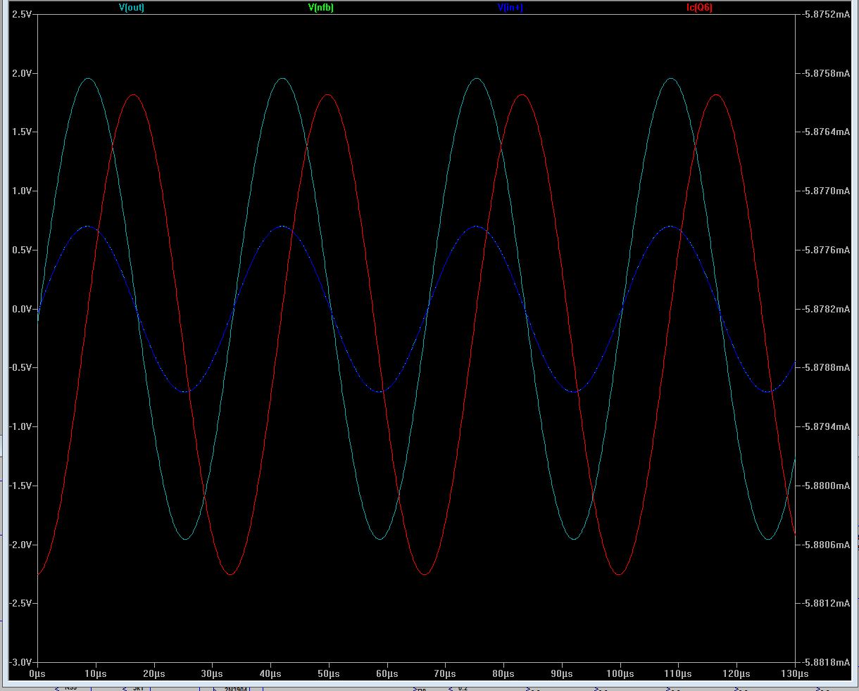

Here are my results... 1 KHz and 30 KHz.
Vas current in red, note the 90 degrees phase-shift on the current, the same 90 degrees you find in the loop gain of this circuit.
And the input and Feedback are spot on the same.
I have reduced Gain to app 6 DB in order to make a more illustrative plots where the apex's are clear.

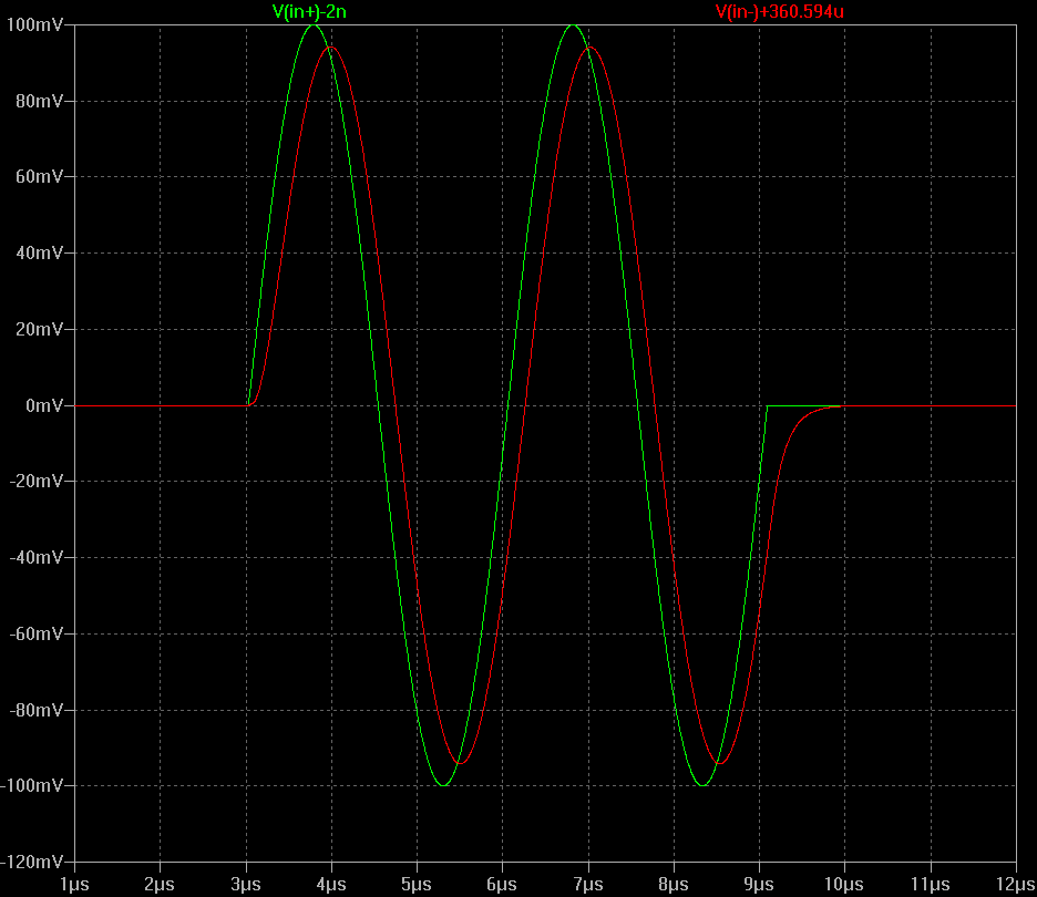

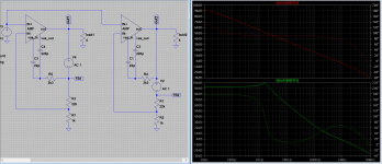

You have to make sure the DC is zero in the IN+ and IN- , I have -360.594uV of DC in the IN- so I compensate that by enter this ( V(in-)+360.594u ) in the plot, like in the first image. And then I measure the diference in time ( at the cross of zero ) between IN+ and IN- .

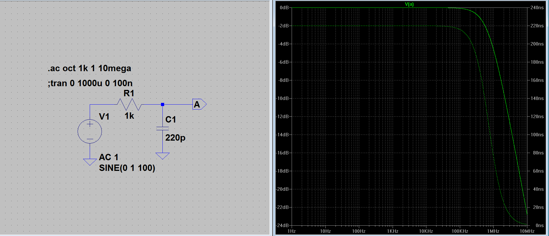

The delay of the simple miller and the TMC Amplifiers resemble the delay you have with a simple RC filter like this one in second picture.
In my amp I have 208nS at 10Hz, 2Khz, 20Khz, at 100Khz I have 207.5nS at 330Khz it is 201nS.

So in your opinion the LG probe should be connected like the circuit on the right, that gives the OL gain like the simple miller ?

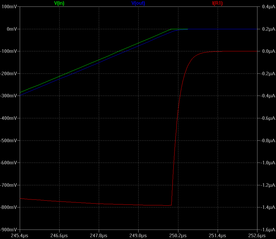

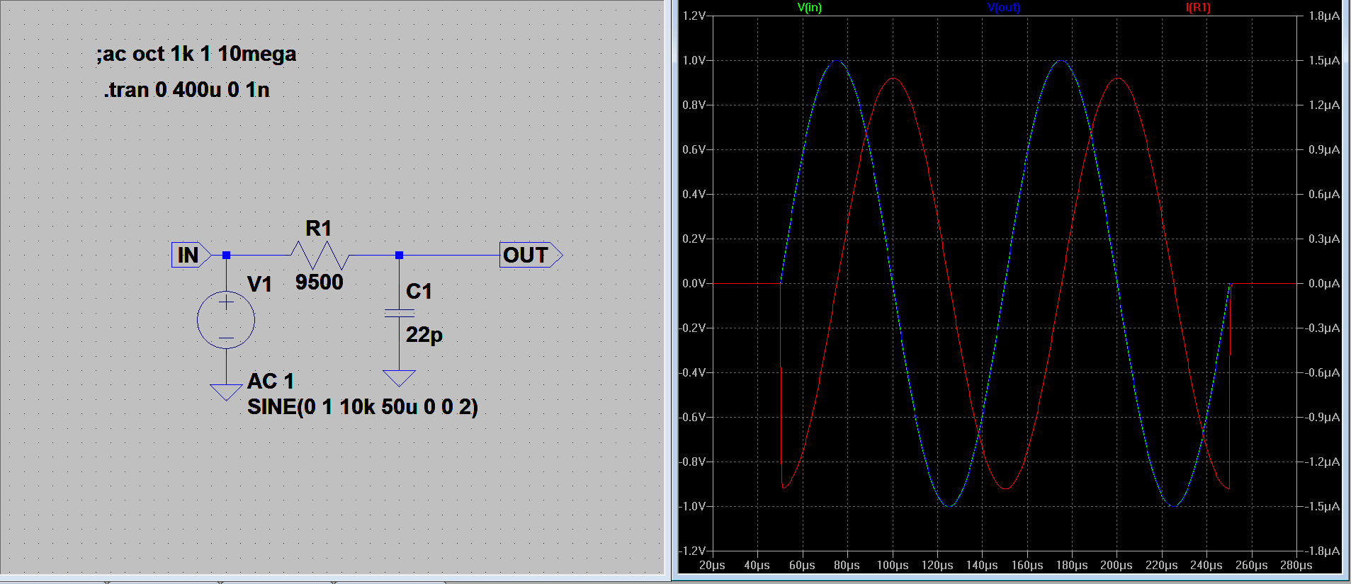

See this images of the impulse like I use for the Amplifier, but this time in a simple RC circuit.
The output is delayed by 208nS in all the audio band, and the current in R has the same behavior than the current on the VAS transistor.
In the amplifier the capacitor is the miller cap .
It is very similar to the feedback amplifier response

I used a very simple simulation of a (non-Miller) amplifier. The input signal is not delayed with any RC network. The output is through a resistive divider load (7.75 ohms in series with 0.25 ohms) with a fine adjustment so that the output voltage is measured at 1/G where G is the gain of the amp) so that the plotted voltages are the same.
There is no Miller delay capacitor but there is an inclusive compensation capacitor.
RC networks give a very nearly constant delay (=R*C) at frequencies below where there is a significant phase shift, so you only start to see the phase shift significantly changing around f=1/(2pi RC). The inclusive compensation capacitor in my simulations was 22pF which in conjunction with 10k feedback resistor gives 220 nS - almost exactly the simulated delay.
