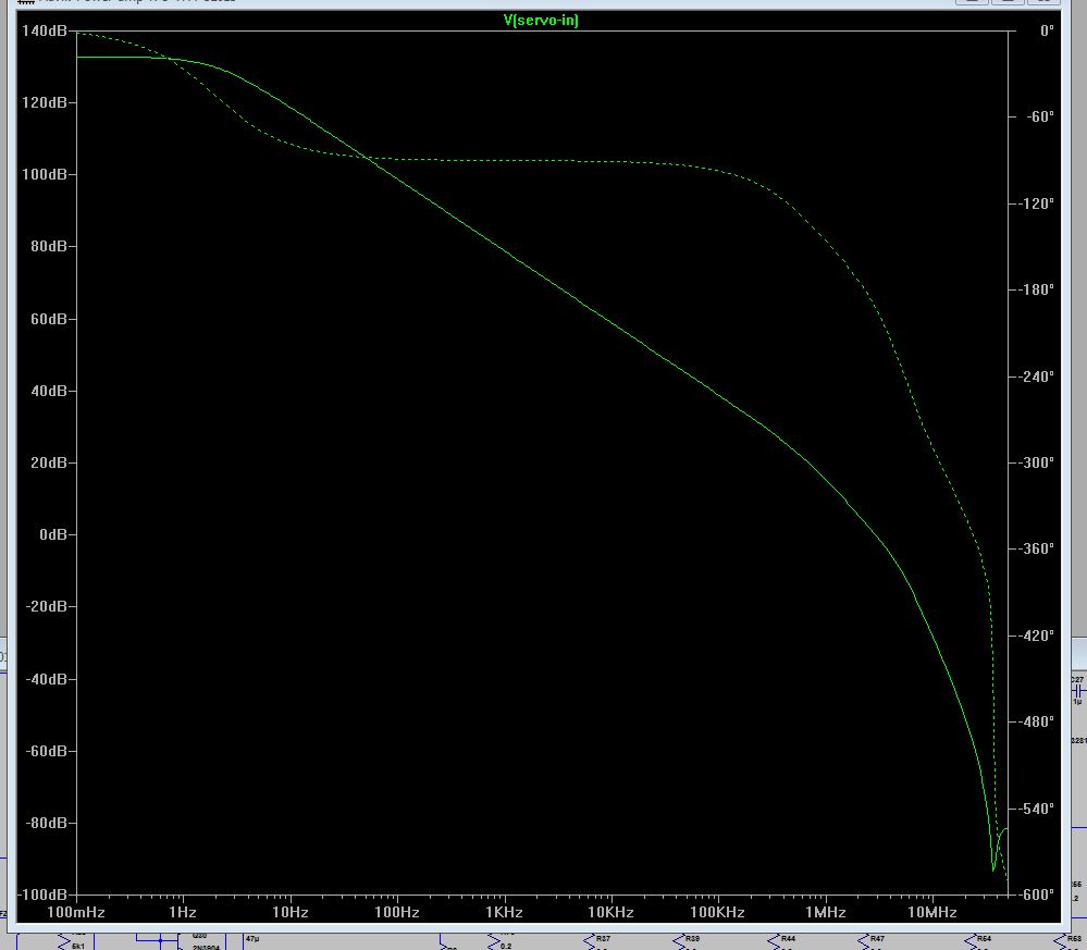

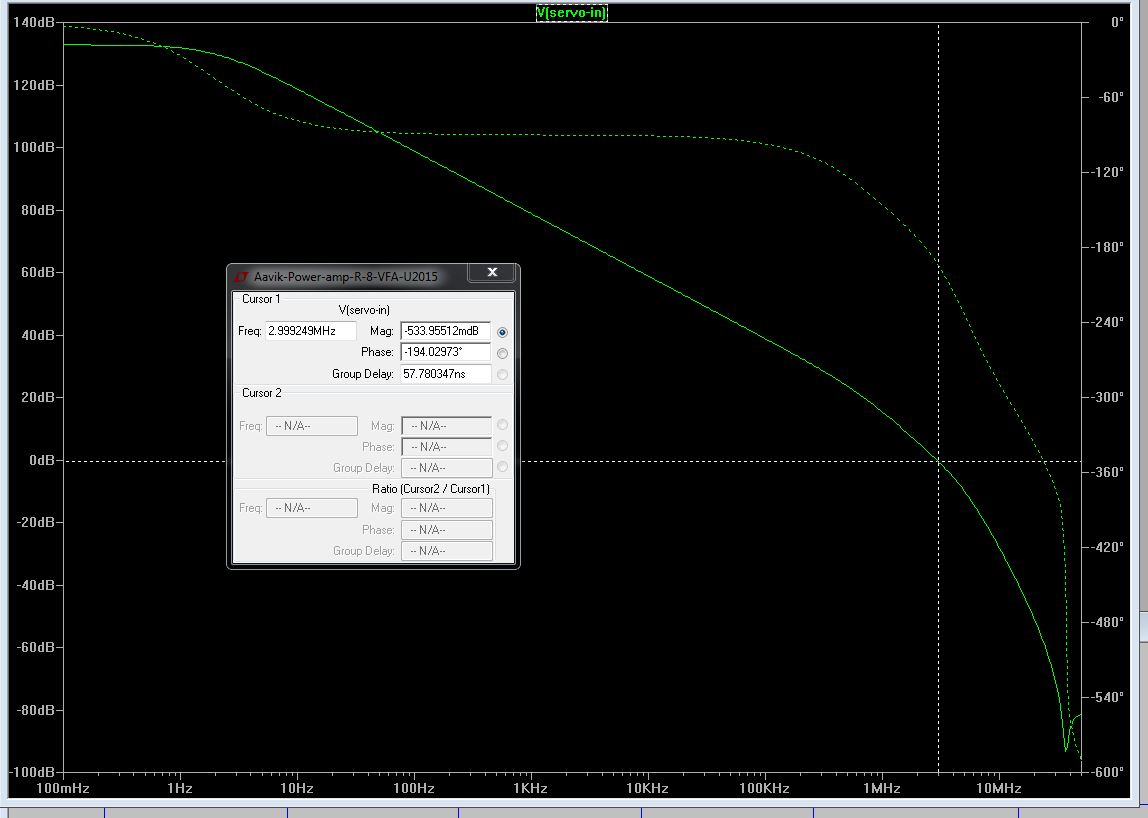

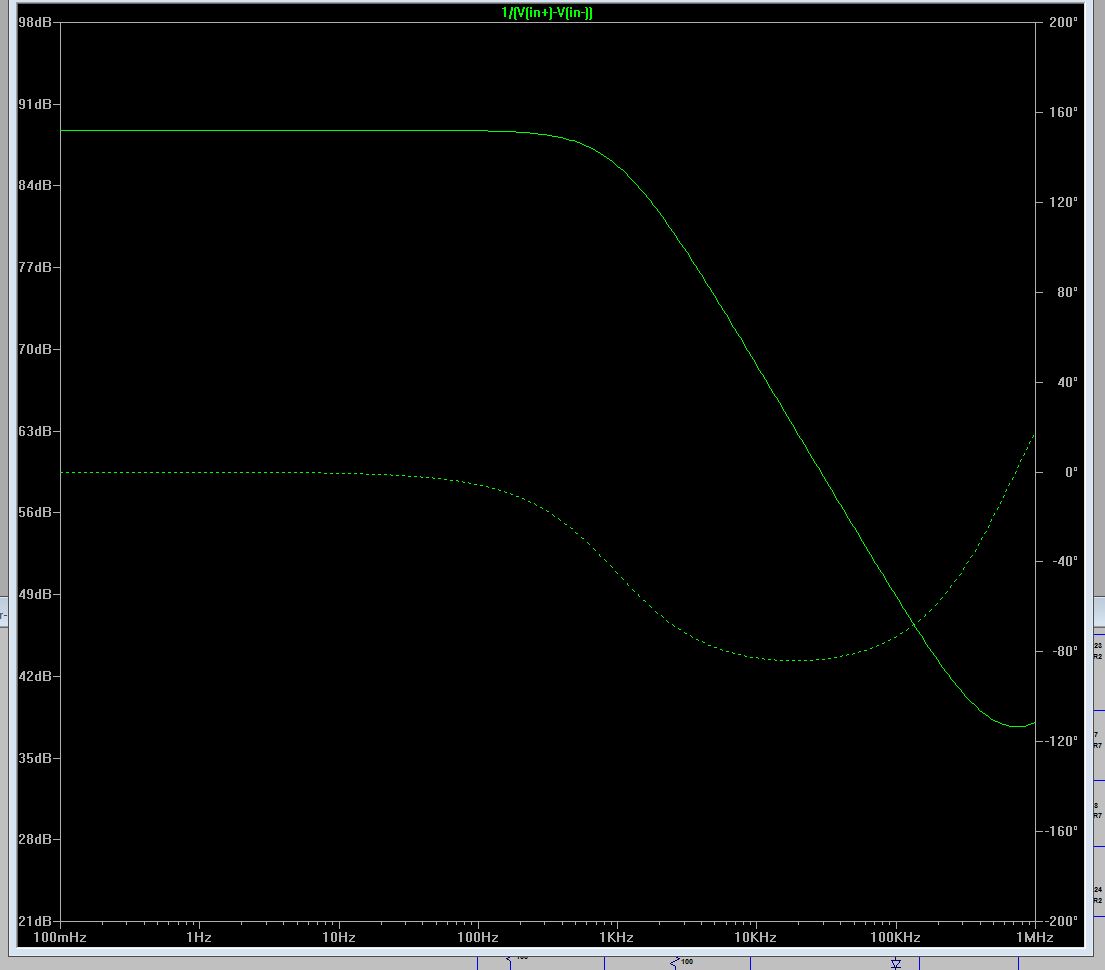

The objective was to try to understand how is the open loop of the TMC amplifier, because depending on including or not the inner feedback loop in the gain probe the outcome is very different.
The first image is the TMC with the inner miller loop included in the gain probe
the second image is with the resistor from the TMC network connected directly to the output of the amplifier and not included on the gain probe.
Sergio, there was discussion some years ago about TMC and how to simulate Loop Gain in other tread. I use Tian probe and and always include inner loop.
I also use the Tian probe for OLG as well, I tried your method, and the results by comparing inputs, is not really what the Tian probe shows, as I said you're looking at the excess gain, not the OLG, but still you see the effect of tmc, extra gain in the upper registers.
Your method is a method to find the Loopgain, the way you use the difference at the inputs is a good way to see the excess gain (the Loopgain). This is exactly what I said all along the circuit tries to create the lowest possible differential voltage, but it can only use its excess gain to do so. This is the reason why you see a good representation of the loopgain by looking at the differences at the input terminals.
Using the Loopgain 2 method in LT spice results in a curve that 27dB higer (in my case), which then must be the open loop gain.
For stability assessment I believe that you must have all compensations in place.

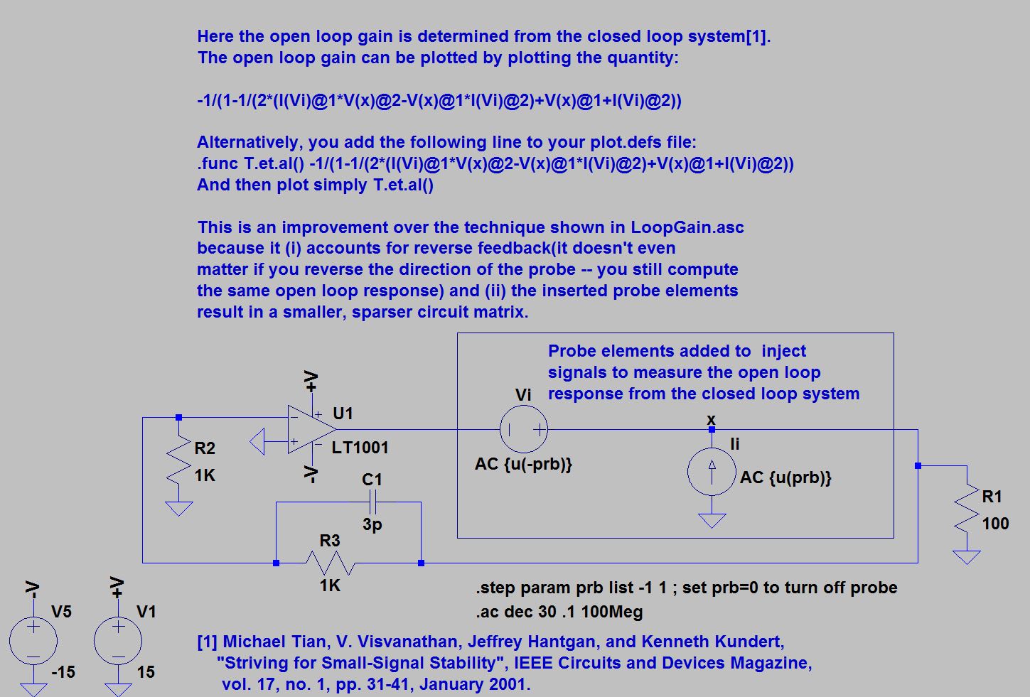

That is an error in LTspice example explanation. How could it show OLG if there is the feedback network in play? Try to change one of the feedback resistor and you will see that the gain changes.
Maybe because of the equation you have to insert in the plotline.

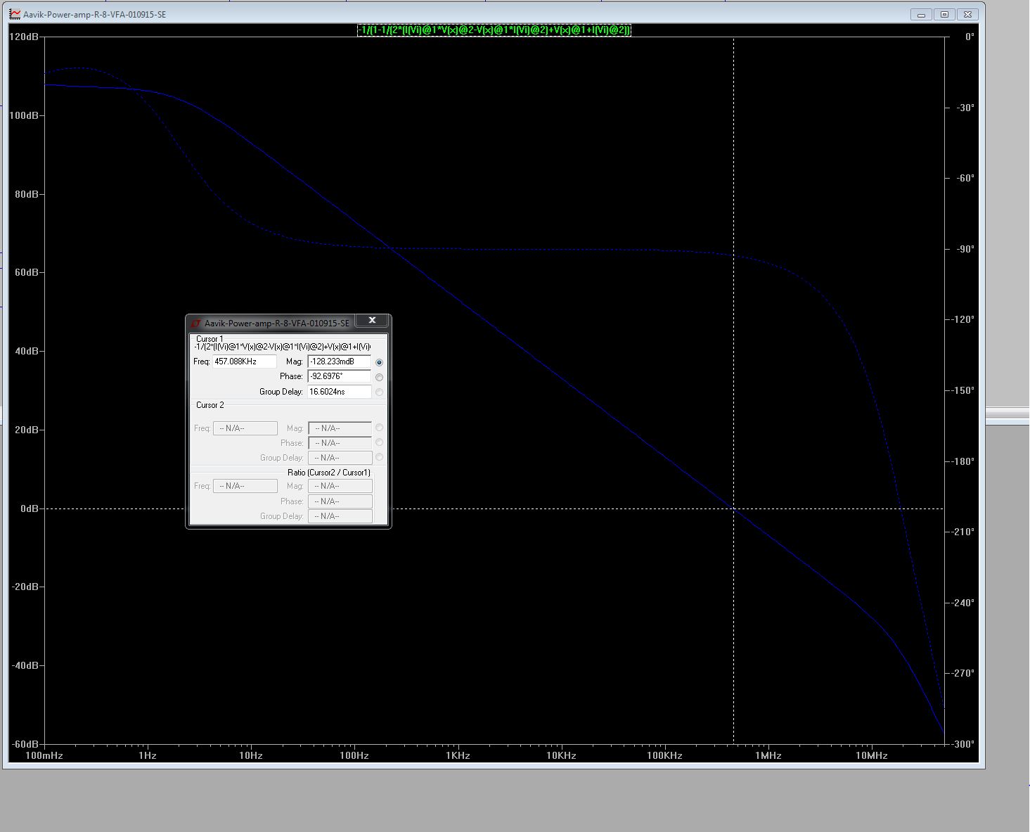

This is a quick an dirty way to determine the OLG, I have inserted a 1000GH coil in the loop, so DC is preserved and AC is broken.( this shifts the phase, so stability is harder to evaluate)
The loop Gain is also calculated using Sergios method.
It seems you're right and the LT-spice example is flawed. :-(
The two curves are very similar but shifted with the gain of the amplifier, The Phase is also shifted 90 degree on the plot where I have inserted a (100000GH) Coil. So I guess you have to deduct that from the plot, when using it for stability assessment. I have only one gain stage, so it would make sense that the OLG phase shift is around 90 where the gain goes to 1.
Then what is it Sergio is getting with his differential observations, it dosen't quite add up.. some gain is missing. Have to rethink the equation, I believe some division is missing.

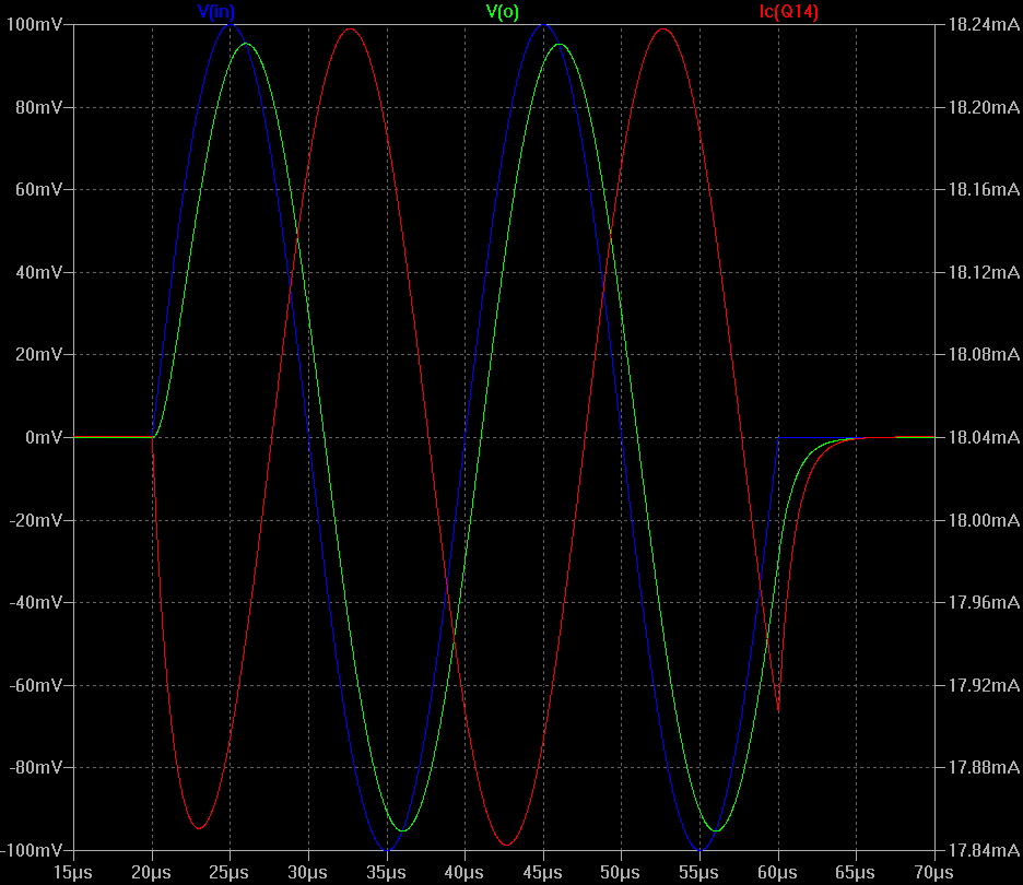

I have deliberately make the amplifier very slow ( 1us ) by change the miller cap to 100pf , and the impulse is a 50Khz sine .
The first image is the signal at the + input and the amplifier output.
The second image the current from the colector of the VAS transistor is also represented (in RED ).

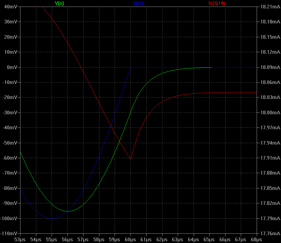

The third is a zoom of the END of the impulse, and here we can see that the current in the VAS transistor reacts immediately to the end of the impulse.
So the output is following the input with 1us of delay. Even if the amplifier is too slow the feedback correction is almost immediate.

Michael In the third picture #176 look at the moment the impulse stops.
Even that the input voltage is still higher than the output at the moment the impulse stops (30mv), the current in the vas stage is no longer decreasing but starts to increase.
And this goes against your claim that the amplifier always seek lowest possible difference.
But at the end the input and output will mach.
