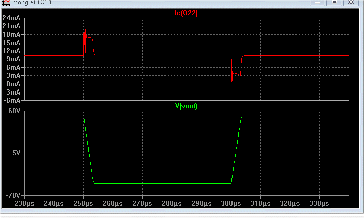

step response....
Absolutely. More so with a parasitic prone high current stage. 😀
OS

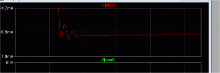

#2 - can even see the damped oscillation of the predriver/ccs node. But the resulting output is rounded.And, just a little overshoot w/capacitor load. "Fine tune" of the main driver basestopper is what makes for stability. 🙂 a high Ft main driver also makes things easier.
OS
Agree to filter the input, even if it is not real life, step response stimulus is another test that every amp should pass ...

I think you have to seprate parasitics and overall loop behaviour.
If I look att your plots above OS, I believe this is driver/output stage behaviour and you are taming parasitic issues, and adjusting the base stopper is one way to do this. But for slew rate and bandwidth limiting, I think those issues usually need a different approach.
I also absolutely agree that looking at step response behaviour gives a good indication of how the loop is performing.
