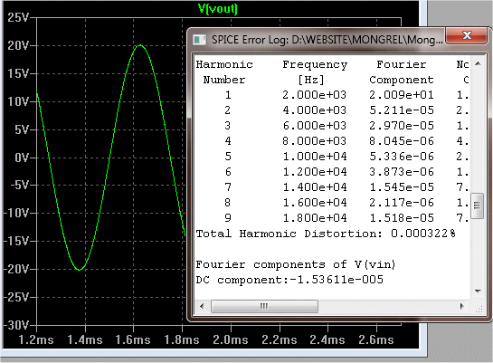

Holman said of the APT1 amp " create the circuit with the best linearity - then apply NFB".
This works out ... (below 1-2 ) same at 100k as 2k , no TMC, any load , simple circuit (APT-luxman-Cordell) PS - not a "blameless" - but better.

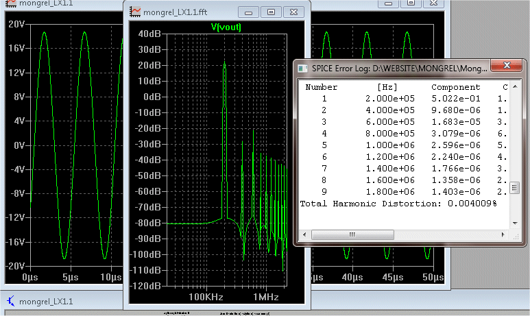

Amp starts to really decrease in output at 225khz. Still golden at 200k (.004%).
loss of 1 db here.
Input low pass filter is the most likely culprit.
Amp= luxman's green- led biased hawksford cascode , apt's diode clamps for controlled clip behavior, cordell's diamond triple with the sanken OP's as driver.
Higher Ft drivers and 10ma predriver bias make the triple stable even without the 150pf B-C driver stopper caps mentioned in SYN08's OPS thread. They are added regardless... to "make sure". Only 1 vbe - pre+ driver cancel perfectly on separate heatsink.

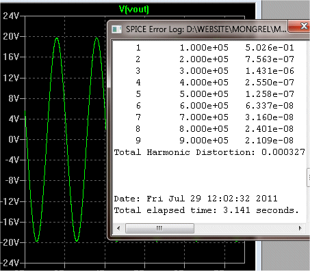

At 10 pair outputs/1R load , performance is similar. Perfect!!
PS - transient response is not as good as the LIN , only 40+ V/us.
loss of 1 db here.
I guess this is more of a question. Does bandwidth limiting decrease THD readings? It would kinda make sense that in your amp any distortion over 200khz gets reduced by the LPF of the amp. But it probably depends where the filtering occurs, the input filter probably dosnt do it but the feedback network does and the Cdom filter effects only the previous stages. (I noticed some of these effects during sims which gave better HF THD than LF THD which didnt make sense) Just something to be aware of.

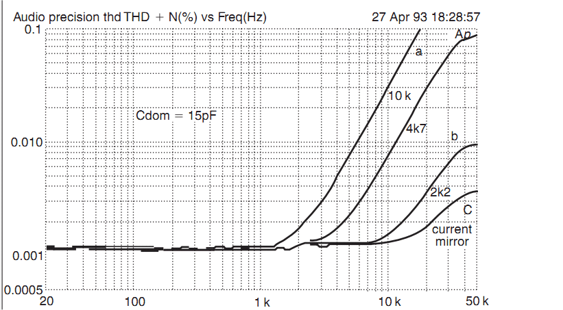

Most of D.self's plots (below) show higher or the same THD at LF , getting lower at 1-10k then a gradual to steep rise at 20-30k. actually , in simulation ... it IS the filter that adds distortion to the whole amp , as well as attenuating it.
Smaller CDOM will extend the bandwidth , but there can be a stabilty / THD "penalty". Larger cdom will lower the VAS impedance , but reduce bandwidth.
all tradeoffs..
Passive's are not nearly as "perfect" as semi's (actually ... neither are ).
