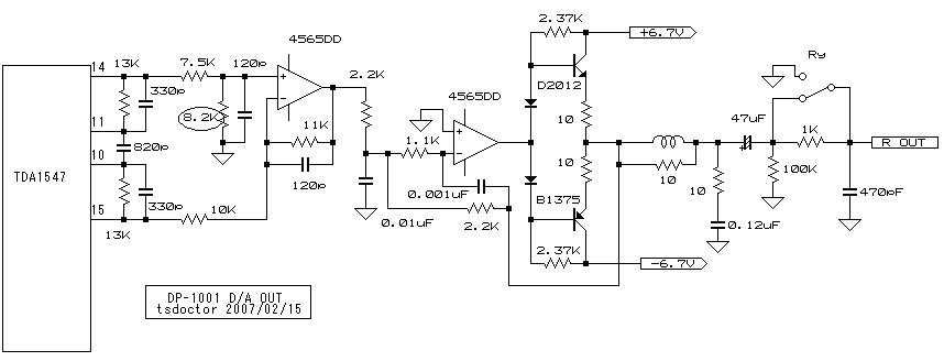

I have talked to SY. I agree with him, there should be no ringing when everything is correct constructed.
And I have read the article from Analog Devices about opamp driving capacitive loads etc.
Analog Devices: Analog Dialogue: Ask The Applications Engineer - 25
Here is the output stage of my CD-Player. I think nothing is wrong constructed.
I have tried to simulate it in Texas Instruments Tina. Input has been a 1 volt step response
but something has been wrong connected, the output voltage has been to low.
I have used the RC4559 instead of the NJM4565.
Does Tina use macro models of the opamps?
Is PSpice better in this case? Sorry, I haven't got Pspice.

Free Tina macro model for few opamps, and IC's are usable I like to use UC3844 sim than using real designing.

Well, you can have too much feedback in the sense that you can make the circuit unstable. But I believe Bruno meant that the higher you can make the feedback factor, and still remain stable, the better, objectively, your circuit will perform.
