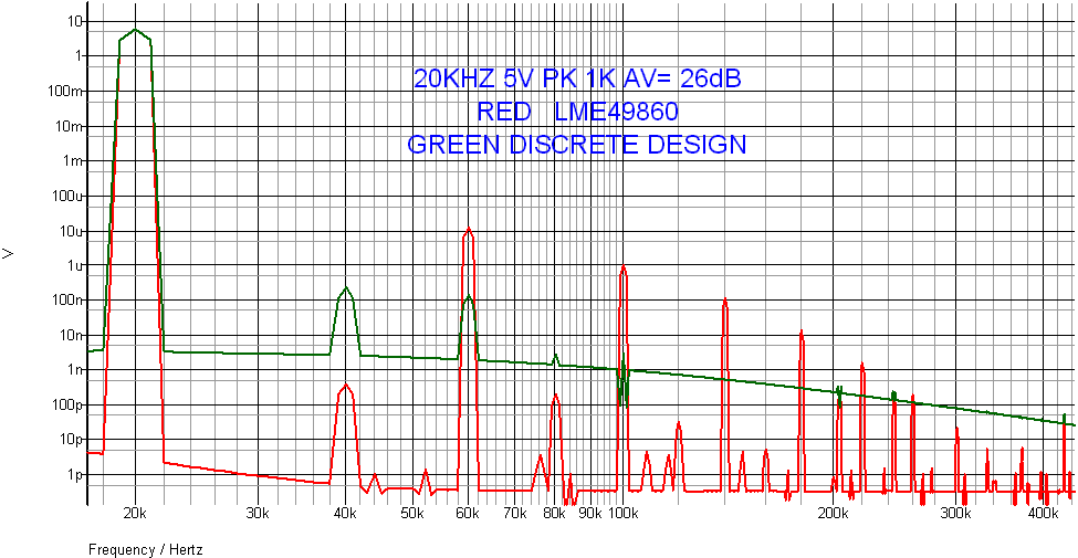

At lower frequency , the LME49860 has THD at 0.1ppm/1khz ,
wich is in the datasheet range , but still higher than the one
of the discrete design , although not as dramatically as at 20khz.
There must be some analog dithering going on in the discrete ... 🙂
Who knows ?...
More simply , the discrete has better intrinsical linearity
despite its 143db OLG that would imply a low THD thanks only to GNFB.

Thank you for putting up another measurement. I really like to look at stuff like this and try to figure out what is going on. There is a question though I have with regard to the two measurements in order to get a better understanding.
It has to do with the noise floor. The two measurements of the opamp seem to connect, give or take. However, for the discrete, the noisefloor appears to jump > two orders of magnitude.
Another interesting observation that could be made from the latest measurement is that the opamp creates inverse harmonics. That is, at harmonic intervals it lowers the noise floor.

The apparant difference in noise floor is just a convergence matter,
as i simulated using same number of cycles and same step, but the discrete has more
nodes to compute , so the precision is less than with the LME.
A discrete preamp using Bjts , also used as front end for an amplifier,
with higher voltage supply , though.
A quick comparison with a popular op amp :
kinda pointless without schematics, load conditions
you could be loading the op amp too heavily - composite structures with higher current output amp/buffer in the loop can greatly reduce distortion with op amp gain stages
for DAC I/V specifically the current is defined, and the output Z of the op amp is important so "low Z" buffers in the loop have been recommended in DAC datasheets for nearly a long as monlithic op amps, DAC have existed ~40 years now
THD20 can also be less useful if comparing a "high gain" op amp to a "flat loop gain" circuit - the 20KHz harmonic distortion products aren't themselves audible - only the IMD difference products with multiones, complex signals that "fold down" into the audio frequency range are directly audible
the "high gain" circuit can reduce the audio frequency IMD differences below 20 KHz by the excess loop gain

Ahhh. But Wahab, you need an apples to apples comparison. Drop you discrete design rails to the same as the opamp - maybe then it will not be as good.
I did a lot of simulation work on a CFA design and got to <<1ppm at 20KHz, but I used +-25V rails. As soon as I dropped them to +-15, it did not performa nearly as well. The high rails help to mitigate Early effect distortion.
It s written on the graphs that load is 1K.
Scematics are basicals non inverting configurations.

Agree that 20khz THD is more or less meaningfull, 10KHZ being the
most relevant , still , with only one resisual in the audio band.
IMD should be within THD numbers, but will check neverless..
Hi Bonsai
Only a version i use as amp front end has high voltage rails, +-28V.
The line preamps in the sims , including the LME, are supplied with +-20V.
The discrete design being a symmetrical differential , this should
tame down the legend that single ended differential topologies,
aka blameless, are better in matter of THD distribution..🙂
