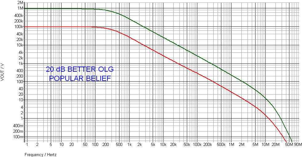

The challenge for the designer is to have high OL BW AND high OL gain. But remember, if one opamp has 10Hz OLBW and 40dB OLG at 5kHz, and the other has 1kHz OLBW and the same 40dB OLG at 5kHz, they have the same performance at 5kHz. They even have the same performance at 1kHz. Only below, say 100Hz, does the first one have better performance.

"Modern" op amps have the benefit of better performing transistors
due to way more refined processes that allow higher DC OLG mainly..
If you look at the 5532 OLG/frequency diagram, you ll see that modern
circuits have just extended the low frequency gain below the 5532
1khz OLG , not for the full audio range.
Most modern circuits will have a nearby OLG above 1KHZ , just look
at the famed OPA2134 OLG at 20khz , it is barely better if not worse
than the one of the ancestor while the OP627 doesnt do wonders as well
in this respect, so the 40/50db figure is quite discutable on an audio POW.
Are u sure about all modern opamps ? LME49860 has almost 80dB at 10khz, the same AD797.
The difference betwen 5532 and OPA2134 reside from the input stage and not from the OLG at 10khz (60dB).

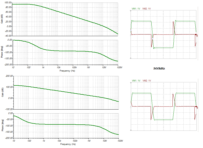

No, i don't confuse them. The voltage in my example was constant, so ,in that situation, the slew-rate-ul and the frecvency are directly related between them .
If my example is unrealistic, can you present us a realistic version ? 🙂 The only diference between my example and reality is the parasitic capacitance over the feedback resistor, which help you to have a stable circuit in real life. But..... it is posible to have a few resistors in series in a feedback path, and the parasitic capacitance to lowering at the level where u will have oscillations or ringing.
Wahab , because are "most" and not "all" my conclusion is that : u can not know which was the intentions of the designer. Maybe not OLG was first priority. 😉

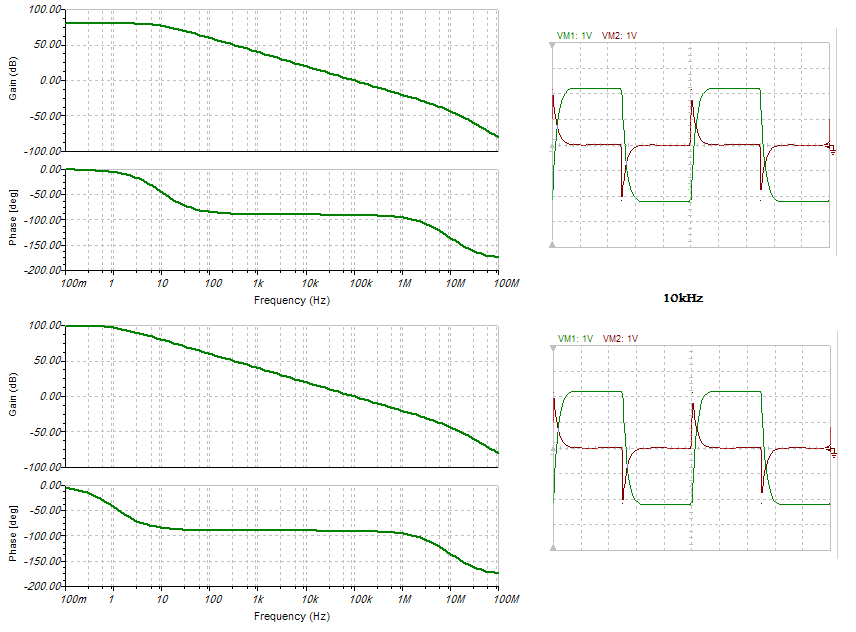

Ah.. again. Correct for single pole models, where no overshoot nor oscillations.
There is no challenge in single pole theory.
Then in real it also not like that if they have same 2nd pole at 10MHz, the one will be more stable than the other, except one has its 2nd pole moved to 1Ghz with SOI technology or similar.

Yes, like that. Higher OLG is higher overshoot, because from that graph they have the same 2nd pole at 10MHz. They aren't the same performance, while low THD not always coming from higher NFB, but also its own linearity.
OOps.., I am simulating it again with amplifier and I can't reach the same BW after increasing OLG except compensate it. The result is it slower, same as the first result, and overshoot reduced after compensated.
But something very strange here. When I try with only opamp (by modify its model) instead of with amplifier, it is very slow even for 10kHz, and same performance result.
