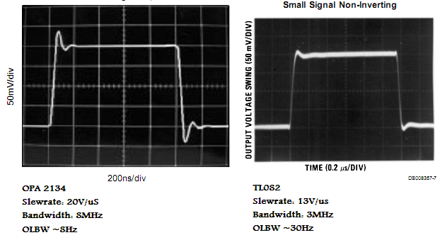

Here are some pic from OPAmp datasheet, OPA 2134 isn't even better than TL082 for buffering DAC, and may be NJM4565 has better response also better current for driving capacitive loads for passive filtering. Sadly NJM datasheet just too simple.

Slow is about its response. When they always work in OL, right? Then OL phase shift is used, it is phase difference between input and output by amp lagging.
@ChPlus
What not follow Hilbert curve you means?
What it the point of your post? What are you demonstrating by showing the pulse response of these opamps?
Do you realise that for audio signals these responses follow any possible audio transient exactly to the nano second?

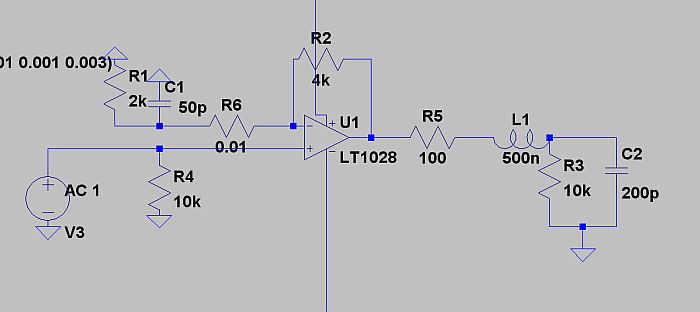

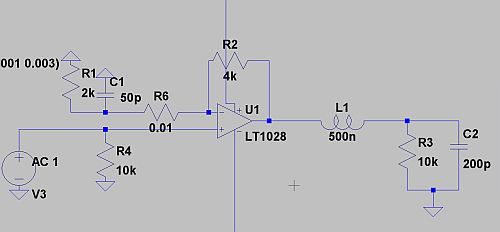

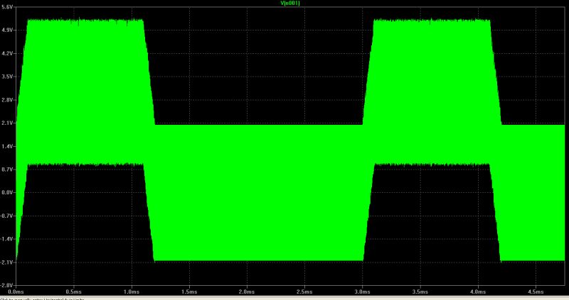

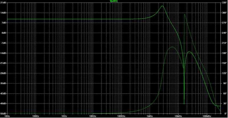

We can see here the "perfect" opamps myth. Here , we have a standard, real implementation of the goog opamp, LT1028. We have a little input parasitic capacitance, 50pF and a capacitive load, 200pF and 500nH inductive load. We have 1V and 100khz step signal at input of opamp.
Well, yes, you created an unstable circuit. What is your point? That electronic circuits can be unstable??
jan didden
Yes, that-s my point. In fact, the most important is it how you implement a real schematic. What u see in my first post, it is a real schematic with parasitic component. So, I was adding a 100ohm resistor to the output of a opamp and...... nothing... the circuit it is unstable again. We have a big problem in this moment.
