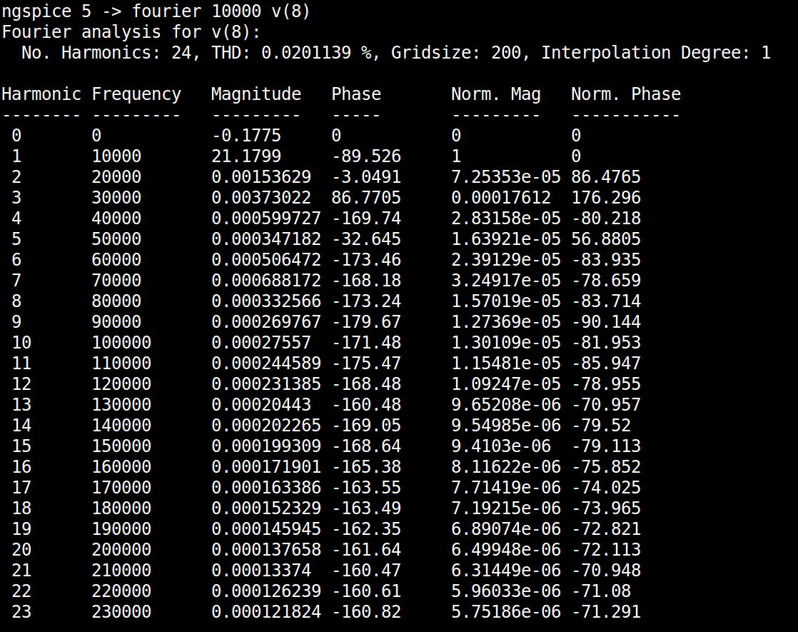

That plot was one with 60db OLG, single ended LTP and push pull VAS ... another with the most extreme example similar to this is the "littlefish amp"
A HiFi Power Amp
It also has a similar spectra (single ltp - comp. VAS) BUT, with much higher OLG (110+db) and lower THD.
I am not sure of the exact mechanism , but these amps also "hold" very low thd out to 100k+ instead of the sharper rise at or just above the audio spectrum.

I would suspect that the low THD out to HF is primarily due to two reasons.
Low open loop distortion to start with
High loop gain.
How much feedback have you got at 100khz?

THD vs Gain
Yes, I haven't found yet another way to push it to the limit ...
1) OL 90db gain THD
2) Closed loop THD
3) FB profile

Been working on a quite simple amplifier for a period.. the circuit seems to cancel all higher order distortions... OL-bandwith is 3db at 20 KHz open loop gain is 72 dB.. distortioan at 1KHz +-5V is respectable low:
armonic Frequency Fourier Normalized Phase Normalized
Number [Hz] Component Component [degree] Phase [deg]
1 1.000e+03 3.915e+00 1.000e+00 -5.59° 0.00°
2 2.000e+03 5.113e-03 1.306e-03 66.77° 72.37°
3 3.000e+03 7.762e-06 1.983e-06 -150.42° -144.83°
4 4.000e+03 1.509e-05 3.854e-06 -113.70° -108.10°
5 5.000e+03 3.552e-06 9.071e-07 -47.56° -41.96°
6 6.000e+03 2.674e-06 6.829e-07 -178.23° -172.64°
7 7.000e+03 2.405e-06 6.142e-07 -146.73° -141.14°
8 8.000e+03 1.702e-06 4.347e-07 169.37° 174.97°
9 9.000e+03 2.358e-06 6.022e-07 -150.68° -145.08°
Total Harmonic Distortion: 0.130606%
Note that the sole contribution tor the distortion is 2.order.. others are suppressed by a factor of more than 1000.
and with gain set at 30 dB it retains this distortion profile, but at vanishing low levels..
The amp slews at 70V/us...and totally stable into any Resistance/capacitance one can imagine...
