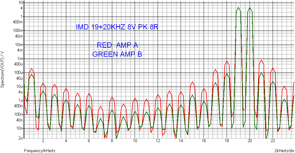

there is ~5.5 dB gain difference @20KHz - you are saying that explains the 30 dB change in 1 KHz IMD ?
the sim could tweak the GBW as well to get better than 1 dB match of 19,20 KHz
care to make a prediction about how much that would affect the results ?
the sim software is free

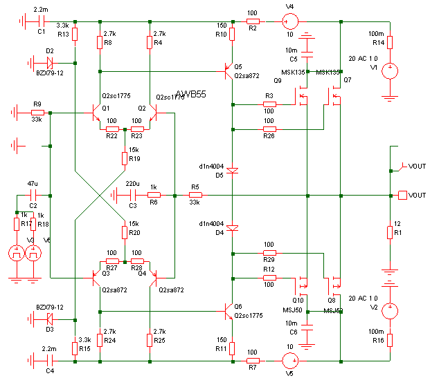

Even your schematic is simple, there s quite a big number of parameters
that are to be took account of.
I dont think that 5.5 db better loop gain at 20khz could explain
the 29db better figure , unless this is the increased loop gain of
a compensated amp wich would display nearby OLG at high frequency
by the virtue of a tighter NFB enclosing a local loop.
The local loop would then have better linearity , but then , the increased
GNFB + increased local NFB ratios should be equal to about 29db.
This is what transpired of my sims, that high freq. loop gain, or
slew rate, wich is the same in term of GBW product , must be increased
at the frequencies wich are intermodulating.

jcx,df96 your are correct about theory, I was self cheated by wahab reasoning, IMD pollution is about -70db (at audio, thanks to the NFB) in fairly good amps, shame on me
[snip]It is the non linearity at 20khz that is producing this IMD , and to reduce it , more linearity, i.e, more loop gain, at 20khz is necessary.
I believe you are lumping a few different things together.
To reduce the generation of IMD at 20kHz, you need more linearity at 20kHz, not loop gain. More loopgain at 20kHz (turned into feedback) would reduce anything at 20kHz that is not in the input signal. Clearly, the 19+20kHz signals are in the input so feedback doesn't decrease them.
To reduce the resulting 1kHz IMD product, you need loop gain turned into feedback at 1kHz.

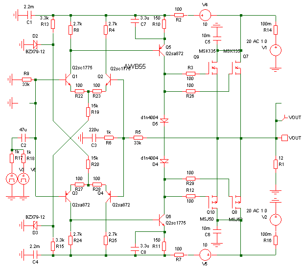

Here a practical exemple using a simple topology.
The amp B has its OLG increased at frequencies that are above
1khz , compared with the reference amp A wich display about the same
OLG at 1Khz but lower OLG at 20khz;
Since the amp A OLG is increased by reducing the emitter degeneration
of the VAS in AC mode using a capacitor, we can assume that lower
degeneration means less linear VAS.
The OLG figures shows that amp B has not a iota of gain increase at 1khz ,
but when looking at the IMD figures, what a surprise , the IMD product
at 1khz is reduced as well , even there s no increase in loop gain at 1khz.
So clearly , better linearity consequent to a higher OLG at 20khz has reduced
the low frequency unwanted by product of 19/20khz intermodulation.

You are not comparing like with like. Increasing the OLG at 20KHz means that the signal in the early stages of the amp is smaller, so the non-linearity (e.g. in the LTP) has less effect. You are generating less 1kHz, not suppressing it better. Obviously, distortion depends on signal level. If it turned out that all the distortion was happening in the output stage then your circuit change would leave the 1kHz level unchanged.wahab said:Here a practical exemple using a simple topology.
So your circuit does show something interesting: a significant part of your distortion is being generated before the output stage. Given that the output is a follower this is not too surprising.
Wahab
Interesting AB comparison.
It seems to me that, at least in part, increasing the gain at 20Khz at the VAS results in less voltage swing (and distortion generation) at the input stage. I know this is obvious but its a slightly view as is being discussed, and at least shows the difficulty in trying to isolate effects to a single attribute.
