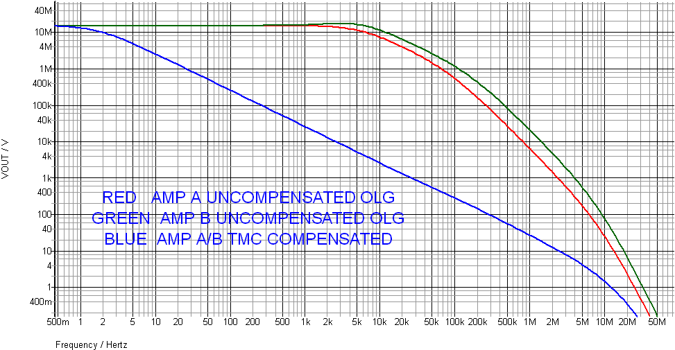

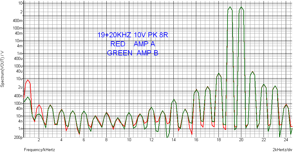

Using the topology displayed a few post earlier , an insight
about IMD , wich is quite surprising.
The same amp is used, albeit with OLG dramatically increased ,
as displayed by the graph below.
Amp B display about 5db more OLG than amp A at 20khz,
but strictly the same OLG at 1khz.
The two variants are then compensated using a light TMC.
The resulting IMD 1khz by product with a 19/20khz input signal
is quite astonishing when comparing the two amplifiers.
Variant B display about 30db less 1khz residual , despite having
only 5db better OLG at 20khz and no OLG increasement at 1khz.
Perhaps JCX , who obtained simular results but with 30 db OLG
increase at 1 khz and 5.3db at 20khz , can shed some light about
such an unexpected improvement.....😉
Anyway, there is more to be done to reduce IMD low frequency
residuals than increasing the OLG at these frequencies.

Again interesting simulations.
I'm never sure what it is meant by TMC implementation but if this is a local loop around the vas and output stage, your simulation may suggest that the dominate distortion source is vas+output stage. As you say the higher loop gain around this loop at these frequencies would account for the reduced lower distortion at the output. The earlier post is consistent with this but it is difficult to separate effects.

Interesting finding Wahab, and I think it is very important that we get to the bottom of this. We need a robust explanation as to why this is the case.
Since 1kHz is slap bang in the midband, we may well be looking at why (and this may be one of a number or sources) amplifiers have different sonic signatures.

Something is creating an HF rolloff. This is unlikely to be in the output stage, as followers have good HF performance (limited usually by stability, not frequency response). So whether the rolloff is caused by deliberate Miller compensation, or intrinsic capacitance, is quite irrelevant. The signal level in the output stage is the same. The signal level in the earlier stages is lower, so less distortion produced.wahab said:We cant make such a deduction since no miller compensation is used,

The relevant signal level in each case is not the input signal, but the signal level in each stage as that is what determines the distortion generated in each stage. Given that, it is difficult to compare like with like.
In a balanced circuit, even-order distortion (which is what we are looking at) depends critically on circuit balance as you are subtracting two big numbers from each other and looking at the difference. The only imbalance in your simulated circuit will be differences between PNP and NPN BJTs, which presumably have been chosen to be near complements. If your change has somehow improved the AC balance of the circuit then this will drastically reduce 1kHz IMD.
For example, if the distortion is being generated primarily in the VAS (quite likely) then local feedback around it (from TMC) will reduce distortion. Increasing the internal gain of this inner loop (by bypassing the VAS emitter resistor) will reduce distortion, and it will improve AC balance as the gain of this stage is then more closely determined by passive components (TMC) rather than BJT parameters. In real life it won't be quite so simple as you don't get perfect matching.
As I said, it is very difficult to compare like with like. Hence false conclusions can be drawn, which appear at first to conflict with feedback theory.

Indeed it does seem difficult (or impossible) to attribute the observations to a single parameter especially without knowing all the effects of the changes.
But it is fun and instructive to try and figure out whats going on, it seems reasonable that as has been mentioned, if the distortion is dominated by a source within the VAS+OS then the local TMC loop would reduce the resultant 1Khz product as it has significant loop gain at 1KHz. However it also seems likely that the TMC implementation may have significantly changed the VAS and or OS input impedance and output impedances. The effects of this may very well be significant and of course there may be others.
I think that part of your point is, if the above is correct then why did the first set of plots show a reduction in the 1KHz product when only the OLG at 20KHz was increased. But again, bypassing the degeneration resistors has more effects than just to increase the gain. The impedance changes mentioned above certainly apply here as well.
It would be interesting for me to see an ac sweep plot of both the input and output VAS currents for the different circuits.
