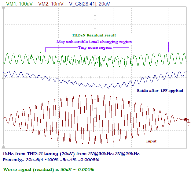

This THD+N from 29kHz+30kHz in va290. Well.. The loudspeaker seems really moving in 1kHz path, and 1kHz is not present at the input.
VA290 is only VAS stage and has less than 0.0001%THD @1khz (and may better than any VAS). Also simulation has best supplies. Dunno what really happen when real power amp has 1% or 5% of this IMD (that caused by vary of amplitude) is present.😀
Thanks anyway for this test.

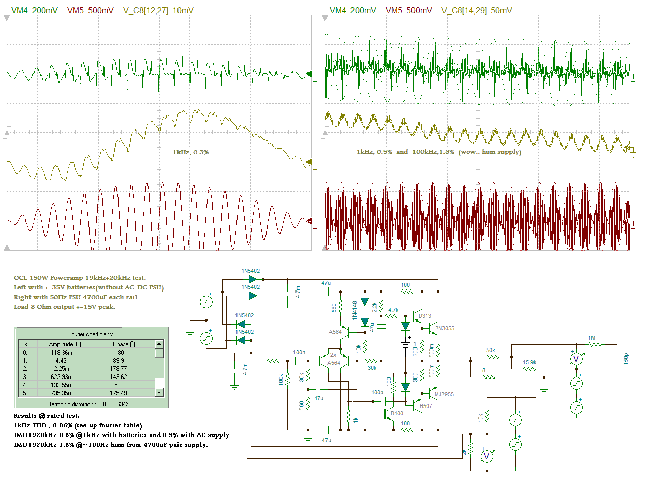

Here sims result of complete amplifier with both battery supply and AC supply.
This one has low feedback and its sounds warm but little noisy (distorted).
There is a way to combine strong feedback with no feedback, then strong feedback still could be used without damaging Imaging?, Sound stage? Without makes bad fatigues on ears. Any way, what people wanted isn't just same, but closest as real sound as possible is one acceptable goal.
I have my first rich sounded amp is from simple design, and I have my first clean amplifier with complex VAS (VA270). My first closest to natural sounds, with diodes and elcos ??

You should now try using real equipment to measure instead of the simulator, you going to find some pleasant surprises. 😉

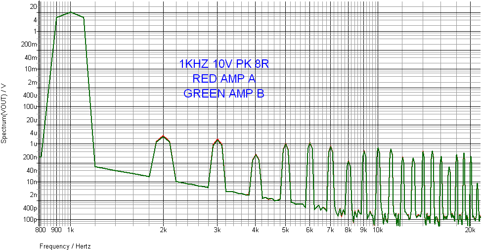

Can you show us a comparison of 1khz THD between the 2 amps?
THD at 1 khz seems almost the same.
