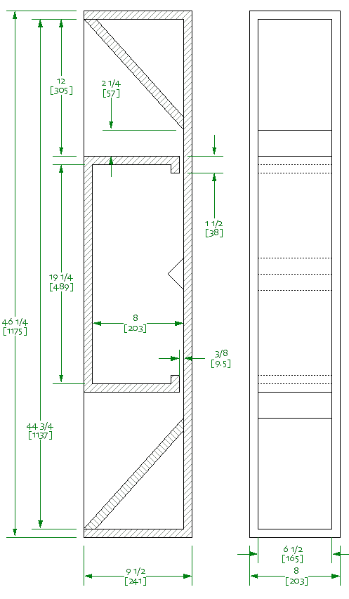

OK, I surrender. Once the data is in, I'll do a double-mouth Spawn box for the 138ES-R, as there seems to be some interest.
So, might as well ask in advance: what do you want? Trad. gain type long path, or short waveguide style enclosure? (& if the former, stepped or ~constant expansion, or a combination?) Focused or column style? As Dave reckons it's potentially one of the best units Fostex have made, it'd be a shame not to do it justice.

Re: Re: Spawn for FE138
I had to get the data from scott again -- an "accident" with some powerful magnets caused some "problems" with my laptop drive...
Here is the quick & nasty drawing...
dave

Hurray !!
You really made my day, Dave ! Thank you so much, i´m really happy now.
i allready thought, that some kind of "accident" causes the delay, (well, be
always careful, where you put those drivers...)
and they are smaller than i expect, at a hight of 117,5cm the driver position is at
58,75cm, that´s really low, maybe i should angle it a bit...
the sad thing is, that i´m allready out of money for this month, i´ll have to wait
another week, till i can buy some wood.
cheerio, Mirko

M_Balou said:i allready thought, that some kind of "accident" causes the delay, (well, be
Not actually speakers -- a pair of pmagnets with weird shape -- they jumped out of my hands inconienienty to on top of the laptop where the drive sits.
Yes. We are actually working thru (in private) some of these same details with the similar MBVR for the baby Feastrex.
dave
dave

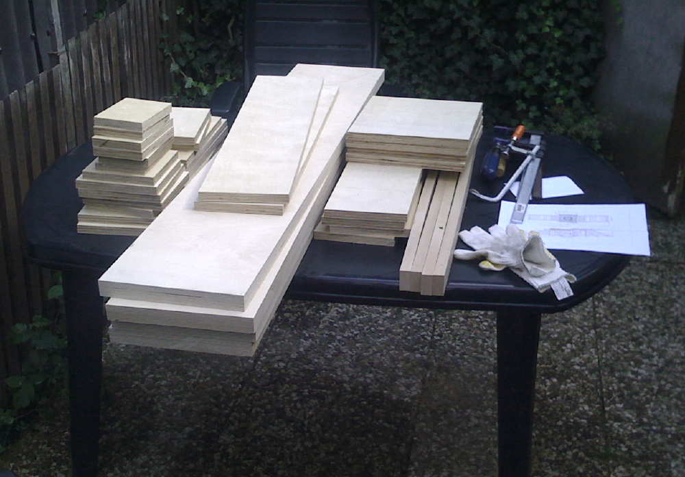

Hi Folks,
....I´m, Back !!
well, when was my last post ? 22nd of April ? Time goes by....
I had some severe real-life disturbances (the worst thing was, that my car
died and it took 10 week to clear things out, to get me a new one..)
but today i finally startet building the cabinets, i had bought the wood some 6 weeks ago
and this afternoon we did the first cuts on the sheets, if things go well, and we work at
this rate, i think we´re done in 3 weeks or so.
to Xavier:
congrats to your purchase !! Hm, did Koji-san really did say it was his last pair ?
well, i guessed earlir that the es-r would run out of stock in the late summer...
and you´re really wanna use such great gear ( the es-r´s + sex-amp) for
"just desktop-PC-Speaker" ?? that´s freakin´hilarious awsome !! i really would
like to know what super-stuff you have on your main system.
to Bermhard:
i´m glad to hear that you finally managed to put things together and get the
es-r´s singing...
äh, just out of curiousity: do you have one bass-driver per side ? in what kind enclosure ?
and do you mind telling me what amps do you use ( for main + sub).
and keep in mind, that i´ve noticed that the bass will improve and expand quite a lot
in the first 20 to 30 hours of the burnin in
more later....
Cheerio, Mirko

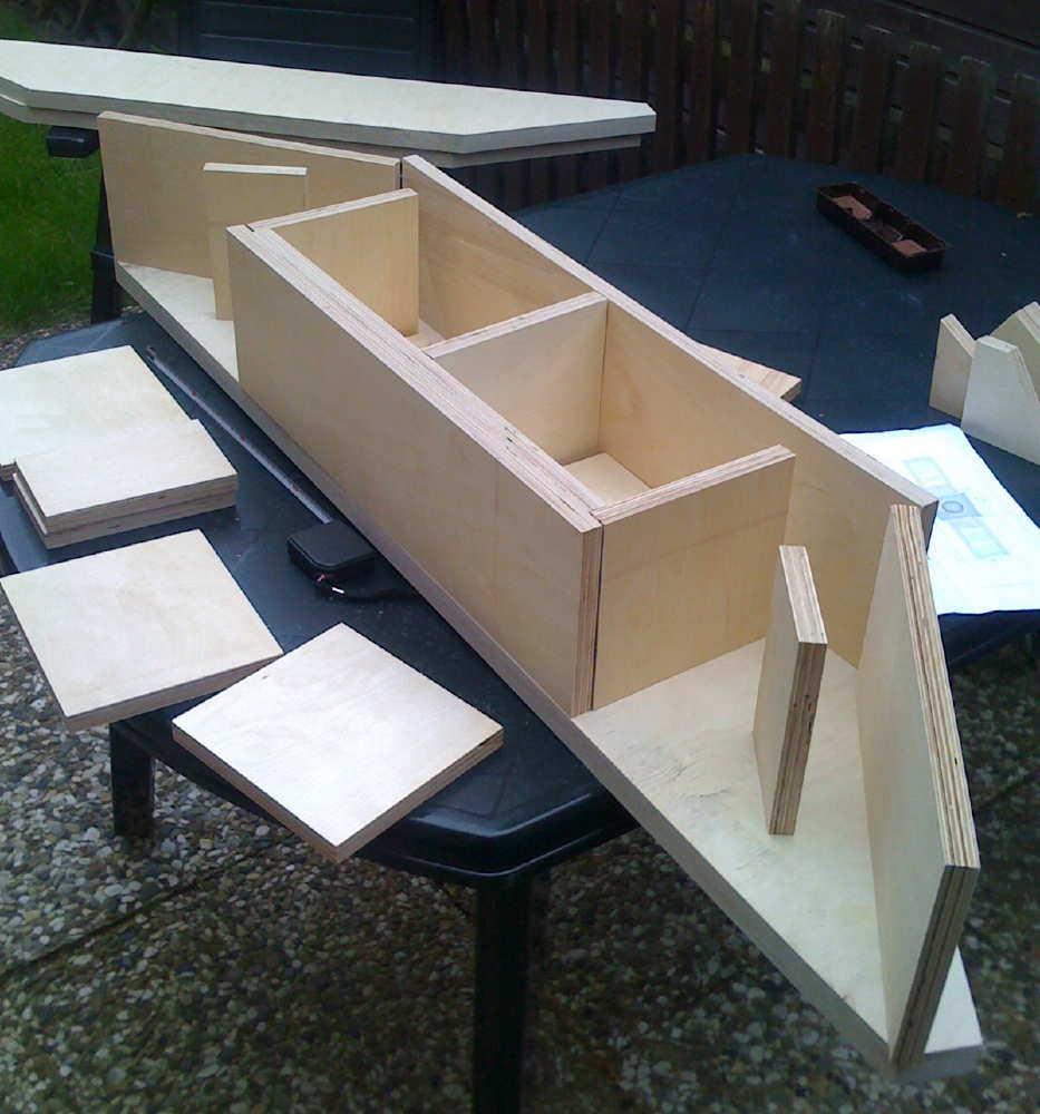

What are those angled pieces in the waveguides, which will cause severe turbulance & cause reflections back up into the throats?
Scottmoose said:severe turbulance & cause reflections back up into the throats?
They do need to be shaped at either end, but they proved critical to have in Maiko. They should be the tiniest bit wider than just to fit, so that they add tension to the side panels.
dave
No problem with that, but looking at the above picture, if the one closest to the camera is anything to go by, they're at completely the the wrong angle, which is what triggered my concern. 😱 Hopefully it was just a dry run of laying out the parts & no glue was involved.
Scottmoose said:No problem with that, but looking at the above picture, if the one closest to the camera is anything to go by, they're at completely the the wrong angle, which is what triggered my concern. 😱 Hopefully it was just a dry run of laying out the parts & no glue was involved.
You arw eight there... it needs to be aligned with the horn bisector and not the one side.
dave
yeah, of course these braces are not in a exact position.
i just stacked up the pieces to get a very first overview of what the
cabinets would look like in real.
