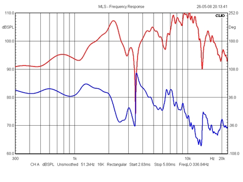

Probably nothing. I doubt I'd be in raptures over it either. That said, I've seen worse. Like this, from Lowther EX3s...
GM said:
Just looked at the factory response and knowing it' probably much worse than shown I don't see how anyone can listen to it for any length of time if not tone deaf due to such a broadband sawtooth HF response, so what am I missing that makes it so great?
GM

...look like the topography of Switzerland. I heard a version of a Lowther horn with two mouths, Audiovector or something like that. Ouch, two minutes and then went out from the room. There are better ones I assume, as there are users that are happy with them.
