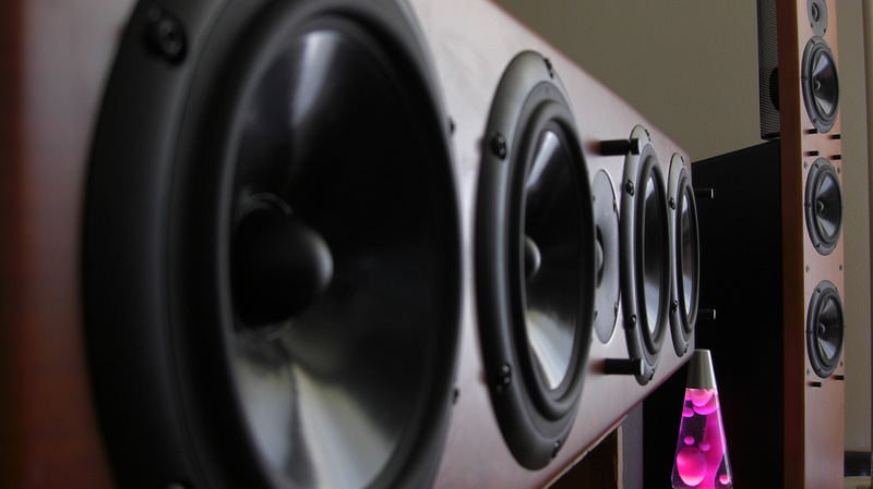

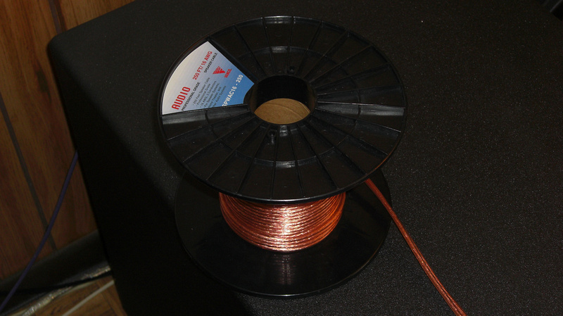

Here's my favorite speaker cable. It only cost me 20-something bucks for a 250' roll. I then split the (+) and (-) strands, twisted 4 (+) and 4 (-) together to make twin 9awg runs. I believe it measured out to 0.01 ohm for a 29' length via my HP 3435A DMM. What it did for the sound is make it more effortless and clean sounding. It's also extremely flexible.
Anyway, here's a few pics... Naturally. 😀
