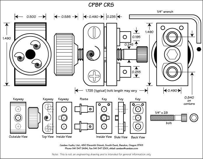

hifiZen said:This is the post I was referring to:
A customer sent us some of those for his speaker... i hate them.
If i'm going to spend serious money on connectors, i'll get Eichmann.
dave
Re the Cardas single knob post. While they seem to be an excellent electrical connector, I always seem to be one hand short of the number required to connect the wires. One hand to tighten the knob one hand to hold one of the two wires.
They are good for a connection that won' be disturbed, if you plan a lot of changes or experiments my advice is stay away.
I used to clean my banana plug equipped wires about every 3 months (because they needed it) now with the Cardas Rhodium over silver/copper lugs it's closer to a year.
I also love the Cardas contact cleaner, while the initial price is high, that little bottle lasts a long time.

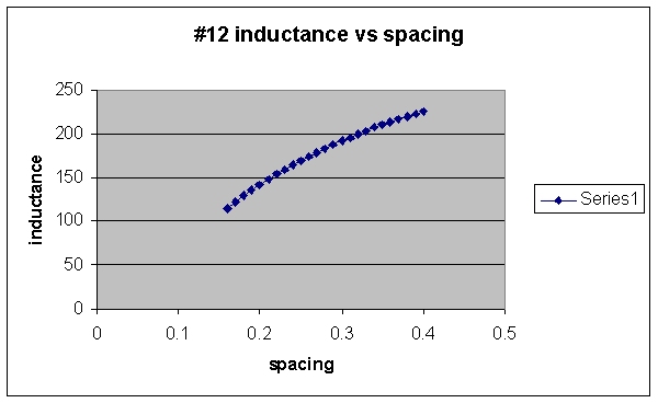

The terman equation has 3 components...first, the variables and units..
length is given in inches
D is the wire spacing, center to center
d is the wire diameter
log is base 10
delta = .25 at zero frequency.
mu is relative permeability, =1
L (uH) = .01016*length*{2.303*log(2D/d)-(D/length) + (mu * delta)}
The first part ...2.303*log(2D/d).. is the portion which describes the dipole field around the round wires..note that as long as the relation between the wire spacing and the wire diameter is the same, this equation provides the same value. If you double the diameter and double the spacing, the fraction 2D/d is unchanged.
The second ...D/length...is a correction for field enhancement when the lengths are very small.. When using the full equation for binding posts for example, this term will get you into trouble very quickly. For typical wires we speak of, this term should be ignored...zero.
The third term ...mu * delta... is the inductance within the cylindrical conductors. At DC, mu is 1 and delta is .25. At infinite frequency, delta = 0. (note: for a hollow conductor like the outer braid of a coaxial cable, this term can be considered as zero. There is no magnetic field within a hollow conductor, therefore no inductance..)
I just use part 1 and 3, set delta = .25, and plop it into a spreadsheet. What pops out is simple graphs of inductance vs wire spacing..
Cheers, John

Really (on both points)?? This coming from the frugal-phile, I'm surprised... or are you razzing me? If not, and I am not being at all snide, I'm genuinely curious what it is you hate about the former and love about the latter? I will readily admit to never having spent the $$ on Eichmann, so I have not examined their stuff up close.
hermanv said:Re the Cardas single knob post. While they seem to be an excellent electrical connector, I always seem to be one hand short of the number required to connect the wires. One hand to tighten the knob one hand to hold one of the two wires.
Hmm. I've never encountered that problem. But, my speaker wires are stiff enough (11 awg.) that the terminated ends with spades are self-supporting. So it's pretty easy to put the spades in place with one hand. However, I can certainly see that if you were using a small gauge wire, the spade ends could be difficult to hold in place... hadn't considered that factor before.
