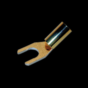

I like the Cardas spades (their low-end ones, GRS-R). Nice construction, high quality platings, and reasonably affordable. I refuse to pay the outrageous prices often quoted for connectors (especially binding posts like WBT, Furutech, and the most offensive of all, Eichmann - W.T.F. they want how much for that cheap piece of plastic with hardly any metal ??!?!?)

hifiZen said:I like the Cardas spades (their low-end ones, GRS-R). Nice construction, high quality platings, and reasonably affordable. I refuse to pay the outrageous prices often quoted for connectors (especially binding posts like WBT, Furutech, and the most offensive of all, Eichmann - W.T.F. they want how much for that cheap piece of plastic with hardly any metal ??!?!?)
Now that's an interestion point: connections. And their losses. I still maintain that you might have theoretically the best optimised amp-wire-driver system, but you can potetially loose out through termination losses. I prefer cold-weld / crimping whenever possible, although I don't just go for one run from amp to driver with no other connections. Probably shoud TBH, but I like the convenience of bananas (and they're probably the worst, not that spades are a whole lot better). Some of the prices asked are outrageous, but it's worth looking at how they make a contact -some might be pretty decent & it'd be worth scouting around for clones. I haven't looked at any for a while.

Scottmoose said:not that spades are a whole lot better
If you are going to use spades you might as well use bare wire.
No terminals is by far the best, but if you swap things in & out as much as i do, a good dual banana is hard to live without. So much so, that one of my pet peeves are when the posts don't have industry standard 3/4" spacing.

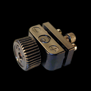

Another connector I really like is the Cardas "patented" spade post... the one with the knob that tightens down on two terminals at once. These are just great, and if you are swapping things around a lot, I think this is the best system of all. It makes a nice tight connection without any friction or scraping between contacts to cause wear. Just as quick as bananas, and you get a more positive lock - a banana can come out with a tug on the cable, these will stay tightly in place.
Ah yes, I remember the ones you mean. They look pretty decent (haven't used them myself). Main problem with spades that I remember is the contact area, or lack thereof, in most cases. These should do a little better.

Yes, Cardas does sell bare copper posts and spades. In theory if you take careful care of those (regular cleaning and application of anti-oxidation agents - hopefully you don't live some place too humid), they will be fine for a long time, but I prefer something more corrosion resistant. The ones I was talking about earlier (GRS-R, CPBP-CRS ... see attached pictures) are available with my preferred plating, Rhodium over Silver. Highly conductive, and highly corrosion resistant. The base metal is solid copper on both, and the platings are of very high quality.
With the spades, I usually discard the little brass tube (maybe it's supposed to be used as a crimp ferrule?) and just solder it on. After soldering, a little clear nail polish to seal off the stripped end of the wire should help prevent or at least slow down long-term oxidation of the copper wire. I finish off with heat-shrink and expandable braid tubing for cosmetics.
Cardas represents about the upper limit of what I'm willing to spend on connectors (IMO they're over the line on hookup wire, though). At least the prices are somewhat rational - high quality metals and platings, nice machining, good design, and a fair retail markup... I can accept that - if you really want a nice connector for that special project, you're getting something for your money. If you don't want to spend so much, there are cheaper options which will work just as well - some of the Vampire and Neutrik stuff. It's the blatant profiteering of some of the other guys that really turns me away. But they must be making a killing, or they wouldn't remain in business, continually jacking the prices higher and higher... ?
I think I agree on your point about contact pressure. I trust a spade more than a banana for a good electrical connection, although the bananas are hard to beat for convenience.
