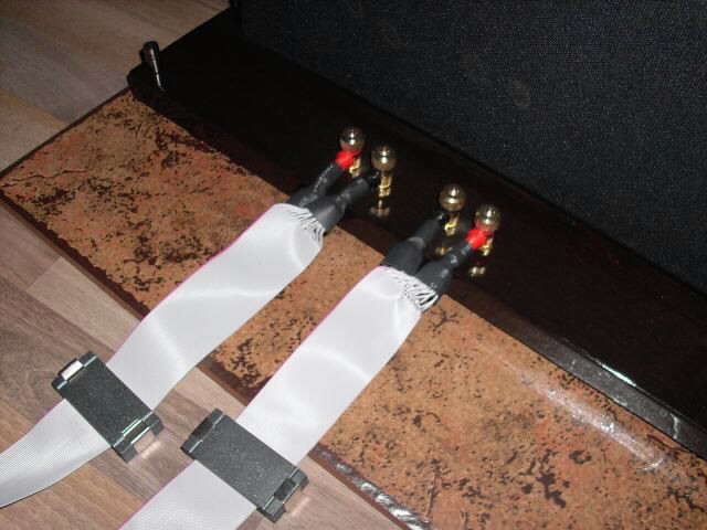

It's functional, reasonably priced and pretty. Don't know where you might find this in Spain.giantstairs said:[snip]
Any suggestions on whether to twist the cables or leave them separated?
