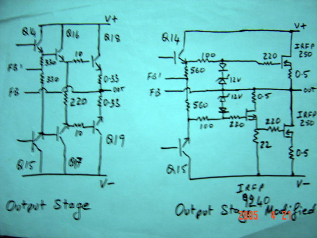

This is what I did last night , I modified the output stage from current
driven to voltage driven so that I could use IRFP250 mosfets in the output
of the same amp , the rails to the rest of the amp will be higher both
sides than that of the output stage .
Some additions can be done like grounding two 33k resistors from the
base of the bases of Q14 & Q15 to load the driver stage , take output
for the mosfets from the emitters of Q16 & Q17 and increase the
value220 ohm resistor a little,. instead from the emitters of Q14 & Q15
The schematic of the output stage is attached ,
Let me know if this is ok.
Rajeev
K-Amps
200v is minimum it is actually higher , also 2.5A at 1ms
