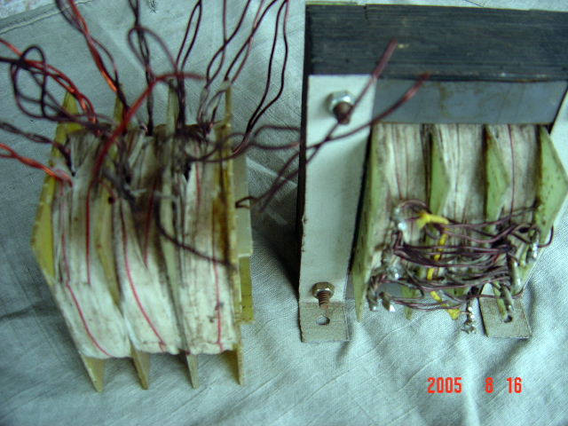

Dear Arif & Jacco,
An old leaflet of MacIntosh amplifiers in which the company described
their output transformer with winding diagrams was very useful in
designing my custom made output transformers , I can hardly make out if
there is a transformer in the output , the sound is so good . The advantage
to use a auto transformer is that the transformers power handeling is only
that of the power it is increasing hence the size is much smaller . yes the
devices will handle the extra current I checked that first .
K-Amps
I am posting this picture for you to show that DIYers can also make good audio transformers , we have to make number of bifilar windings and add them for minimum losses , the same could have also been made with a single thick wire but with more losses .

Rajeev:
Would you please be so kind as to educate me on why bifilar (or trifilar) windings are sometimes needed.
I mean, do the bifilar windings behave just like one winding, with twice the wire thickness?
Do they behave like two separate inductors in parallel, so half the copper resistance, half the inductance?
Do they behave like two coupled inductors, energy from one gets coupled into the other, then reflected back, then reflected, etc...
Each time I thinks about all the possible ways to treat a bifilar, it's like thinking about infinity, it makes my head spin.

Dear Funberry,
Sorry to reply so late ,
some of the advantages of bifilar windings are that ;- 1, the length wire
in two windings will be the same hence the resistance will also be the
same and due to this if there is any voltage drop that will also be the
same , thus making two identical windings .
2, In audio transformers to get minimum losses , it is desirable to get
max signal transfer from one winding to another , for this the windings
should be very close to one another , now if we use several parellel
bifilar windings they will have better signal transfer than only two
primary and secondary windings
