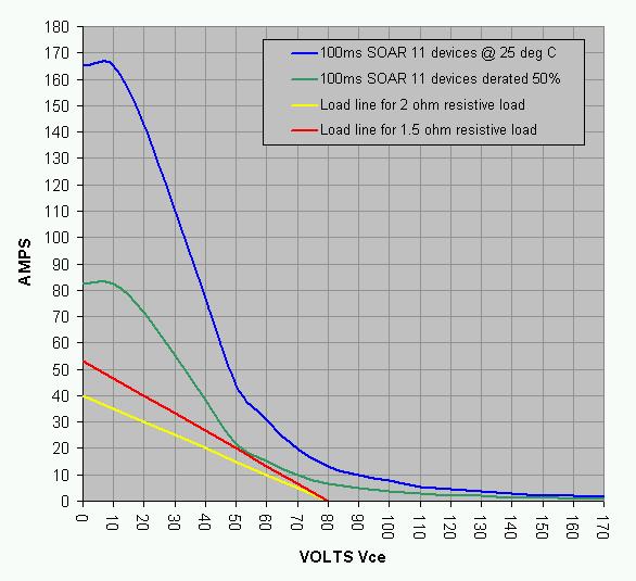

11 devices thermal + SOAR
Hey Rajeev
At idle your power supply has 87 volt rails and under full power with say a 1500va to 2000va transformer your power supply will drop to about 80 volts RMS. This assumes a mono amplifier.
80 volts - 8v (across transistors) * 0.707 = 51 volts RMS
51 volts across 4 ohms = 650 watts RMS at best.
51 volts across 2 ohms = 1300 watts RMS at best.
The maximum dissipation across the output stage occurs at about 60% of maximum output. So for 2 ohms this will be 1300 watts x 40% = 520 watts. Add to this the idle bias current i.e. 50 mA per transistor pair = 550mA x 174 volts = 95 watts.
520 watts + 95 watts = 615 watts divided by 22 transistors = 28 watts per transistor. To be safe lets make it 30 watts. At a junction temperature of 100° C the transistor can still dissipate 60 watts of instantaneous power so everything is ok from a thermal point of view. No problems here.
Now to estimate the SOAR. I have presented the 2 and 1.5 ohm resistive load lines plus the 100ms SOAR of 11 devices in the attached graph. The curve for devices at 25° C is well above the 1.5 ohm load line but unfortunately the derated 100ms curve gets very close and this means that if your heatsinks get warmer than about 70° C there is too little margin to assure safety. Remember that the actual impedance is complex and the load seen by the amplifier could dip even lower.
For general music applications (but not musical instrument) 11 devices should be ok and I would be quite comfortable using this amp. With a sine wave at full power for a few seconds the output stage would probably die, but this never happens with general music.
Hopes this helps

Hi Quasi,
"Add to this the idle bias current i.e. 50 mA per transistor pair = 550mA x 174 volts = 95 watts."
Just a thought here, this calc assumes that the idle current is flowing through the pair of transistors all the time. In a classAB amp the driving transistor increases it's current while the partner decreases and eventually swithes off. In a low bias design the switch off will occur close to zero volts (100mA into 8R=0.8V).
this effectively means that the idle bias is flowing for only slightly more than 50% of the cycle. I would like to suggest that when driving a heavy load the total dissipation in your example is 520w +0.5*95w =568w
Comments please.

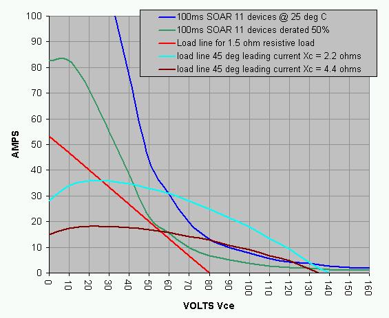

What happens to the loadline if the amp plays into a reactive load?
Does this change anything?

Hey AndrewT
My answer contains a few assumptions.
I chose to use the constant 50mA per device beacuse this is what the output stage will be doing most of the the time i.e. nothing, even during music and in between music. So from an average point of view the idle power dissipation is valid. But as you say in practice it will vary.
I did mean junction temperature as this is how the transistor is derated for SOAR, hence my reference to instantaneous power instead of average power. A transistor with a case at 25 deg C could still have a junction temperature way above that during peaks.
Cheers
Cheers
Ha Ha ...you see why I specified resitive load.
Yes Jens, everything changes.
Hopefully with a nominal 2 ohm load there will be enough resistance in the emmitter resistors and speaker cable to save the amp ha ha ha ha ...sheeesh. Umm Rajeev better add a couple of pairs.
Then again we are only talking about music and not RMS.

Have a look at this page
http://www.sound.westhost.com/soa.htm
My calculation show what Rod already simulated.....
You MUST be sure what happens when the amp is loaded with reactive loads.... The case Rod uses is not at all unlikely, and the transistors will die if it exceeds the SOA, even if it is for only a short time.
I have not finished my calc. yet, but I will post them when they are done.
You have to look at two cases:
1) The maximum dissapation in the output stage (at Vout= 0.64*Vrail) for calculating the temperature on the heatsink and transistor junction
2) The maximum peak dissapation at reactive loads that must be within the derated SOA for the transistor at all times.
Only when both cases are examined and approved, will the amp be ok for PA use.

I think this is what you are talking about. The graph below shows a scenario of current leading voltage by 45 degrees in reactive loads with Xc's of 2.2 ohms and 4.4 ohms.
Even with a nominal 4 ohm speaker and Tj of 25 degrees 11 pairs may not be enough because the 100mS SOAR will be exceeded under certain signal conditions. So this means that 2 ohms for 11 devices is definately out but 4 ohms should be ok for general music.
Sorry Rajeev for misleading you earlier. Got any spare FETS to make this problem go away?

Hi Jan
