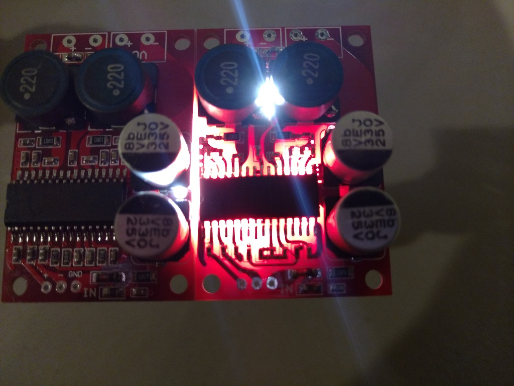

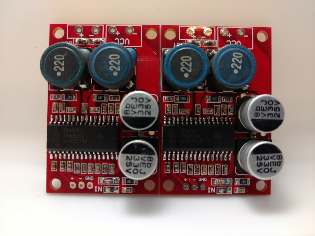

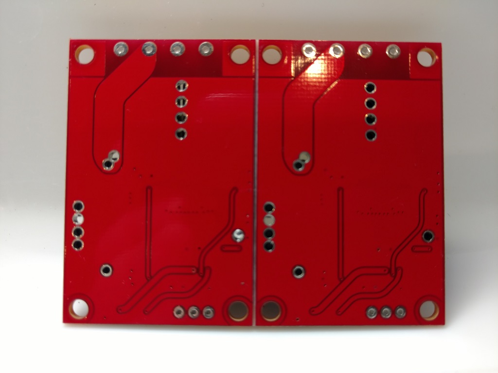

Here is a "red board" variant implementation I just received last night. Haven't had a chance to listen to them yet. I'm going to power them with this "AC Converter 110v 220v to 24V MAX 9A 150W Regulated Transformer Power Supply" cheap SMPS (it was mentioned in the "cheap tpa3118 boards + mods" thread).
Thought they would make for a fun, cheap project. I've been doing tpa311x projects for years now, thought I ought to try something different.
What appealed to me about these red boards is that they have easy through-holes for balanced input. I'm thinking about replacing the stock input caps with jumpers, and using this Edcor TTPK15k/15k transformer I've had for a while now. When I got them last night I noticed that while the stock electrolytic caps are SMT, the board also has through-holes for these components. Seems OS-CONs are obligatory at this point!
Attached are pics. I tried to do the "flashlight" trick to better expose the board traces, though the photo didn't come out as good as it looked to me. This was a quick cellphone pic, if there's interest I'll bust out the DSLR and try to do better.
See post 150 and post 157 for TDA8932T versus TDA8932BT.
TDA8923BT is easier to use and maintains good quality in most conditions.
Older TDA8932T (in your photo) doesn't drive tweeters well in BTL mode, but it can do good quality with either just the tweeters in SE mode (return point is simply a small cap series with 0v--that cap blocks DC and does Not replace any speaker crossover parts) or whole speaker in SE mode (see datasheet for that delay cap, charge lines and other details).
Although the above two chips may run at near 40 watts for music (if driving 8 ohm or lighter loads), the datasheet maximum specs are achieved by TDA8932BTW which has a heatsink tab added.
