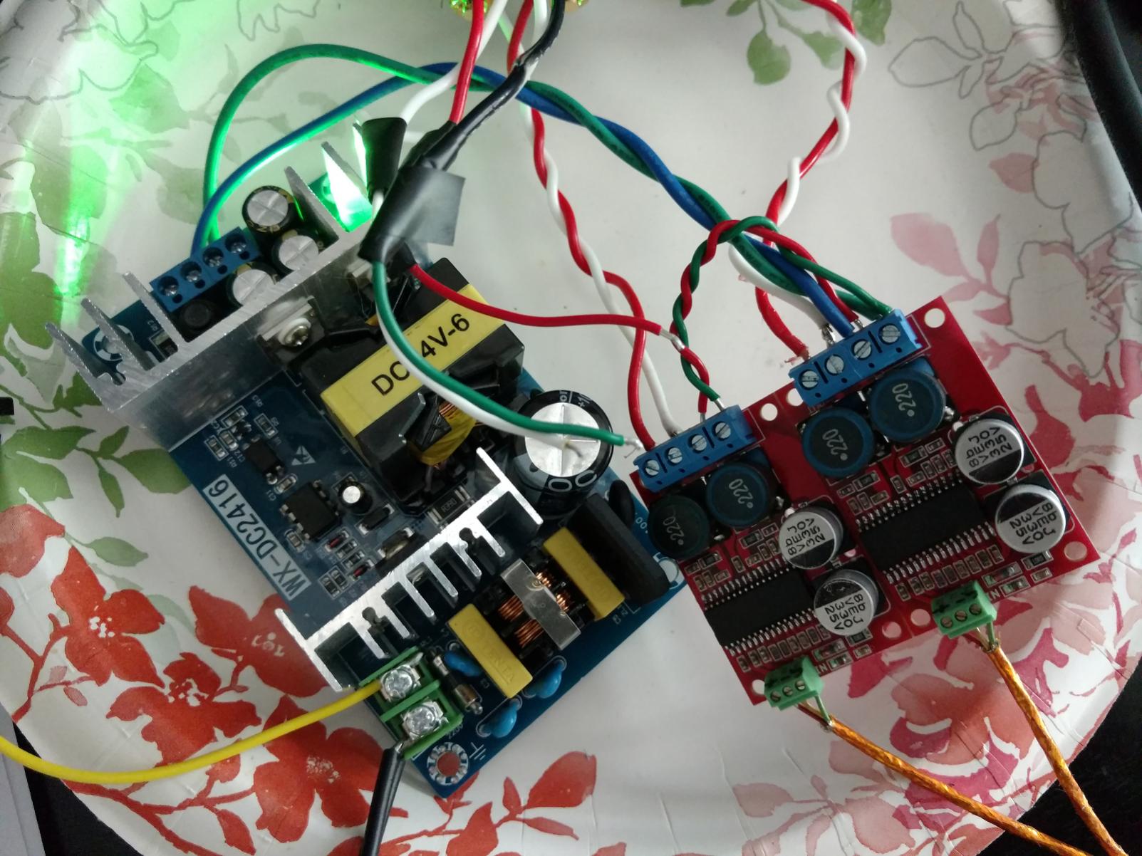

Finally got mine wired up for testing. Just started listening but initial impression is good. I'm driving single full range drivers, and I don't hear any obvious high frequency stuff Daniel mentioned. Though in general I'm starting to think my ears are the biggest limiter in my system. 😉
Anyway. You can see I'm using a 24V SMPS, that was just over $10 from Ebay. The rest of the parts were all recycled. For about $20 total invested, it's definitely a good value. My upstream source is single-ended, so I'm currently using what I believe is called a pseudo-differential cable (cold signal is shorted to ground).
Next step will be to put an unbalanced-to-balanced transformer in between to feed these guys a truly balanced signal. (Also working on upgrading the DAC to truly balanced.)
This has been hinted at in this thread before, but I'm really surprised how hot these chips run. I can't keep my finger on them for more than a few seconds. My IR thermometer says the tda8932 package temp is about 35C. The inductors don't feel as warm (can keep my finger on them comfortably) but the IR thermometer says 55C!

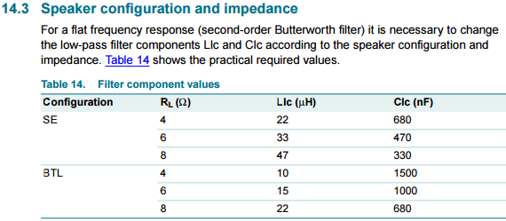

Has anyone tried messing with the output filter at all? Maybe some of the high frequency quality issues that have been observed are due to mis-matched filter-speaker effects. Below, I attached the recommended filter values table from the datasheet. The red boards I have came with 22uH inductors, and default to BTL mode, so I'm thinking they were intended for 8-ohm speakers. Judging from the pics in this thread, that filter appears to be the norm for all these boards. So, for example, switching from BTL to SE mode as Daniel is doing, but keeping the filter the same changes the filter to be optimized for a 4-ohm load. If the speakers are 8-ohm, that means the filter will be either over-dampened or peaking (I forget which). I would assume there is a similar phenomenon at play when Abraxalito puts the transformer between the amp and speakers (i.e., increasing speaker impedance changes the output filter in one direction or the other).

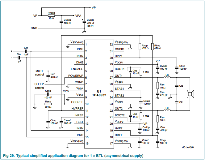

Also, looking at the example BTL circuit (datasheet page 36, attached below), the two inputs are paralleled (IN1P+IN2P, IN1N+IN2N). Just by looking at the pictures in this thread, I don't see traces for that parallel connection. Perhaps the connection is at a different layer than is visible in the pictures? I don't have the boards in front of me now, so can't check with a DMM. If the inputs aren't paralleled, is the board truly running in BTL mode?
Certainly I have - I'm in the middle of modding some output filters on a couple of boards at the moment. I didn't change the 22uH/680nF when I fitted the output transformer so I'm doing that mod to see if I hear anything different. With my 2.5:1 trafos I need about 140uH and 100nF for the optimum filter cut-off. I've also tried reducing the switching frequency, which I did for my active set-up where I didn't need the full audio bandwidth on the bass/mid section. I found the internal oscillator can't go much lower than shown on the datasheet graph, but the chip can work slower with a slower external oscillator.
Output filter changes I've barely noticed changing the SQ, in contrast to power supply impedance reductions.
Seeing as 4ohms provides more damping than 8, it would be the latter.
Yes, though the reason for the transformer is to make the amp less sensitive to power supply quality by raising the impedance it sees, so it produces less supply ripple. The same could be achieved if we were able to build our own drive units to achieve higher impedances.
I'd say no, it would be SE.
I just measured resistance between supposed-to-be-paralleled inputs on my two red "BTL" boards. Between IN1P/pin2 and IN2P/pin15, and also between IN1N/pin3 and IN2N/pin14, I measure about 53 or 54 kOhms.
Seems awful high. Shouldn't it be effectively 0 if they were paralleled as per the datasheet suggestion I attached above?
Or is this a case of "operator error" and I'm not using the DMM appropriately in this situation?
I think its operator error in making some incorrect assumptions, the measurement looks pretty close to what I'd expect.
Firstly the two 'sides' would be wired in inverse-parallel, meaning + and - together, not - and -. So you measured the input impedance with your DMM and when both sides are paralleled it would be half of the SE input impedance of 100kohm. Hence 50kohm with a rather large tolerance of 30% worst case.
I think its operator error in making some incorrect assumptions.
Yup. 😱
Emphasis mine. You might be tempted to think, "Since he took the time to post that schematic, surely he actually studied it carefully." Well, you'd be giving me too much credit if you thought that way!
Indeed, I failed to notice they are wired in inverse-parallel. I just measured IN1P to IN2N and see (nearly) 0R as I expected (and likewise for IN1N to IN2P).
Sorry for the noise!

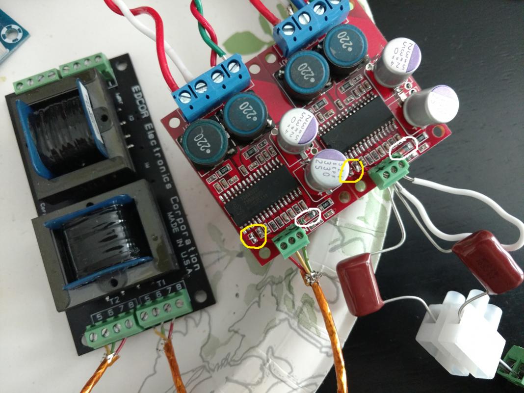

I may have killed my boards...
I attempted two simple mods: (1) replace the electrolytic power caps with OSCON; (2) replace the DC-blocking input caps with jumper wire. See the attached picture. The yellow circles are where I removed the factory caps and replaced with jumper wire.
As far as removing the input caps, my plan was to use an input transformer (Edcor TTPC15/15) for both DC blocking and unbalanced to balanced conversion.
It seems I managed to kill both boards.
In the picture, you can can see the left board is still connected to the transformer. I thought maybe the transformer itself was the problem, so I tried to re-create the capacitor setup on the right board: I jumpered - and GND intputs (white wire), then put caps (big brown guys) between + and - and an RCA jack.
When I powered up the board with the caps, the speaker attached to that board immediately pushed out all the way. No sound though. (Thank goodness for excursion limiters!)
When using the transformer, I get no sound at all, and no speaker movement.
The tda8932 boards do get warm though, so it appears they are getting power.
I used my DMM to check continuity between the input screw terminals and the actual tda8932 chip pins.
Any thoughts I what I did to break these boards? I did use almost the hottest setting on my soldering iron, the factory solder is miserable to work with. But I really don't think I overheated the boards, as I was holding them in my hands while doing most of the work. They get warmer in actual use than from my soldering. Those factory electrolytics were practically welded to the board.
Also, unrelated side question: what is the component circled in white? I'm guessing it's a diode? Any idea what it's function is?
