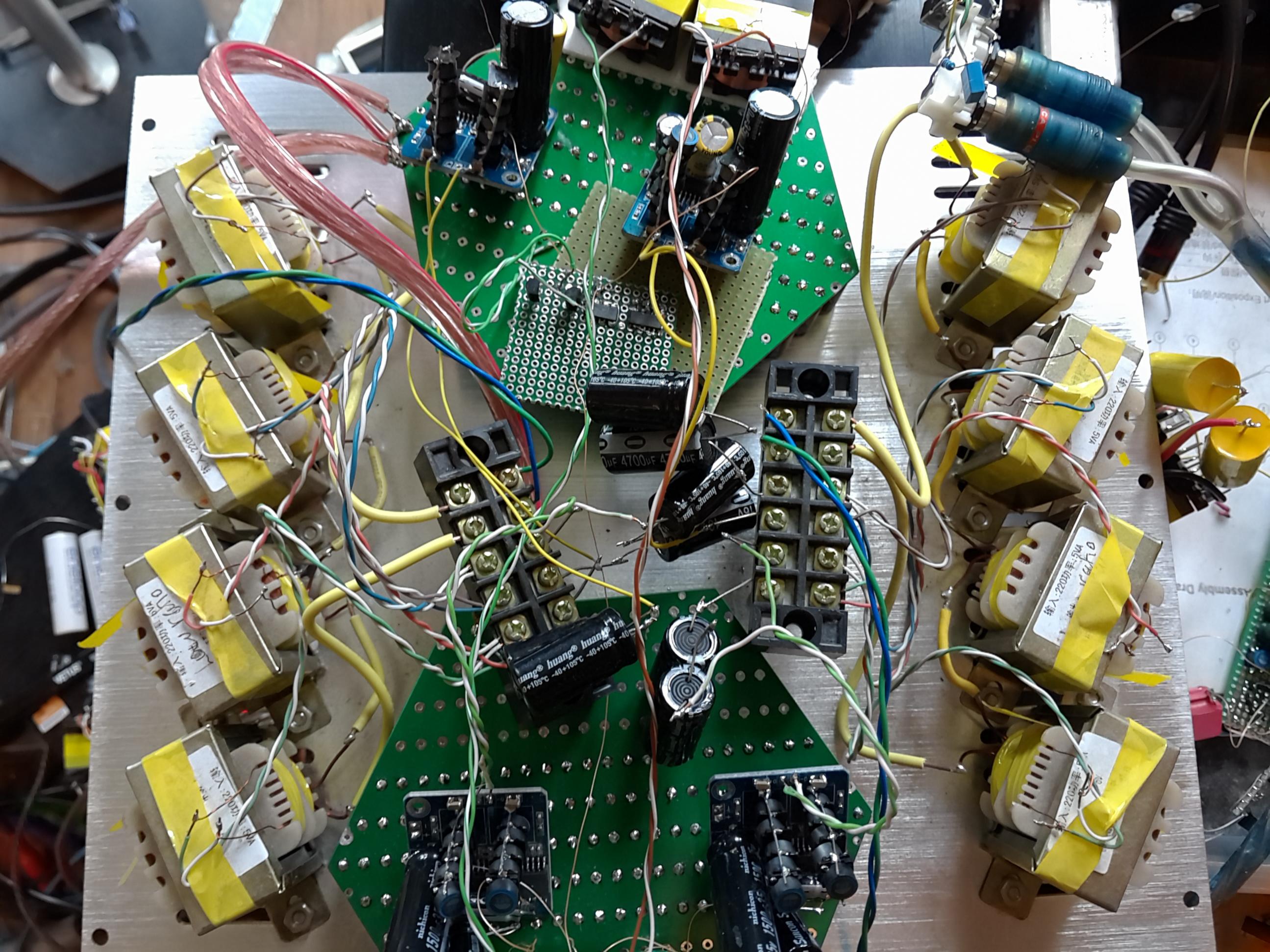

Here's the latest development with my SanAi modules - stacking a pair in series. I've wound 4 trafos per channel but here I'm using them in paralleled pairs just to test the concept. Promising 😀

Kudos for exploring that.
However, it would be nice if you'd reduce the number of transformers required.
Even so, the photo of that thing is awesome! I'm certainly not doing it that way, but I did like the photo!

It might be possible to arrange it to just need one transformer, using four primaries. The reason I've done it with four is because I'm too lazy to count turns accurately - having the primaries on different trafos means the ratios are none-too-critical. Four primaries would need to be identical numbers of turns not to fight each other, even then the gains would need tweaking as the DS only says they're within 1dB which is a pretty huge margin in the scheme of things.

By the way in case anyone's wondering, the little PCB in the middle is to generate a common clock for all the modules - the DS says there's noise from the on-chip clock osc at higher voltages and this is designed to run up to the maximum voltage of the supply caps (35V).

Can I see a closeup photo of your board? It looks like you stacked inductors?
Do you have a low cost source of input trafos on Ali by chance? They are so darned expensive elsewhere...
I will take a close-up photo later for you. Yes I stacked inductors because I didn't have the correct value (140uH in the large size) so I paralleled 5 * 680uH of 7mm diameter which I have a whole reel of. I needed a different output filter as with the output transformers, there's a multiplication of the speaker impedance.
As for the input trafos, I make them myself. In fact I've replaced the ones in that picture with some made from EP17 cores which are physically smaller (17mm on a side cubes). To make those you'll benefit from a winding machine, the turns number is 2400 for the primary and the secondary is 500 turns, centre tapped. I used 0.07mm wire.
I just had a search on Aliexpress, they're not showing anyone selling EP17 but there are plenty of vendors with RM8 which is a little larger, hence will need fewer turns. Prices are about $2 for a core set. Taobao is even cheaper but there shipping's not included.
Here's a highly zoomed-in shot of one of my modded boards.
Points of note - I'm running twisted pair differential input from the EP17 transformer, there are 11k resistors in series to attenuate HF pickup. Two extra caps added for decoupling, one to the analog power supply (pin8) and one on the analog Vref (pin12). Pin12 goes to the trafo CT allowing deletion of the input caps. Pin10 (resistor osc frequency setting) is 0R to GND because I'm using an external oscillator.
