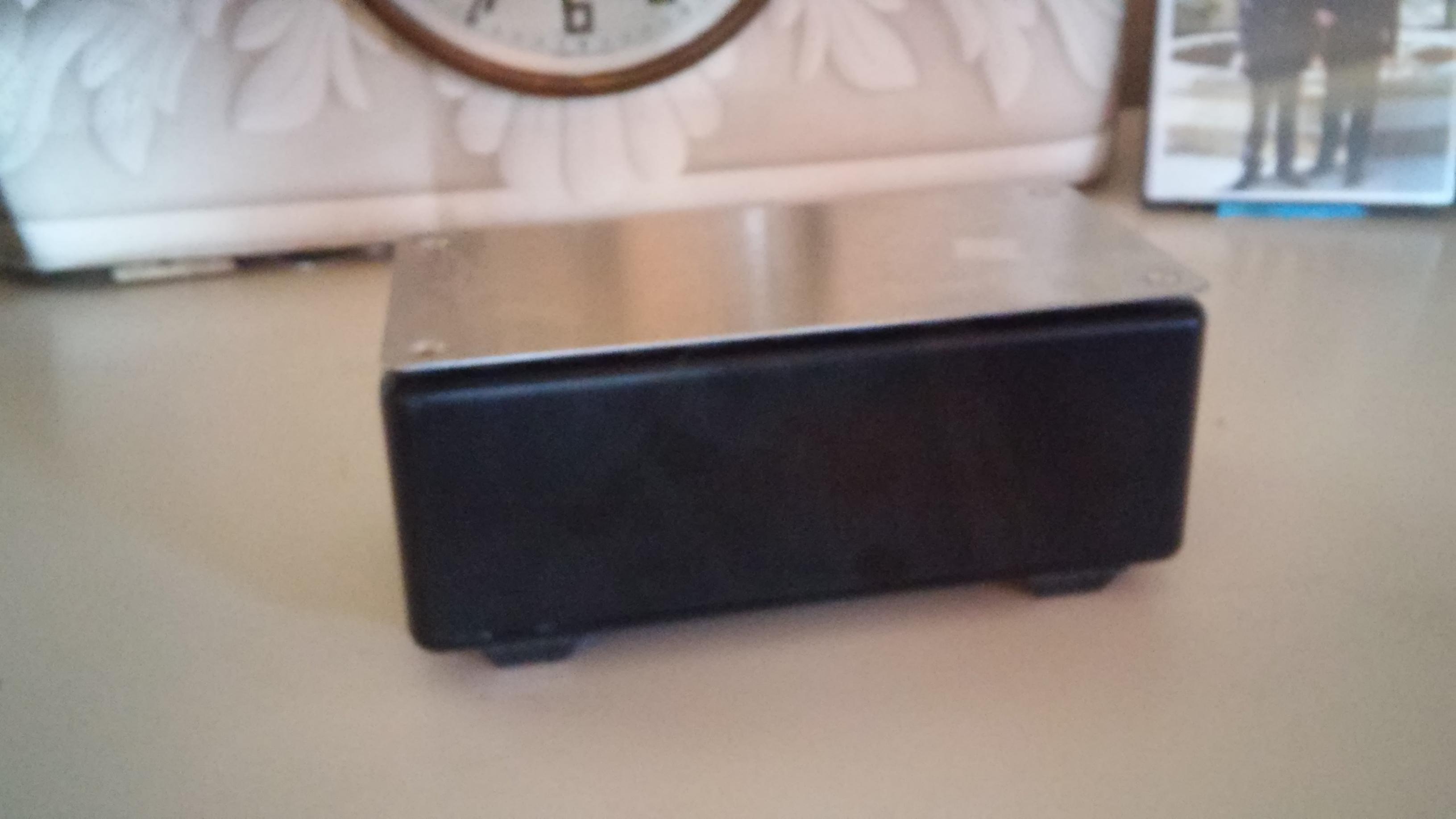

Enclosure started
This is an ordinary plastic project box with a metal plate, a very useful metal plate.
After some light drilling, I will be able to bolt the metal plate to the top of the box as shown positioned in the attached photo. It could look better with some pinstripe tape and some metal knobs added.
The plan is to cut away most of the top of the box, secure the amplifier to the metal plate with some kapton or thermal interface pad and bolt that too, and drill holes, not much smaller than my finger, in the bottom of the box.
There will be 8 screws showing on top of the box, but the amplifier will be inside.
Due to adding some significant stick-on feet, air will go through holes in the bottom of the box, crowd around the amplifier (bolted upside down to that metal plate at the top of the box) blow through that big hole at the top of the box, crowd around the metal plate relieving it of heat and cooling off the amplifier with no fan required.
On the back of the box, positioned way down low (to prevent flipping over backwards), I plan to use Monster oversize speaker terminals, in their much cheaper form without the gold plating. That would be these: Two Conductor Speaker Wire Spring Terminal Note the 12ga capacity. These are huge. I like them because the spring is very strong and assures good contact (there's doubled contact surfaces) at the first minute and afterwards as well.

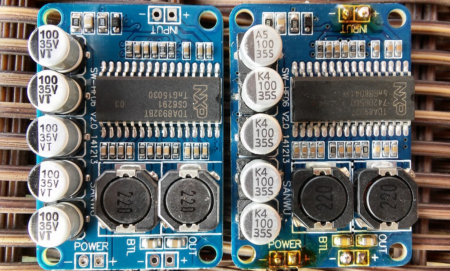

Quality varies with production, see photo
On the right, is the originally reviewed part which does mid-fi in BTL mode or somewhat better quality in SE mode. It is more useful in SE mode. However...
On the left is a newer purchase, I got two of them and am currently using its twin. The amp on the left does good quality in BTL or close enough to high end in SE mode. It is serviceable in either mode.
The printing on both the caps and chips is different. Which one do you have?
Mine appears to be the RVT cap variant - so not like either of yours, is it better to have an RVT cap vs VT cap?
If geniue, datasheet will tell.

If they're the bigger ones, there is 125mA*1.5 (correction factor) * 5 = 938mA ripple capability for the whole bank. As the dissipation factor is only given for 120Hz, we can calc the ESR at this frequency to:
ESR(120Hz) = DF/2*pi*f*C = 0.16/2*pi*120Hz*100uF = 2.1Ohm each
But from the picture i miss the venting cross.

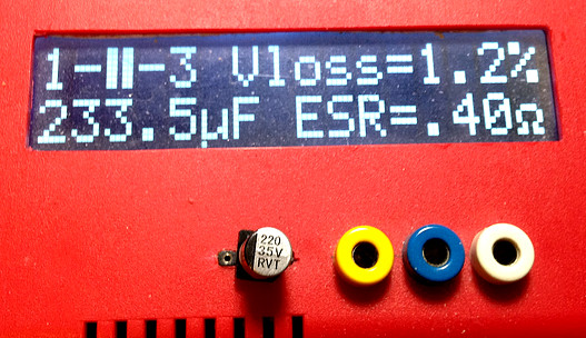

Regardless, the amp sounds fantastic. 🙂 I have a dead unit and can pull the caps off the measure the C and ESR with my LCR meter.
I found one of those RVT caps in a small buck converter and put in on the ESR meter.
RVT 220uF 35V
measured
233.5uF (+/-2%) ESR(10kHz)=400mR 1.2% dissipation.
smaller capacitance usually leads to higher ESR.
Picture of proof attached.
Yours looks just like mine, but Daniel's are different, his labeled "Sanwu" brand, mine are not.
Neither look like the poor caps example. I can't tell you for sure because I have only one of them (practical comparison hindered). Also compare the chips. Which one to you have? The "T" or the "BT"? See photo posted just earlier. By your reports, your good board and my good board are *very similar*. Please say more about the printing atop that chip?Mine appears to be the RVT cap variant - so not like either of yours, is it better to have an RVT cap vs VT cap?
I'd like to know if the relevant difference was chip or caps. That's the question.
How much it may cost for the audio quality difference between the two different samples that I received in the mail, isn't something that I'm prepared to describe because it is surprising. However, in one case, I can say that a limit to performance of the chip itself, wasn't identifiable. The other one was reviewed previously. There is a difference. I need to know where (locale) that is.
Looking closely, the amp on the right is using the older TDA8932T, that on the left has the updated TDA8932BT. From the datasheets the difference I noticed is that the newer 'B' suffix part has 1Mohm resistors integrated on the chip - the older (no 'B') part needs those 1Mohm resistors fitted on to the PCB. But the board is clearly laid out for the 'B' part as those resistors are nowhere to be seen.
You could try adding 1Mohm resistors (across the 15nF bootstrap caps, between pins 21/22 and 27/28) to the amp on the right and see if that helps with the SQ in BTL.
Thank you for telling us that a chip difference exists.Looking closely, the amp on the right is using the older TDA8932T, that on the left has the updated TDA8932BT. From the datasheets the difference I noticed is that the newer 'B' suffix part has 1Mohm resistors integrated on the chip - the older (no 'B') part needs those 1Mohm resistors fitted on to the PCB. But the board is clearly laid out for the 'B' part as those resistors are nowhere to be seen.
I had a plan to toy with the older, slightly lackluster, variant for experiments. Apparently, I need to add the missing parts before then. Thanks for the help.
