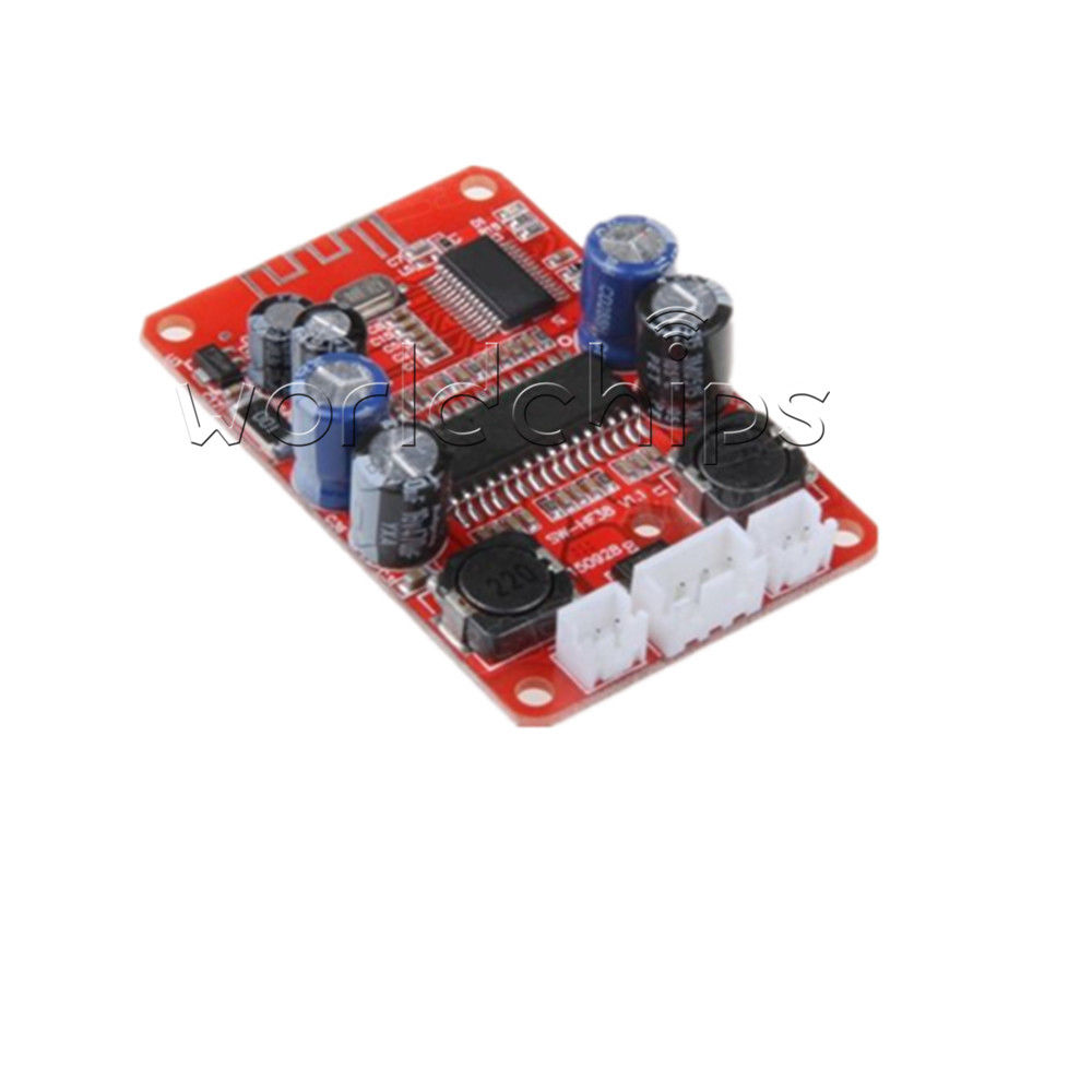

I originally wanted this chip board for making a mono mini bluetooth speaker (with a 5" 2way driver), but recently discovered that there already are boards with bluetooth built in ready to go, which is fantastic and make things more easy.
Whats bad is that there are no mono boards. So i was wondering if is it possible wiring a single speaker into the L-R terminals and so getting mono sound? just like when you mix signal sources. 😕
That is not the right way to mix two channels of a stereo system.
But..
But you may use either of the two channels from this Board and leave the other channel unused (I don't see any harm there)
For Conversion of Stereo to Mono,you need to add a stereo mixer.
For mono btl config of the chip:
Look at Fig. 35 & 36 of the datasheet.
You will find a way to modify your board to mono btl.
For mono signal input:
Look at the traces between the bluetooth part and the chip input.
Identify the signal paths of the L and R channel.
Put a resistor of ~10K into each signal path of the two channels.
Then you will be able to tie the channels together after the resistor and before the chip input.
(...just google how to sum the signal and apply it to your board.)

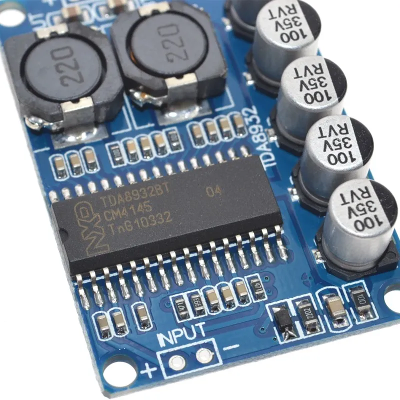

Parallel. . . to raise the impedance of my speakers I use output transformers and this cleans up the highs nicely. . . I'd definitely not recommend car speakers with TDA8932 as they tend to be rather low impedance (due to cars having low voltage supplies).
I wonder if this chip, or its bigger brothers, have ever been used in Parallel mode? Looks odd; however, it will run cooler and with the inputs + to + and - to -, this chip and its bigger brothers won't fuzz. Also a parallel amp is a much simpler, less bulky and less expensive way to get a more favorable output impedance for the amplifiers (since each sees half the load). The physical size of the thermal interface would be more favorable as a parallel amp, probably resulting in full capacity available. Given two such parallel amplifiers (sync'd), adding the base stopper resistors at input and an external bridge adapter, then a full power, full quality bridge amp, becomes a possibility.
It seems that the missing piece to the puzzle, is a good parallel amp?

SMPS > cable> capacitance > high-current low-voltage diode series to V+ > amp.
Each amplifier board has its own diode.
For that application, check the diode's datasheet and choose one with a current vs voltage drop graph that looks like "|" not "/". You want that graph to look like a straight up wall (throughout the applicable range of current).
Then, the inherent CRC filtering action doesn't dump your bass like a resistor would do.
So, at least 6a capacity and not greater than 200v tolerance. And, as many diodes are there are amplifier boards.
Mainly, this will let you have your one SMPS, and then a cable, drive one cap bank, to power several amplifiers, without crosstalk.
Within the range of 0.55v to 0.8v fvdrop, the effectiveness and power costs are both constrained to a tiny amount; however, in my opinion and personal usage, hearing less power supply influence was worth the cost of two fat diodes.
