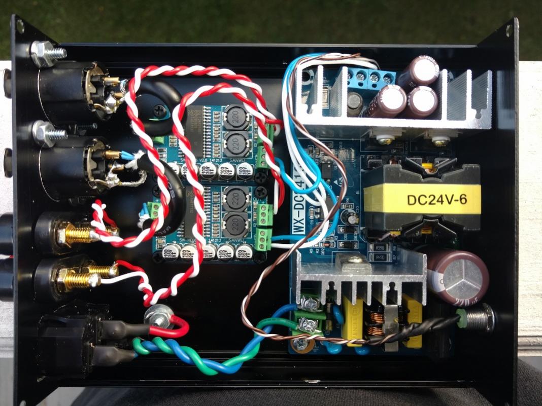

This thing definitely wins on value if nothing else. I still find some "charm" to these little boards that I can't put my finger on. A few posts back I showed my messy no-case implementation. Yesterday I moved everything into a $20 case. Ultra compact, cheap, great sound.
I thought maybe those Sanwu boards would accept differential input, hence the XLR sockets. Of course I didn't test this before I put everything in a case. 🙂 I found when feeding the board a differential input, I got tons of hum. Shorting the cold input to ground completely eliminates that. So now my amp uses XLR sockets for single-ended input. Oh well. Still sounds fantastic.
I have too many projects in the queue right now, but I'd like to design a PCB for this chip. I think I'd clone the Sanwu design, except: bigger/beefier inductors, balanced input, bigger power supply decoupling caps, and bigger solder holes for the screw terminals.

Fun on the cheap! Nice compact layout in that case. Do you have a link to your power supply? I have been using AC to DC power cords I purchased at a thrift shop for $1.00. Do u think it would make a significant difference using your PS vs mine? I think I mostly use 12V 3 or 5 amp, and 19V 4 amp bricks? I put them in all kinds of small chassis, like little wood jewelry boxes all decorated up for the grand kids. Can go real small without ps in the case.

With the tpa311x amps, my favorite power supply is the Connex SMPS300R. But I haven't tried the power supply in my picture with the tpa311x amps.
Here's one ebay link for that power supply. Note there is at least one variation on it. I have two of these, the model number appears to be WX-DC2416.
They are $11 shipped! Then I spent another $10 or so to upgrade the caps with these:
primary cap: United Chemi-Con KXG EKXG251ELL221MMN3S (220 uF / 250 VDC), mouser part number: 661-EKXG251ELL221MMN
secondary caps - bulk: United Chemi-Con KYB EKYB350ELL102MJ30S (1000 uF / 35 VDC), mouser part number: 661-EKYB350E102MJ30S
And then I put a couple of these directly across the output +/GND terminals:
secondary caps - filter: TDK X7R 10% 1206 C3216X7R1V106K160AC (10 uF / 35 VDC), mouser part number: 810-C3216X7R1V106KAC
sailmanbigd, here is a link to the power supply:
AC110V 220V to 24V DC 9A 150W Industrial Power Switching Supply Converter Module | eBay
I bought a couple of these. I have tested them to 6 amps output. Don't know if they will actually make it to 9 amps though.
That listing is either confused or dishonest. The title is wrong, but the description is accurate. That supply is 4A continuous 6A peak. There is a similar, slightly taller, slightly more expensive version that is 6A continuous / 9A peak. In fact, the same seller stocks it.
