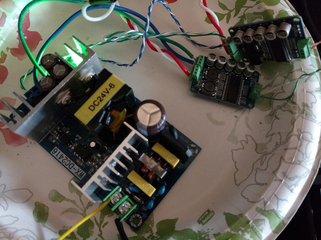

I have two wired up for stereo on the workbench now using one power supply. The sound is good. I just share the power with them both from an on/off switch. The input grounds are shared as well. Easy and sounds good. What I would like is what simple and inexpensive upgrade is recommended to get better than muddy. Or what is the mods suggested to improve sound, possibly in order of most improvement. It is hard for a novice(me) to study thru this thread and decipher what is best, what has actually been done and proven, and what is just proclaiming a "what-if" mod or configuration. And then exactly how to implement.

Thanks for the detailed response. Once I test them in stock form how do I wire two for stereo?
If you're asking the simple question I think you are, just do this:
Run a wire from your power supply's V+ to the first board's V+. Run another wire for the power supply's GND to the first board's GND.
Then simply run a wire from board one's V+ to board two's V+. Then another wire from board one's GND to board two's GND.
Alternatively, you could run two wires out of each of V+ and GND from your power supply. One pair of wires (V+, GND) goes to board one, and the other pair goes to board two.
Both accomplish the same thing, just choose which ever is easier and/or cleaner.
Some class D amplifier chips (e.g. Texas Instruments tpa3116) have master and slave modes. In that case, you still power the two boards as I mentioned above, but would additionally configure one board as master and the second as slave, and run an extra signal wire between the boards. But even then, you don't have to do that---I never have (just did it the quick and dirty way described above). At least with the tpa311x amps, I've only read of one person who actually had to use the master/slave mode functionality.
But I'm not sure if this tda8932 chip has the master/save settings or not. But even if it does, it doesn't look like these cheap boards have solder pads/holes for them. If that functionality does exist, you'd have to solder directly to the chip pins.
Point is, I wouldn't worry about it. Just wire the power in parallel as described above and see how it goes. Before I killed my tda8932 boards, that's exactly how I had them wired up, and they were fine.

Yes, that's it! Is splitting the input about the same? I just want to verify since it takes so long to get these. I'd hate to fry one.
As long as you get the voltage polarity right (positive to positive, negative to negative) you are very unlikely to fry the board using either method.
I'd favor giving each board its own run back to the PSU, rather than chaining them, because I'm lazy, and that's simpler than working through wether it's actually likely to make any difference.
You shouldn't need to worry about splitting the input. I think all the boards I've seen in this thread are mono. So left channel goes to one board, and right channel goes to the other board.
If your source has three pin output (L, R, GND), then you would need to split the ground, so you can do L+GND to one board and R+GND to the other.

After I managed to break the two red boards, I thought I'd pass on these amps. But I kept coming back to this thread, and couldn't help myself. I bought a couple of the "Sanwu" boards, and got the "BT" chips. I didn't do any mods this time, just hooked them up to a cheap SMPS. I have to say I really like the sound coming out of these. I can't put my finger on what I like. I have more tpa311x amps than I care to admit, and while the TI chips might be a bit more detailed and have slightly "blacker blacks", there's some charm on these tda8932 chips that makes me smile...
...Or maybe it's just the price. See the pics for my current setup, hacked together quickly for testing. I spent under $8 on the two tda8932 boards, just under $11 for the PSU. I spent another $10 or so for better caps for that SMPS. So for $30 I have what I think is a real keeper. Waiting on a cheap case to put it all in.
