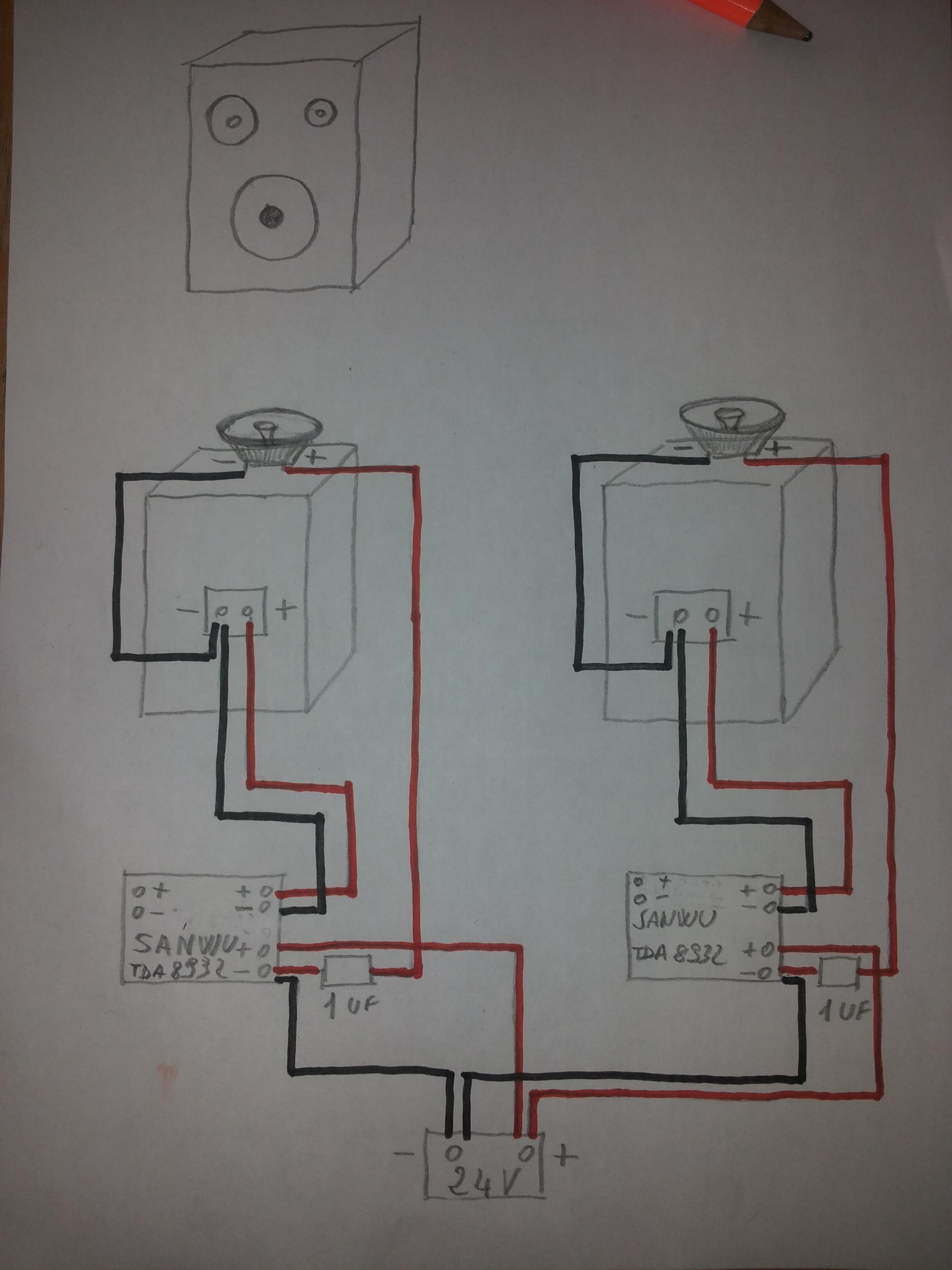

Hello Daniel, this scheme post 367 all right?
https://postimg.org/image/429h21fpv/
The wire going to the 1u needed to be sketched in black pen because it is still ground. The wire going out of the 1u needed to be sketched in any color other than red.
The 1u may be too small. However, it is within the expected range of 1u~10u. Therefore, it is also possible that it would work perfectly.
The super-tweeters added to the top of the speaker, in the sketch, appear be large bi-cone speakers, which would not be very efficient in producing the uppermost treble. If it was like the 8" dual-cone speakers in the ceiling of my grocery store, run through a 1u cap (that what the drawing looks like), then you might not hear the output. You will want a 3/4" (or smaller dome), a wee little dynamic horn, a paper tweeter of 2" or smaller, or a ribbon/planar/electrostatic tweeter. Given the super-tweeter (assistant tweeter) task, then the part to use won't be to the scale of the drawing. Also, note the output power difference in SE mode--The added super-tweeter needs to be 6db more efficient than the main speaker.
At the bottom of the drawing, the 24v supply is going to the TDA8932 driving a woofer in bridge mode. This works, but it also incurs the need of a heatsinking effort so that the amp doesn't simply shut off every time you turn up the volume knob. We did test high power bass output, and if you want that, then, necessarily, you want a heatsink. Just saying that if there wasn't a heatsink, you might want to pull that voltage spec down to 18vdc~19vdc or so. Even that much will shut off at max, but the figures are closer and you'd probably enjoy trying it. Might like a heatsink even more. So, that was worth a mention for powering your woofers.
Except for this list of, possibly unimportant, nitpicks, the drawing should work delightfully.

So that the drawing mentioned doesn't evaporate, I have attached it to this post. It does look, just like, how you attach an efficient super-tweeter (small assistant-tweeter) up to a bridge amp, for higher audio resolution output. The cap size and tweeter size might not be to scale for broad application. The added super-tweeter needs to be 6db more efficient than the main speaker.

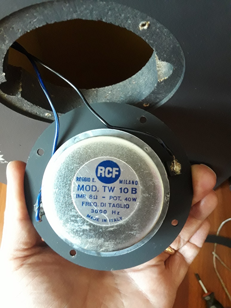

Meanwhile, while I wait for the boards to arrive, I'll upload there the pictures of the tweeters available at the moment. Do remember that my speakers range between 87 and 90 db, so if these ones aren't fit, I would ask you to link me a website where to find something more fit for my needs.

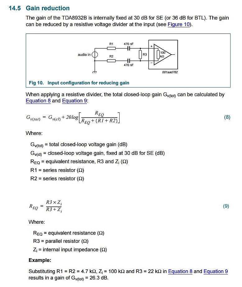

The noise seems to be caused mainly by the very high gain of 30dB (SE-mode) respective 36dB (BTL-mode). There are no pins for changing the gain directly, the datasheet indeed DOES mention about the gain reduction though.
attachment.php
That has to be applied to pins 2 & 3 and 14 & 15 respective before the parallel wiring in BTL mode.
attachment.php
Did anyone try these modifications already?
