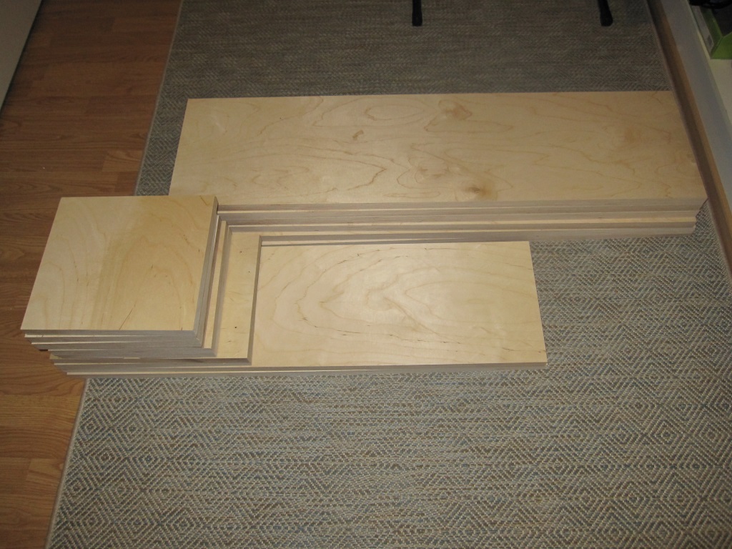

36 square feet of 24mm BB ply sawed to measurements for 100 dollars. Not a bad price, at least by Finlands standards 😀
I love it when a plan comes in motion. That's the best part for me. Looking at all the planks cut and knowing what it will become in a near future!

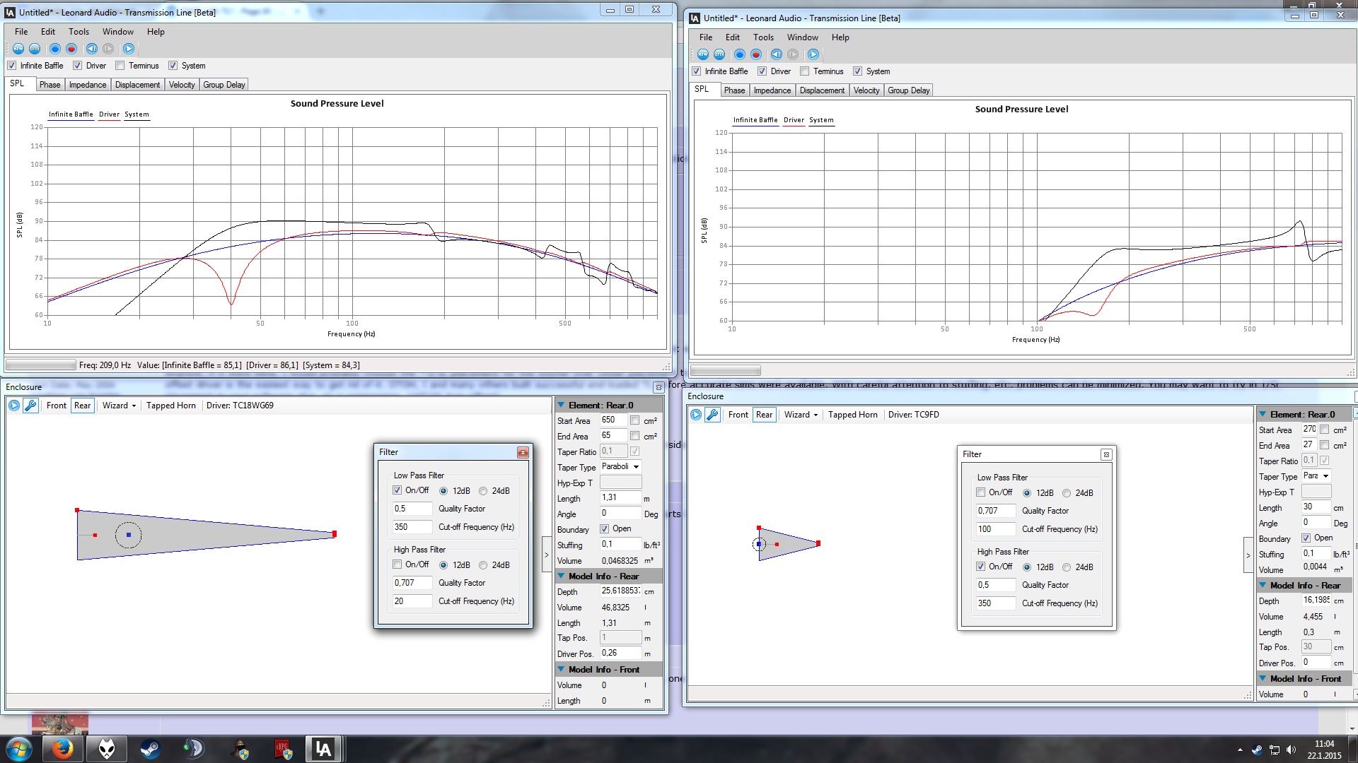

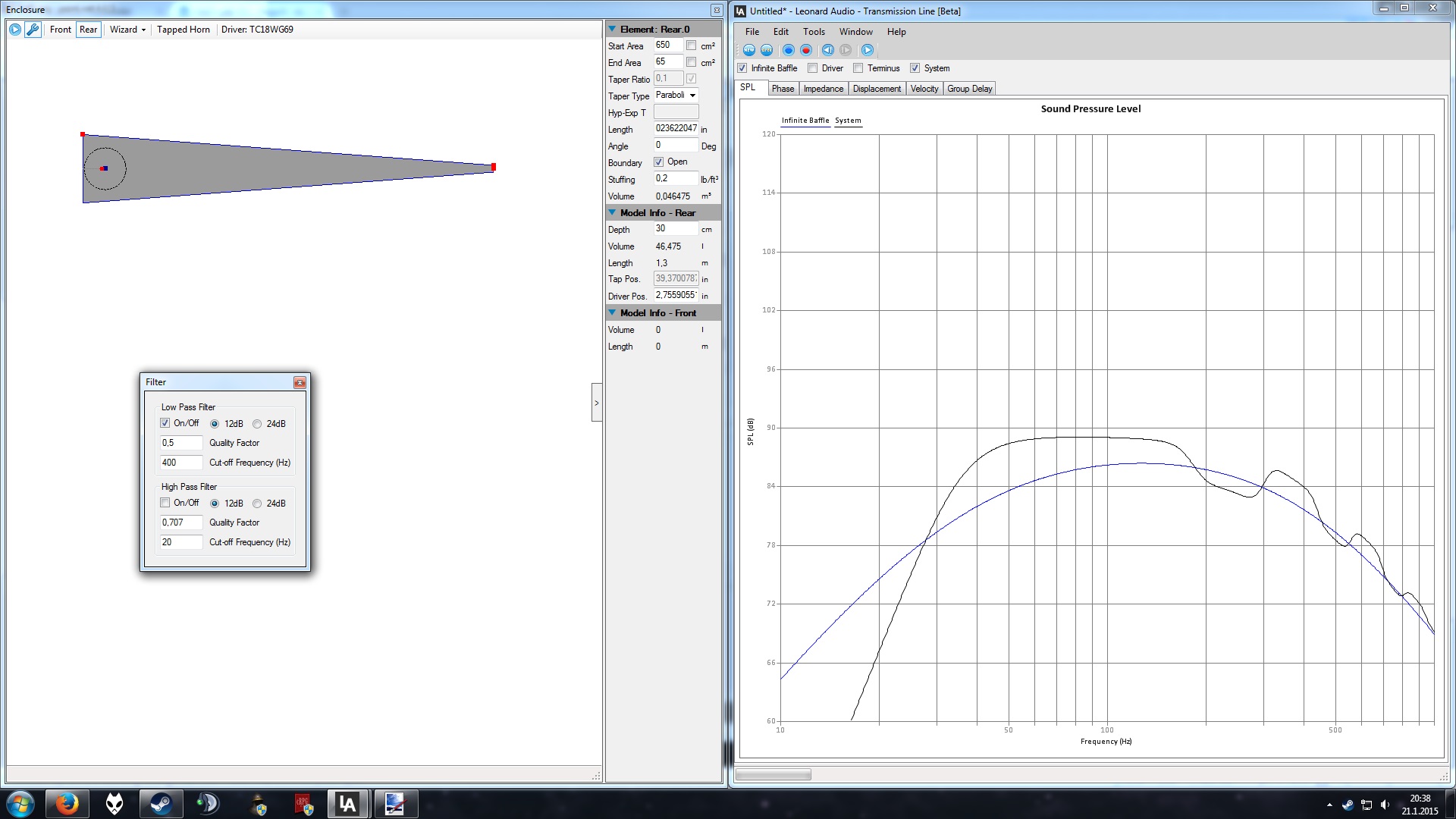

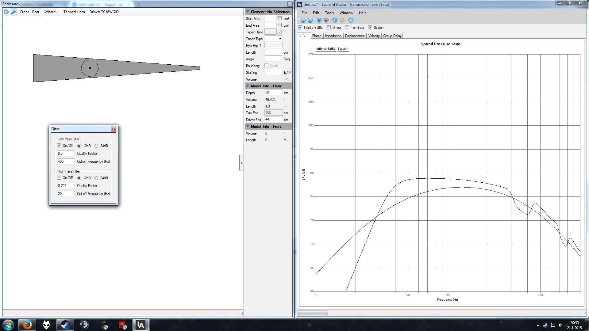

I simulated the 3 options. To my untrained eye, the driver 1/5 down the line would seem best in this application. The 1/3 down the line is too low considering the distance from FR driver unless I lower the XO point.

Seems like I have a choice between rock and a hard place. What would happen if I used two bass drivers, one at 1/3, and one for example in 1/5? I would try to model this, but Leonard Audio software only supports one driver location.
I can model this in Akabak pretty easily with multi drivers. Get me your drawn to scale sketch of the profile and driver locations. If you put the drivers at 1/5 and 1/3 they are quite close together and can be approxinated as dual drivers at the mid point between 1/5 and 1/3. Also, if you provide the dimensions of the short TL for the top as well as cabinet width and driver locations son baffle I can model the whole system response with XO and baffle step and diffraction. Also indicate how far away your back wall is and that reflection will also be included.

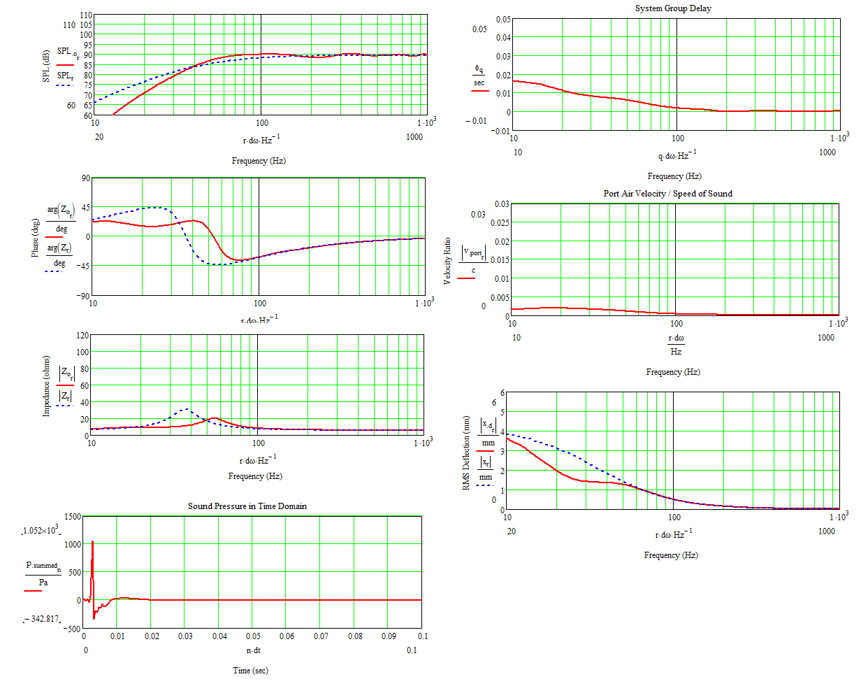

Simulation of FAST TL
Using the geometry of the design from your earlier post: http://i.imgur.com/R6x6e6A.jpg

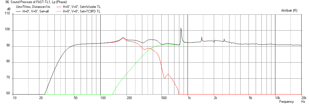

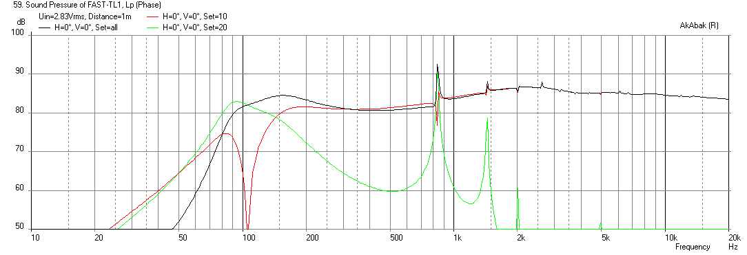

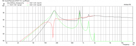

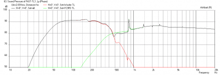

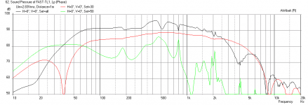

I modeled it in Akabak. The main bass TL is quite good with two drivers - nice sensitivity of 91dB at 2.83v, a smooth response with an f3 of 55Hz and smooth rolloff like a pro audio speaker:

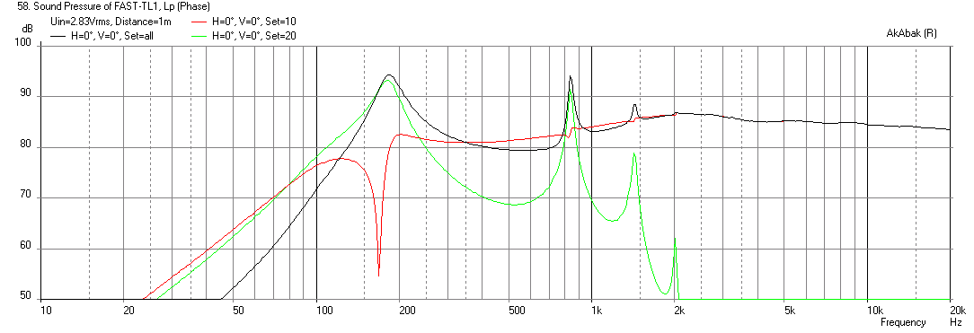

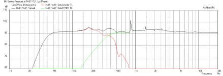

The HF TL however has a pronounced peak with a 10mm terminus, which does not give a very smooth XO:
If we reduced the terminus to 1.3mm, it is much better:

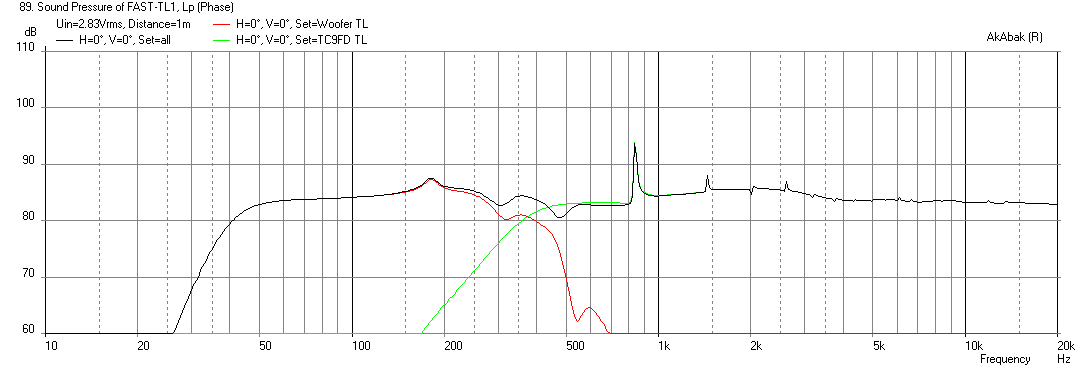

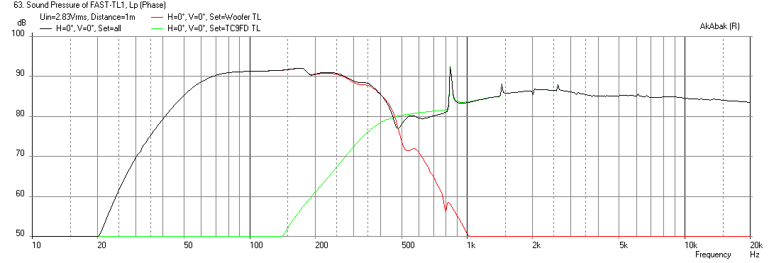

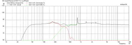

Here is the combined response of the bass TL and the HF TL using a 300Hz -24dB LPF for the bass and a 370Hz -24dB HPF for the top:
As you can see, the sensitivity of the woofers overwhelms the TC9FD, you would need to run it at 4x the voltage to compensate and that is not good. Alternatively, a 91dB sensitive driver like the Faital Pro may work better here.

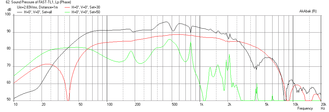

The simpler way is to run the bass TL with only a single driver, the volume has doubled so the tuning will drop lower and the f3 is at 41Hz. The TC9FD now requires 1.6x gain relative to the the woofer, and a BSC circuit using a 0.8mH coil and a 6ohm resistor to level the response:

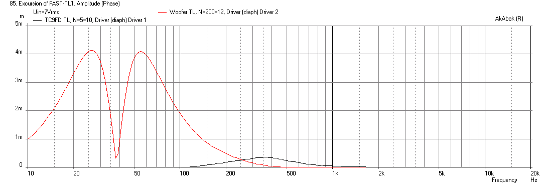

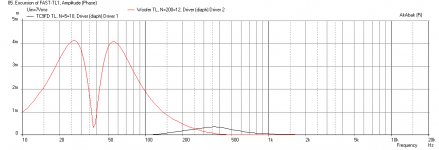

The problem with this driver in a TL like this is that the cone motion control is not very good, as 4 mm of xmax is reached at only 7 volts drive on the woofer - this really limits your max SPL levels:

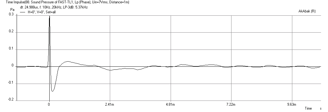

Here is the frequency response at 2.83v drive on the single woofer:
Here is the impulse response, quite nice:
So in summary, I think the major findings are:
1. Use a single woofer if you want get closer to balanced levels with the TC9FD (still needs 1.6x boost)
2. Use a 300Hz -24dB/oct LPF for the woofer and 370Hz -24dB/oct HPF for the fullrange
3. Make the terminus gap on the top TL 1.3mm vs 10mm

1. The maximum SPL isn't really desirable in this build, as my friends lives in an apartment building. Listening will be done at moderate volumes. The thought of using two drivers is a nice one, but ordering the faital pro driver would break the budget set by my friend.
2. Interesting points. As I'm planning on using PLLXO (budget constraints), the maximum would be 2nd order with Q of about 0.5. It's interesting that this is actually cheaper to do as an active build than passive as the big chokes for low-frequency crossover cost a fortune.
3. Good tip on the full range TLs terminus, it's easier to make smaller by just adjusting the angle of the board separating the TLs. Why does it need baffle step though?
What kind of damping did you simulate in these? By default, I was thinking of lining all internal walls with 8mm felt and build up from there if necessary.
EDIT: The shortfall of this Leonard Audio software is that it can only simulate one instance per time. So, had to run two instances to get both drivers along. Here's my take on the 1/5th down the bass TL line for simulation.
